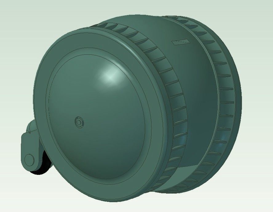

          I found this unbelievable vehicle today after getting lost down a Wikipedia Wormhole (I started with Karman Limit and went via V2 and a whole load of strange WW2 German weapons). It turns out it is real and there is one in a Russian tank museum, although with only 5mm plate it's probably not meant as an attack vehicle, and it's only 1.5 metres in diameter.
          I will be 3D printing one of these!
          http://www.tanks-encyclopedia.com/ww2-german-prototypes/kugelpanzer/
          Took about an hour to draw this up, hardest bit was getting the tail to look about right playing with fillets and dimensions. It's an assembly of 3 parts, body and 2 wheels.

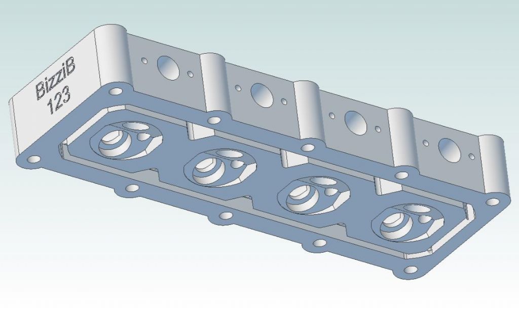

              Made some more progress with my engine design after a short break to let my brain cool down. It's by no means finished but it's coming on slowly and I'm getting in lots of practice with "inserting new planes".
              Cylinder head
              There will be cast iron valve seats shrunk into the head – that's why the valve locations look a bit big.
              Anyone know why I can't re-size the photos in a post anymore. Are they too big?

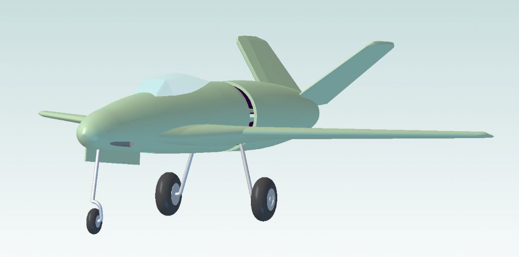

                            #387326
                              Be aware when doing a sweep you have to be very careful that the radius of any bends is greater than the width of the part as if it 'intersects itself' the extrude will fail.
                              The lower section of this nose 'oleo' was done as a sweep after much cursing to to get the path right.
