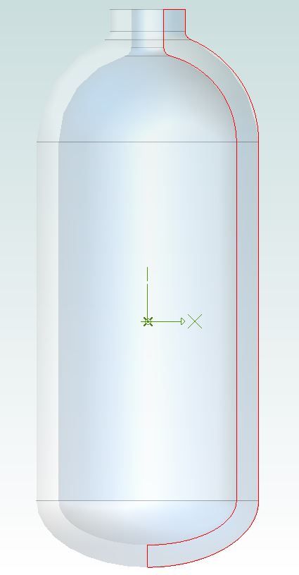

          Posted by Paul Abrams on 07/12/2018 09:56:12:
          I'm trying to put a dome end onto an air cylinder but cannot find the information in the help files. Can you point me in the right direction. I have been trying to adapt the instructions on page 20 of MEW but getting nowhere!
          A written manual or book on the Atom 3D would be really helpful – I know I'm expecting too much but any ideas please!!
          Draw two circles to create the right thickness, use two lines and trim to make a 90-degree segment of the right thickness, then rotate it into a hemisphere.

            If you want a spout or end fitting to the cylinder then drawing a half section and rotating will be the better option

                If you want something other than a pure radius than it will be best to draw a section and then revolve it, something like this where I use circles at the top and elipses at the bottom.

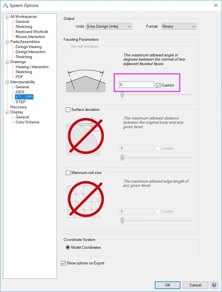

                  STL output from Atom – make sure that Binary rather than ASCII is set as Format the Interoperability options for STL/ZPR (binary file will be a lot smaller). You can additionally adjust any of the 3 Faceting Parameters to balance file size with 'smoothness' of model. You'll probably get away with adjusting Normal Deviation – you have to check the Custom Box to change from the default value.

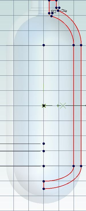

                    If your cylinder has uniform thickness, you can simplify the construction by only sketching the external (half) profile. Revolve that to create a solid, then used Shell command to 'hollow out' the solid and put a hole in the neck.
                    You could make the hole as a separate operation.

                      Thanks Jason and Neil……I think it is two steps forward and one back. I've changed the ASC11 to Binary & the 5% works OK on the faceting. That problem solved.

                      Your drawing of the bottle shape comes from a different starting point than the way I was approaching the problem. I was doing it step by step as per the MEW and Manual instructions. This Atom 3D programme looks very promising and hopefully the MEW course will go further than the four months envisaged. Unfortunately age is not on my side and I need to know it all now!!

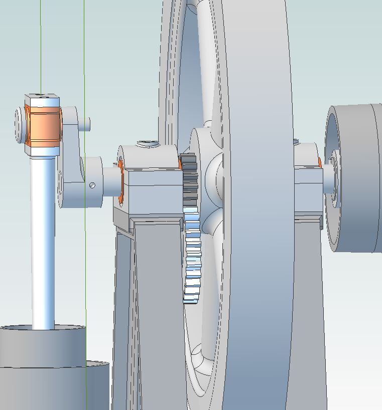

                                            When using gears in an assembly is there a way to have them mesh and revolve as you turn one part? I'm currently drawing up an IC engine and it would be nice if the timing gears would actuate the eccentric that operates the exhaust valve.
                                            Also can a ratchet wheel be assembled so that the pawl will move it one notch at a time?

                                              Not simply, no. There might be some 'dodges' possible to do some of this using hidden parts, but nothing simple.
                                              I'm struggling to remember if I've seen a dodge for reduction gearing. Ratchet, I'm sure I haven't seen.
                                              Some of the guys over on the Alibre forum come up with some sneaky methods – could be worth posing the question there.
