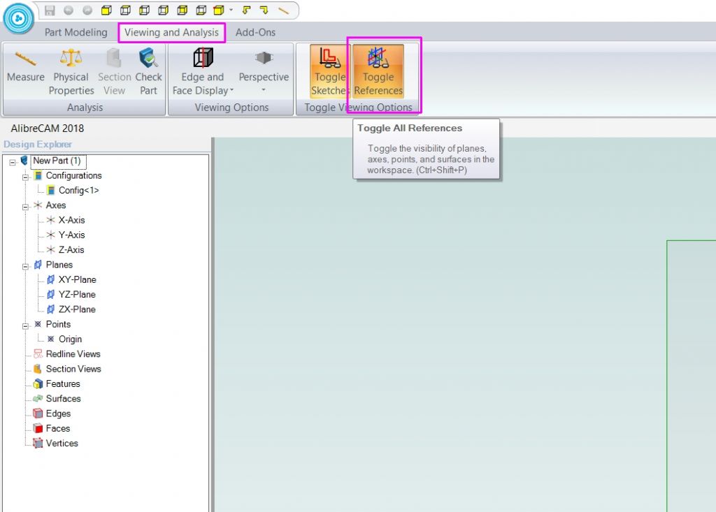

                              I am just starting the base component of the Mini Gauge.When clicking on the blue part icon the work space opens but the three planes do not appear.
                              The XY plane was selected using the design explorer.
                              2D sketch was selected and the circle drawn and sized.
                              2D sketch was deactivated and the circle just drawn disappeared.
                              It would appear that maybe a global setting is incorrect.
                              Can you help please?
                              Thanks
                              Alan
                              #384042
                              David Jupp
                                @davidjupp51506
                                You probably have references toggled off. From Viewing & Analysis tab on Ribbon – click References. See image.

                                John Barber 5
                                  @johnbarber5
                                  Posted by AJS on 05/12/2018 18:24:05:
                                  Just wondering if you might have created a "reference" circle, rather than a "sketch figures" circle.
                                  #384050
                                    No sketch can "disappear" if you don't have it highlighted down the left hand side of the page. But most likely also has Sketches toggle off as that is the one next to the planes toggle.
                                    Edited By JasonB on 05/12/2018 20:10:06

                                    AJS
                                      @ajs
                                      Thank you for your prompt replies gents. Problem solved, as Jason suggested by setting the "sketches toggle"
                                      Now on to the next part with renewed vigour!
