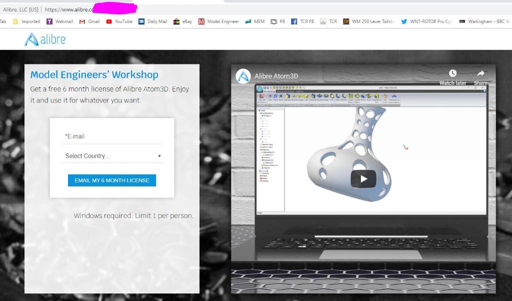

                                  My subscription issue no 274 arrived very late. By the time I was thinking of getting around to trying Alibre issue 275 had arrived!
                                  I cannot get alibre by using the instructions on P46 of issue 274. When I input http://www.alibre.******** it takes me to alibre website but there is no reference to MEW or 6 months trial. I am offered the standard 30 day trial but no other offer.
                                  I have not been given a link to a license key so have got no where at all.
                                  Any advice?

                                        Earny, I'm not sure why you are not seeing the 6 month trial, I have just this minute followed the same link and it comes up fine for me.

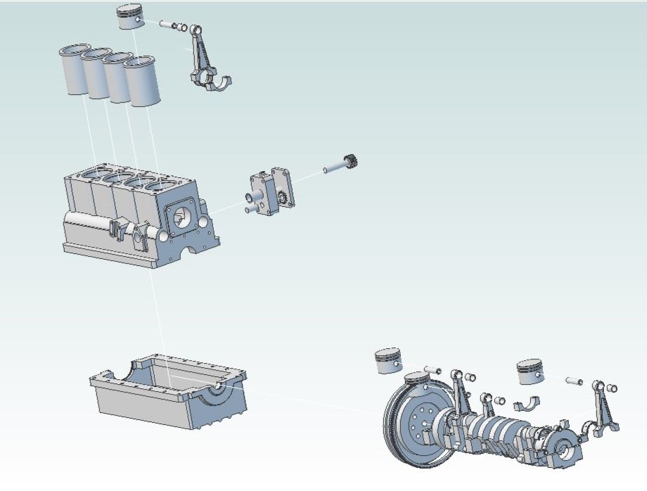

                                          Just by way of experiment and a bit of fun, I tried out the "explode" function on my part-assembled engine design and this was the result:
                                          Exploded engine
                                          I think I need to improve my layout methods! But you get the idea.

                                            If you still are struggling drop me an email – so far the few folks who have emailed me a 'non-working' link have found it works when I send it back to them.
                                            #382720
                                            Spurry
                                              @spurry
                                              Not quite how Google operates, but if the Alibre web address was entered into the search box, the MEW link would never show, although the proper Alibre site could be accessed.
                                              However if the same address was typed directly into the web search box (top left hand corner in I.E.9) I was taken straight to the correct link.
