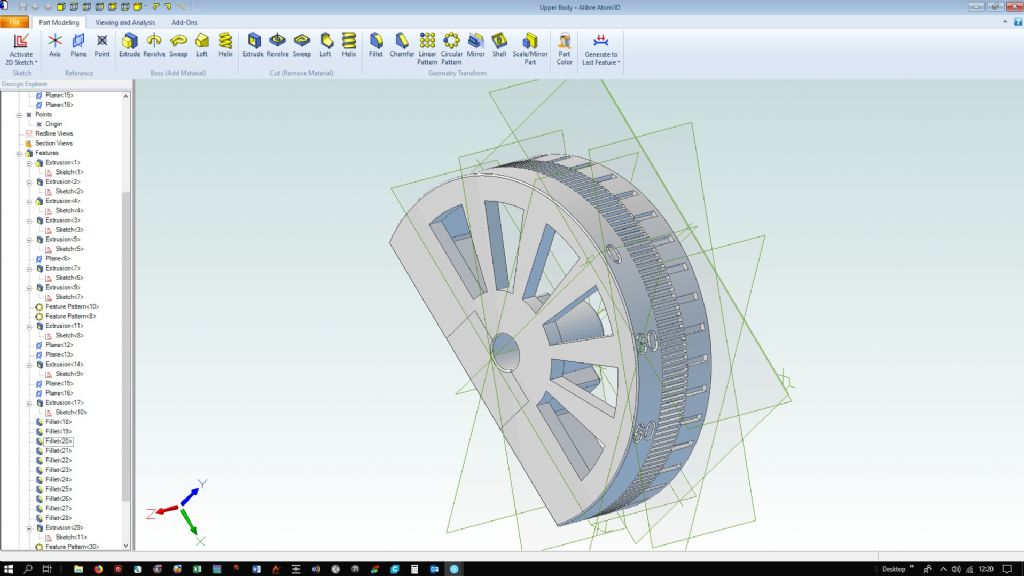

                                  Just a quick example to show how I have used angled planes to put embossed text on a curved surface (the text isn't curved, just a shallow extruded cut). For each text I created a new plane at an angles through the main Z-axis, then a parallel plane at the radius of the curve.
                                  If there's a way of doing this in one step (rotating a plan around an axis not on the plane) please point it out to me!

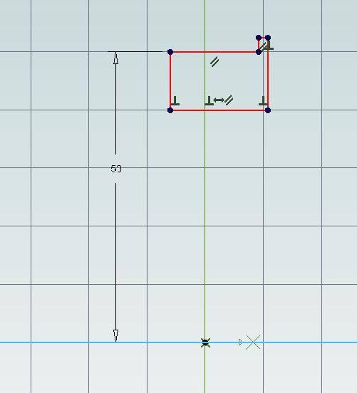

                                      duncan webster 1
                                        @duncanwebster1
                                        Jason
                                        I have the half section of the wheel as wheels section.dwg, so I open new part in alibre, then open wheels section.dwg, and the blue screen with grid as your first screendump disappears and I get a white screen with the drawing.
                                        I've worked out how to do boss revolve with something I drew in Alibre, but I want to import the profile, then position it relative to axis and rotate
                                        Edited By duncan webster on 25/11/2018 13:36:03

                                          David will have to help with this one as like you when I go to open it just opens a DXF or DWG drawing and does not open the drawing as a sketch. I think I used to be able to do it with import.
                                          #382275
                                            Done it, will come back to you after the F1
                                            #382282
                                              So basically use Atom to open the DXF or DWG file, check units and that both boxes are ticked.
                                              Once you have the drawing up on screen select Activate 2D sketch which will put the red box around the drawing, then select all which will turn the lines blue (shift and click for individual lines) and then Copy. minimise that screen.
                                              Open up a new part and activate 2D sketch followed by selecting the plane, paste the previously copied item which gives you your new sketch, deactivate sketch.
                                              Select revolve and your axis.
                                              #382285

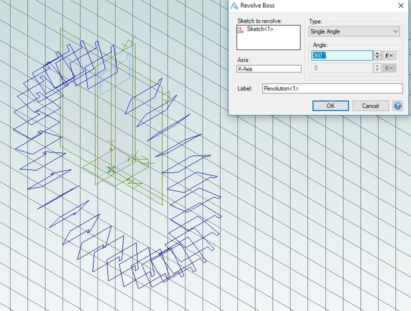

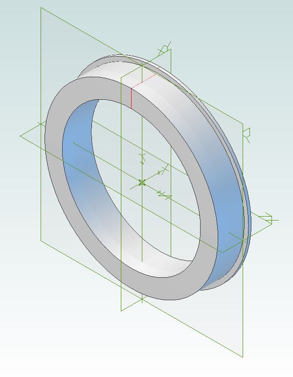

                                                  duncan webster 1
                                                    @duncanwebster1
                                                    Success I think. Followed Jason's instructions and got the section into a sketch, but it is complaining that it is position/magnitude undefined, even tho I've put it in the correct position referred to the origin
                                                    It did the revolve bit OK, but are there hidden difficulties?
                                                    If not I'll continue and add the balance weights.
                                                    Must admit I'm enjoying this, even if I do keep asking dumb questions
