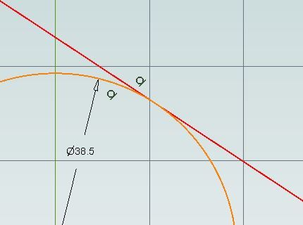

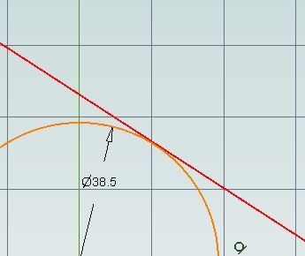

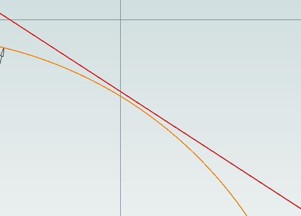

                                #378086
                                Rod Ashton
                                  @rodashton53132
                                  Trying the demo version. Quite neat.
                                  Confused a little by the "trim" command. Drew a circle with two angled tangent lines attached. Then tried to trim out the inner unwanted portion of the circle from the line tangents. But it would only select and delete the whole circle. What is the procedure please.
                                  Hope I am not premature with queries?
                                  #378088
                                    Rod, how did you do the two tangental lines? For the trim to work they must actually be tangental not just look like it on the screen.
                                    1 option if you want the line vertical or horizontal starting at the circles ctr line is to draw your circle then select the line tool, now hover your cursor near circle where you want the line to start and you will see the little image of a line near your cursor arrow change to a line and inverted triangle as you move around to 0, 90, 180 & 270 deg a red guide line will also appear now click mouse to start line. As you start drawing your line now it will automatically snap to the circle and be tangental when vertical or horizontal. You can tell if it is by a black dot where the line joins the circle.
                                    Another method is to draw a line approx where you want it and then go upto the "constraints" box along the top. one icon there is a circle with a tangental line, hover cursor over that and it will tell you what it does. You then click that icon and follow what it says bottom left – select first figure, I usually select the circle then select second figure which is your line it will then move to be tangental to the circle
                                    Easier done that said
                                    EDIT rough and ready video, my version is slightly different but you have the same functions
                                    Edited By JasonB on 28/10/2018 14:44:20
                                    #378093
                                    Rod Ashton
                                      @rodashton53132
                                      Jason – I actually tried it both ways.( Incidentally the selection sequence is worth a observing)
                                      So if left with a circle and the two tangential lines to trim, I would usually accept a highlighted cutout suggestion, or select my cutting entities and then the portion to remove.
                                      Could not find a way to do it. At least by my accustomed methods?
                                      #378094
                                      David Jupp
                                        @davidjupp51506
                                        Rod – though produced for Alibre Design, rather than Atom3D, this video shows general usage of the trim tool. It might help.
                                        Jason is correct – the lines have to either cross the circle, or be truly tangent to it for the trim to work, alternatively the end nodes of the lines could be set coincident with the circle.
                                        #378104
                                          Rod, can you post a screen shot of your circle and two lines, we may be able to spot what is stopping you from being able to trim. Zooming right in can also show up if a line that looks tangental is actually just missing the circle.
                                          Normal working size
                                          Zoomed in and it misses
                                          What it should look like, the little tangent icon comes up when the two meet correctly
                                          Edited By JasonB on 28/10/2018 15:47:59
                                          #378108
                                          Rod Ashton
                                            @rodashton53132
                                            Well I just redrew it to send you a screenshot and the trim function worked as I would expect. Must have drawn it in a more acceptable way. It was the first time I had used the programme. Apologies for wasting your time.
                                            Still playing
                                            #378110
