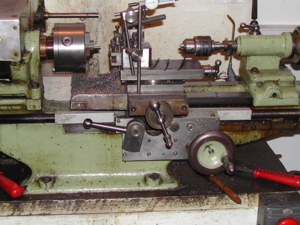

              Ady1
                @ady1
                A bit of plastic pipe works a treat for me

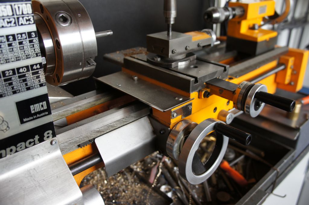

                      Johan van Zanten
                        @johanvanzanten
                        What about this?Swarf guard

                        Ady1
                          @ady1
                          My first bit I split it along its length and slipped it over to see how it went
                          second time around I removed the leadscrew completely and fitted an unsplit pipe which was much nicer and a job for life kinda thing
                          Slipped being a relative term, it's tough plastic water/gas pipe and returned to its original shape once fitted… after 20 mins of effort on my part
                          Get your pipe length right first time, not the sort of job you want to do often, for me it's been very useful so I made the effort of removing the leadscrew, I'm a messy user and the swarf can really pile up(observe those lovely clean lathes in previous posts, then mine)
                          I never bothered attaching it to the saddle, just got into the habit of pushing it back with a finger, hopper has a nice system, (a proper system)

                          Another JohnS
                            @anotherjohns
                            Posted by Johan van Zanten on 02/09/2015 09:55:39:
                            John – beautifully kept lathe, but a bit of a warning – I had a chip tray on my Compact-8, then purchased a collet holder, THEN did some power-feed when turning. The chip tray hit the headstock, and I got to figure out how to replace the aluminium shear pins!
                            Looks like you have thought of that, because yours is not too long, but others might heed the warning…

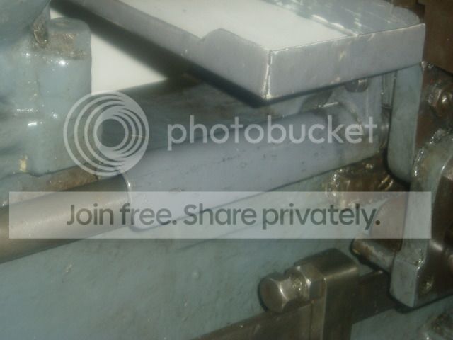

                              Steve Papworth
                                @stevepapworth83993
                                Seeing the picture of Ady1's Drummond flat bed, I thought I'd share a picture of mine.
                                When I made the new apron (which includes a 2:1 gearing so the saddle is more controllable with the wheel, and the saddle moves the "right" way), I took the opportunity of adding lead-screw guards, as shown. Because the new apron is made from steel flats, there is a nice flat surface at the top – perfect for attaching the guards, made from folded aluminium.
                                Edited By Steve Papworth on 02/09/2015 15:24:43
