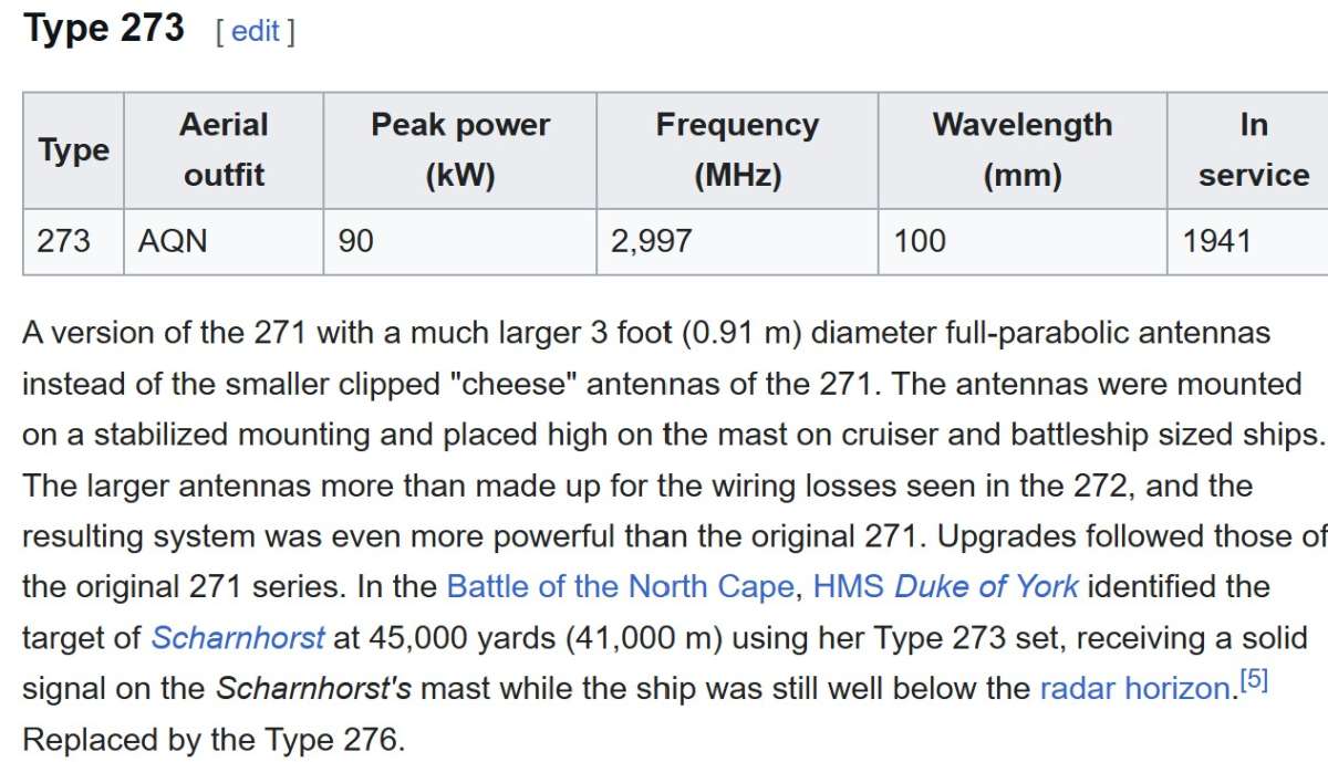

                                                  #783737
                                                  John Haine
                                                    @johnhaine32865
                                                    Wikipedia has an excellent article on RN radar from which it seems that the Duke of York had this one fitted:
                                                    type273
                                                    The 271 it replaced had two antennas so the implication is that this set had 2 x 1 metre antennas up the mast, one Tx and one Rx.  It operated at ~3 GHz so either a largish waveguide or a large diameter coax cable would be needed for low loss assuming that the Tx/Rx were not in the “scanner”.  From the high peak power and frequency it must have used a magnetron which was very new at this stage (1943).  Quite a lot of weight and windage to put on a ship’s mast.  Though the ship’s hull and weaponry are heavy, the guns and armour need to be above the waterline and affect the stability.  Weight higher up has a disproportionate effect on stability as its moment of inertia increases as a square law.
                                                    There’s a good book on WW2 German radar – Instruments of Darkness by Alfred Price.  Apparently they had an excellent UHF radar air defence chain working in France, much higher tech than the UK CH system.  But it was run by the Wehrmacht, and all the information on attacking aircraft was fed to Berlin to be shared with the Luftwaffe and might eventually reach the defence forces probably after the planes were gone.  By contrast the CH station operators were in direct contact with the RAF plotting rooms that dispatched the fighters.  One could imagine that similar organisational issues could afflict the way that radar info was used on German ships.
