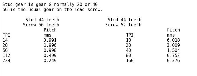

                      The alternative is to work out conversion gears that have an acceptable level of accuracy. The ones that come with the lathe may be good enough so why not work out just how close they are.
                      The usual attitude to this area with novice Boxford users is that they want a 127 gear. Point out that the errors can be small when conversion sets are used and that lathes do not cut that accurate a thread anyway and they just say well it would be more accurate if I had the 127. The differences in real terms can be so small that it really doesn't matter.
                      My lathe has an imperial gearbox. This is what I need to do to cut accurate metric threads
                      Unlike Myford's I had to come up with this myself. smiley When ever I post it I always say if used do check what it actually cuts. I have used less close approximations that came from the same spread sheet so all should be ok.
                      The one I have used a couple of times as well is this one
                      In real terms it's plenty good enough. Boxford kindly supply one of the gears needed as packing. Who ever bought my lathe also bought the 127 gear. It's not much of an advantage on one with a gear box.

                              You should be able to cut accurate enough metric threads with your existing change wheels. There is a simple online calculator here
                              One or two additional gears might be needed if you need better accuracy.
                              "As for threading; I found that certain camera lenses and filters require precision screwcutting of a very fine thread on a large diameter of typically 50mm+ lens. Dies are not (readily) available in the required sizes. Sometimes the lens is worth more than the mini-lathe (such as an IR quadrature) so 'near enough' is not good enough."
                              In general filters etc., have rather short threads so a 1% error in pitch is not important.

                                  Yes, that will give sub 1% pitch errors for metric threads on an imperial lathe. Just remember to keep the half nut engaged and use reverse between each cut.

                                          0.15% error to be precise

                                                  I had assumed that the 63 wheel would be used in place of a 127 wheel (with a factor of 2 somewhere else in the train) so 127/126 = 1.00794. Just wondering if there is a clever trick to get your 0.15% not that I have ever needed better than 1% pitch error.
