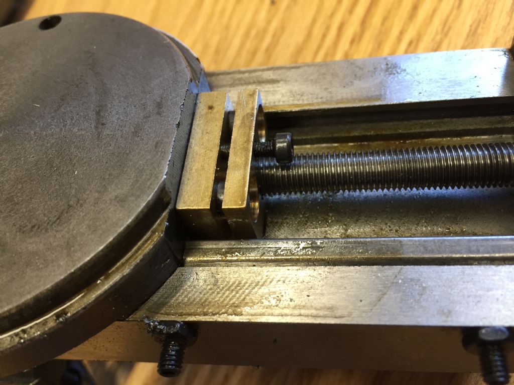

      Sounds like the arrangement on my old mini-lathe. May not be quite as simple as the two rear screws being locking screws, which is exactly what I thought until I tried adjusting them!
      Whether by design or crude manufacture, on mine the four screws worked in concert. As expected the side screws control the major right/left angle. But tightening the rear screws also moved the centre slightly, not only right/left but up/down as well. The effect was to make the tailstock describe a small figure of eight movement as the 4 screws were tightened. I found it a fiddle to get spot on. One of those, nearly right, better, better, better, bugger start again jobs!
      Possible that the 8 movement was due to poor finish of the rear block, rather than a deliberate fine adjustment feature. However, as the tailstock was spot on from the factory, they knew how to adjust it in China, as did I after 10 minutes of industrial language. Decided in the end that the tailstock adjustment is a basic cost-saving design that substitutes operator time for ease of use.
      Interested to know if you get the same result.

        Hi Dave,
        Thanks for the advice, it did cross my mind that the rear screws could be for something other than locking screws. I found it odd that the two screws are not equi spaced off the tailstock centre but the pair are offset to one side.
        I will wait until I turn a centre in the chuck and have a good play then. I can see how the rear screw nearest the tailstock edge could pivot the tailstock around the underside fixing screw.
        Will let you know how I get on.

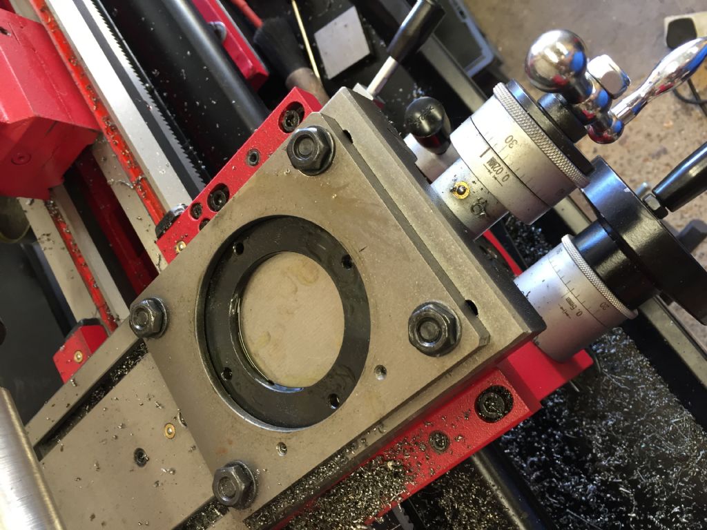

                              Just a heads up about the power feed handle for the saddle and cross slide feed. It is VERY EASY to go straight through the neutral position and straight into the cross slide power feed position when disengaging the saddle power feed as I have found out AGAIN. This happened even though I had practised the gentle movement required and knew the possibilities !!! Fortunately it didn't cause too much damage to the work piece as the lathe stalled as the tool dug in and I was able to get the E. Stop hit.

                                I was looking at setting the Sieg lathe up to cut a 12 tpi thread and decided to use the method I was taught at school and to angle the compound slide to half the included angle of the thread and wind on all the cuts from there. As this is a Whitworth form thread that gives and angle of 27.5 degrees. To achieve that the compound slide has to be rotated clockwise (looking down on it) 62.5 degrees.
                                Two problems immediately arose. One- The slide would only rotate about 45 degrees and then something was stopping it. On investigation I found that the head of the backlash adjustment screw under the compound was catching on one of the bolts seen in the photo below.
                                The answer was to remove the screw and gently file about 1.5 mm from the thread. This leaves ample thread for further adjustment and gets the screw to just clear the bolt head. Below the offending backlash adjusting screw.
                                Problem Two- Once you rotate the compound round to about 45 degrees you can no longer see the witness mark against which the angle is usually set as it is now hidden under the compound! What is needed is a second witness mark round to the left of the compound against which the angel can be set. Question is what is the best way of making the new mark, maybe a centre punch mark or a scribed line of some sort, if that how please ?
                                Edited By Nige on 30/06/2018 19:59:40
