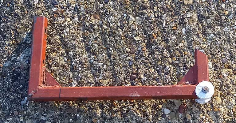

            My fairly recently aquired ML7 came on an original Myford stand that had been fitted with casters. It also came with a small "speed jack" and two blocks. The jack is 1" square tube formed in a unequal U with two small wheels at the corner and a notch in the end of the short arm. It fits under the end of the stand from the front. The bottom edge of the stand end panel fits in the nottch and lifts it enough to get the block under that side front to rear. Lower onto block and repeat for other side.
            I'd like to claim it was my idea but it was the previous keeper of the lathe.

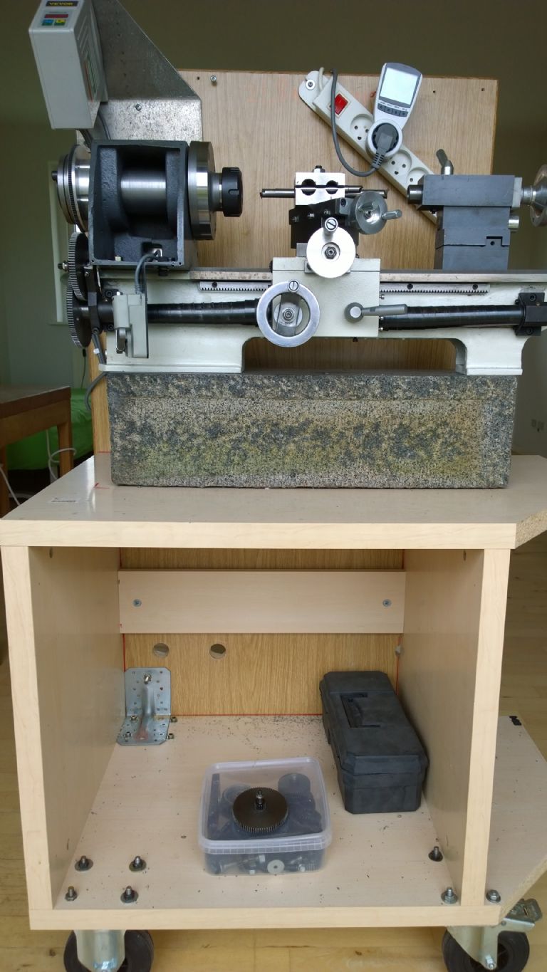

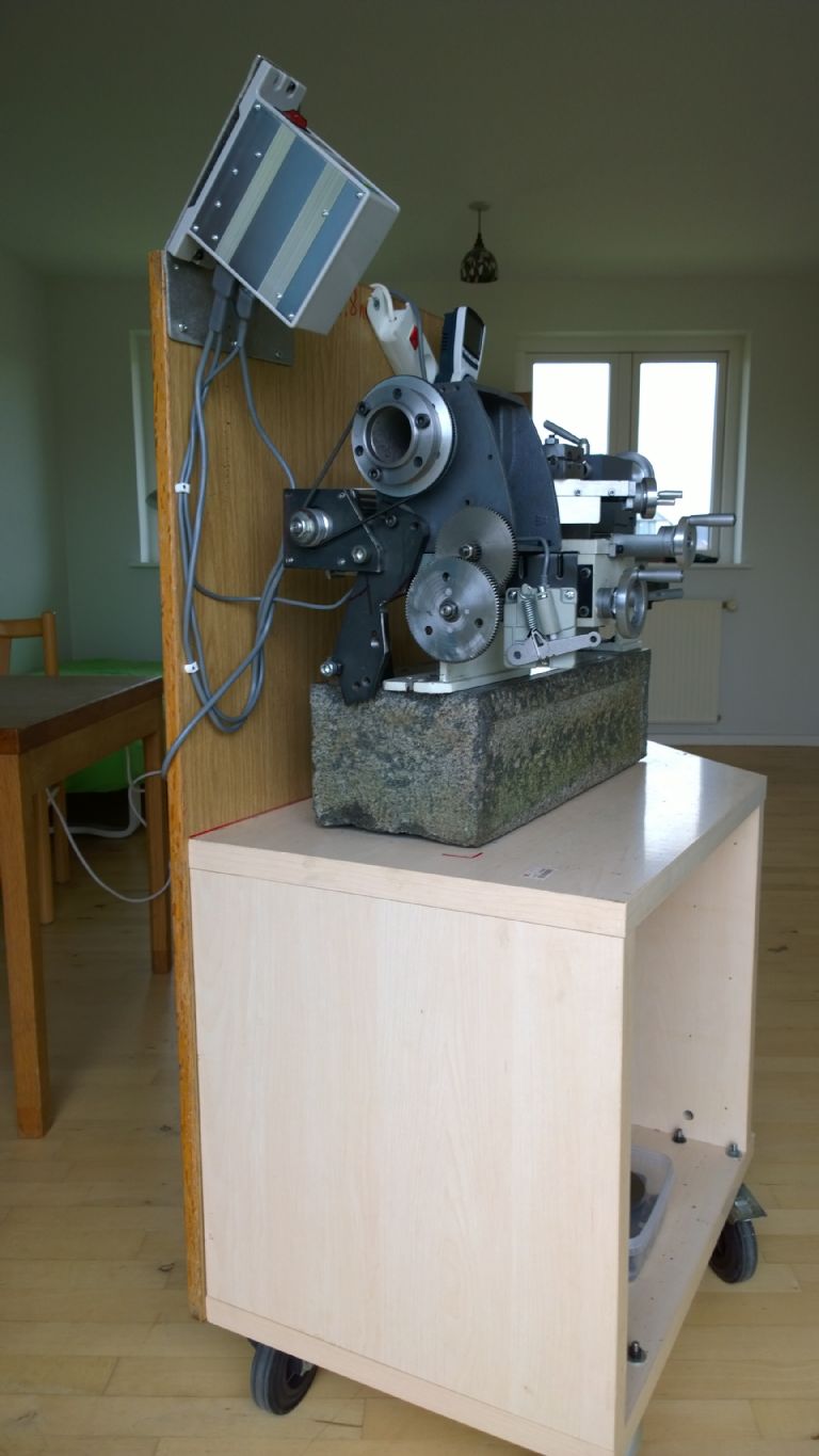

                              My latest inhumane lathe experiment is a castored and aligned mixture of a 180*300 and a 210*400 lathe with a homemade 48mm hole spindle.
                              Target was to make a potent lathe where all parts can be handled by a reasonably fit 77 year old.The stone is a borderline case

                                That's quite a slab of granite there Niels. I am sure you don't get much bed twist there. Could be a bit top heavy though? 48mm through hole sounds pretty handy. i wish I could do that on my Myford.

                                  The 5£ second hand shop under-thing is 550mm wide and can easily pass a 770mm dor opening.
                                  It has not felt dangerous and unstable ,but my very nice appartment has no dor steps.

                                    Niels Abildgaard:
                                    Out of curiosity:
                                    What was the original use of the second-hand stone?
                                    What is the 21.8mm dimension?
                                    More power to your inhumanity to lathes!
                                    #630618
                                    Niels Abildgaard
                                      @nielsabildgaard33719
                                      Hello ega
                                      Stone is one of a pair that worshipped a central,bigger tombstone with doves and angels.
                                      I pass the unused twin every day with dog.
                                      Cost was 1 kg instantcoffee and some chokolate.
                                      21.8mm is measure from top of compound slide to centreline within plus minus 0.01mm.
