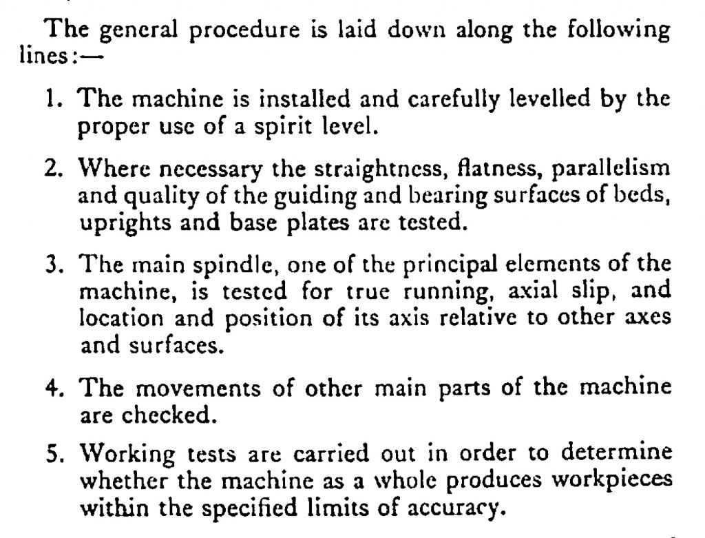

                                    May I suggest that page25 of Schlesinger’s masterwork should be required reading for all participants in the next discussion ?
                                    Here’s an extract, in a handy form to keep:
                                    We can then all jump-in at one of five places, and opine as we see fit.

                                      I'm not against old-chestnuts coming up repeatedly because it's in the nature of an internet forum – a bunch of like-minded folk chat in an electronic club. What we typed yesterday, let alone last month, is easily missed by anyone other than regulars, sadly regular readers are bored by repetition. Taking the rough with the smooth, I put up with that, seeing the forum as a way of helping others, even though the same subjects come up over and over again.
                                      The forum is brilliant at answering questions but it's a poor look-up reference, even when the user has super Google-foo skills! Wikipedia is a much better reference, but it doesn't allow questions. If Model Engineers were more organised, we would get the best of both worlds by producing peer-reviewed Wikipedia articles on subjects like levelling and lathe alignment, with links to this forum and others, where people could go for Q&A help.
                                      Unfortunately most of what I know about machining is self-taught. In the absence of Model Engineering information on the web, I read, misread, and misunderstand my random collection of engineering books. Many, many times, I've only understood what a book meant after the point was discussed on the forum. Thanks everyone!
                                      PS on the subject of casters, I wouldn't unless mobility was really important.  The problem is they reduce rigidity – the lathe will vibrate much more on casters than if it were bolted down on a concrete floor.   But engineering is all about compromise.  I move my lathe with an engine crane, and it's a right pain.  If I had to move it frequently casters, with brakes, and even better jack-stands, would be fitted!

                                          Posted by Michael Gilligan on 20/01/2023 11:22:06:
                                          Schlesinger's work is for machine tool manufacturers, not home workshops. Makes a simple job harder for the average bodger.

                                              Posted by Hopper on 20/01/2023 21:38:08:
                                              Page25 is about refurbishment

                                                  What on earth is Schlesinger doing using a spirit level? I thought that was verboten!
                                                  I find a pair of winding sticks ( as taught by my woodworking instructor many decades ago.) to be much more satisfactory. For our purposes these can be as simple as two good quality rulers.
                                                  In use, set one on edge across the lathe bed at each end. Sight along the lathe bed and any twist will become immediately apparent and can be adjusted out. This method is remarkably accurate ( assuming your sight is OK ) and It doesn't matter whether the lathe is sloping end for end or front to back. This technique will still work.
                                                  Pero
