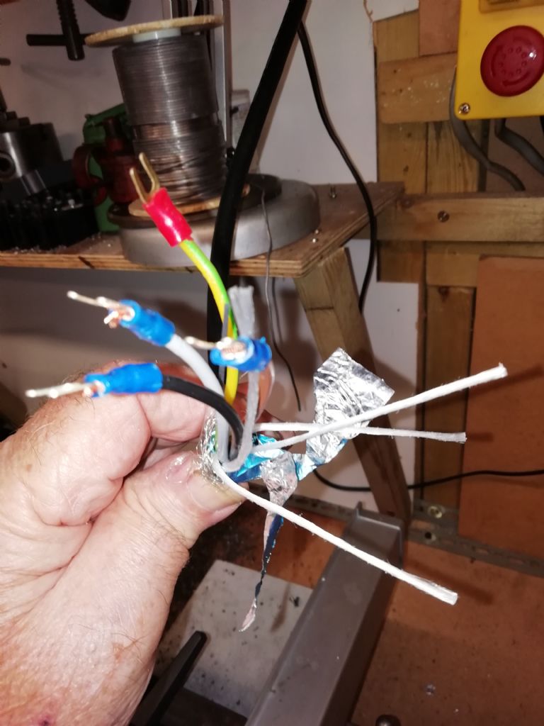

                          As per Robert's request via pm this is the cable sent by Inverter Drive which we think is the wrong cable.
                          Regards
                          Roger

                            That is just standard screened 3 core + earth 3 phase screened cable. It's not the VFD special triple earth shown here:
                            https://inverterdrive.com/group/AC-Motor-Power-Cables/3-Phase-symmetrical-shielded-EMC-motor-cable-2m/
                            If that is what you ordered you need to have a word with the supplier. They might have been given the wrong cable.
                            Robert.

                              Just sent an email with a photo of the cable, I wait with interest to see what their reply is and how fast they reply! thinking

                                Inverterdrive got back to me at 9:45 am and agreed it's the wrong cable, seems their supplier sent the wrong reel and my cut was the first off! They are sending a replacement overnight for me, first rate service in my eyes.
                                The filter from Robert arrived this morning with an included 'donut' as well so I'm praying for a stormy wet day so that I can argue for having a day in the workshop.
