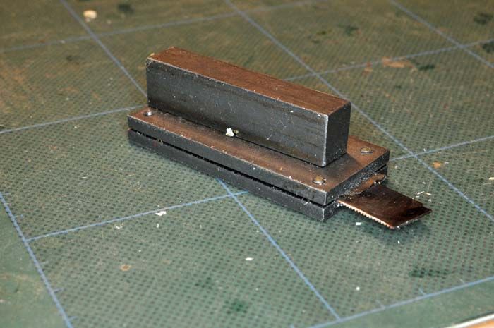

        I read somewhere that you can make lathe tools from bandsaw and hacksaw blades – in fact anything that is HSS.
        I'm making very small items often requiring very narrow round grooves in 4mm round rod and parting off lengths of 6mm. Standard lathe tools seem a little large for these particular needs – my parting tool cuts a groove nearly as wide as the item I am making.
        So is it feasible to make grooving and parting tools from HSS hacksaw and/or bandsaw blades and if so, any advice as to how to sharpen these.
        Or would you recommend using files (rat-tail files) held vertically (somehow) in the tool post such that the file acts tangentially against the rotating rod for creating the grooves. A short length of file (20mm say) could be easily supported in a clamp construction that fits into the tool post.

              Certainly you can use the steel from hacksaw and other blades but be careful no to overheat them when grinding owing to the thin section. If you do overheat the blade you can retemper but that is more hassle. You will also have to devise a way of holding them.
              You might be better off starting with an HSS parting tool in its holder that you grind thinner just at the end for 2-3 mm to keep maximum strength and ridgidity.
              Possibly you could mount a piece of mild steel in the toolholder, drill for the workpiece to go through it, then make a saw cut through it at the target groove and parting line. Then use a hacksaw in its frame to do the groove and cut while rotating the workpiece thus using all of the available cutting points.

                  I have made parting tools from standard hacksaw blades. Grind off the teeth so you don't damage your holder. I put some top rake on, abut 7 degrees, and relieve the front. The blades are not stiff, so take it very easy!

                    Hi Colin,
                    Here is another hacksaw blade grooving and parting tool:
                    http://mikesworkshop.weebly.com/hacksaw-blade-holder.html
                    Mike

                      Len Mason in his book "Using the Small Lathe" gives a sketch of such a tool for the very purpose you require.
                      I have tried it, and failed. I suspect because my hacksaw blade was not suitable – my so-called cutting corner turned into a nice smooth curve almost before it touched the metal.
                      What I have done is to take Mason's idea and use it with an old 4" x 1/8" file. The 1/8" or 3.2mm width is actually too wide for my lathe to handle easily so I ground it down to about 1.8mm and this works extremely well up to about 18-20mm diameter parting off. I do use plenty of cutting fluid and a heavy continuous cut.
                      I did originally have a 1.6mm wide parting off tool which worked well – until I became too ambitious that was.
                      So yes, narrow homemade parting off tools can be made and will work satisfactorily provide one takes the requisite amount of care.
                      Have a go – what can you lose?

                            I've had success with a Mason style blade holder. As Peter infers, you do have to use a solid HSS blade not a bi-metal or flexi. I've used this one for making piston ring grooves for my i.c. engines.
                            As you can perhaps see, I managed to grind a bit of relief so that the blade tapers towards the base.
