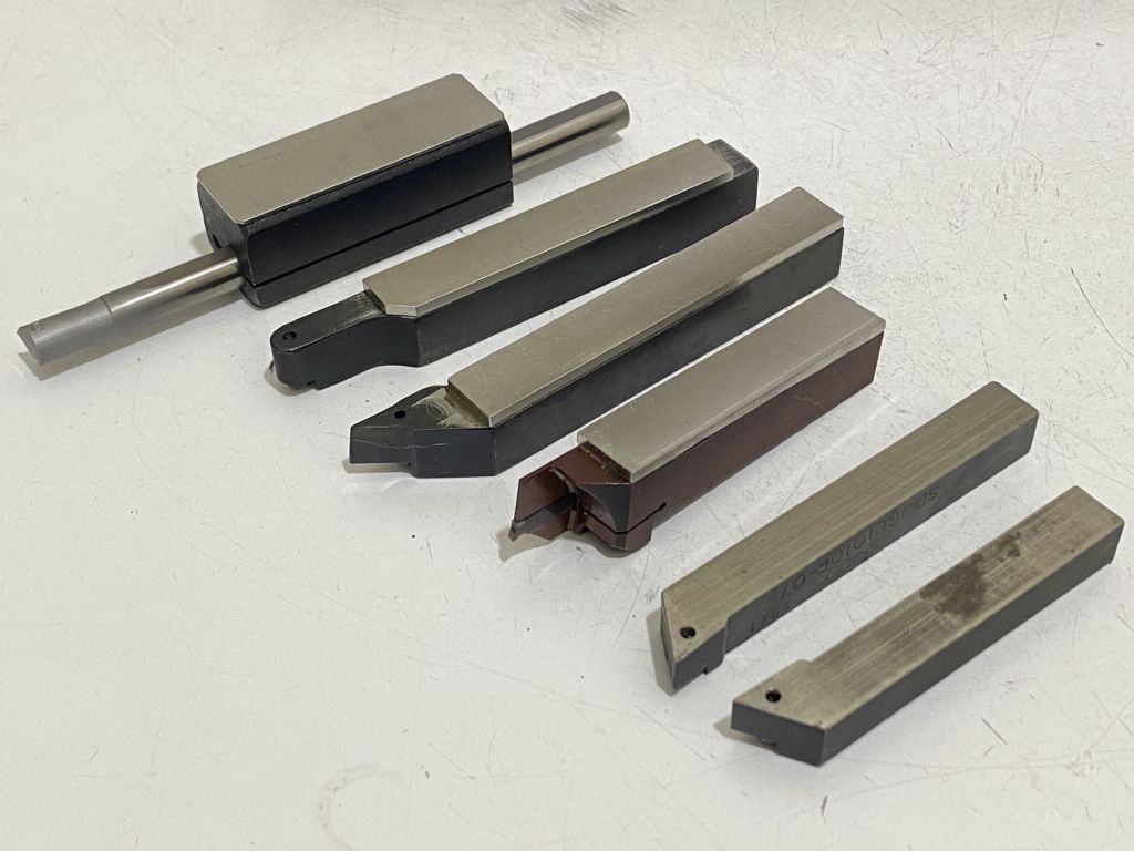

                                              Shims ? I don't have any because I use carbide inserts only. The bottom of each tool bar is milled to make the tip of the insert line up with the center of rotation of the spindle. If the tool bar is too thin, a steel plate will need be epoxied to the bottom before machining. Once done, there is no need for any re-centering in future use. Just mount the tool and start cutting. Here are some of my tool bars ( bottoms facing up ) :
                                              centering tool bars
