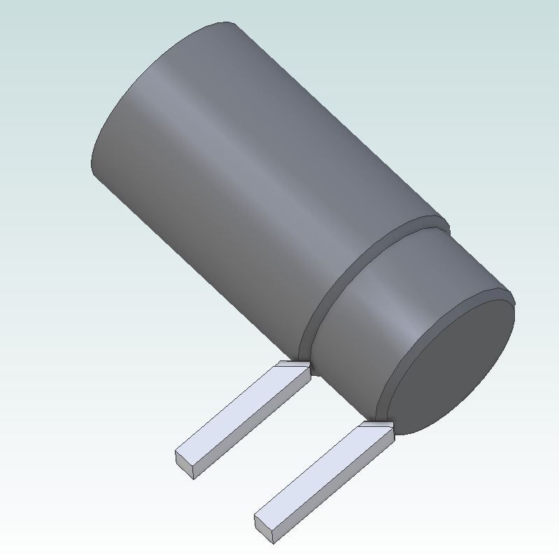

                As the saying goes it's not the tool that you have but what you do with it!
                Sketch shows tool No4 being used to both take roughing cuts along the workpiece and also chamfering the corner

                          I do believe Dave (silly old whatsit) has got his left and right hands mixed up as the cranked RH tool you have is as shown in yesterdays sketch best suited to turning down the diameter of work and not facing.
                          If it were an insert tool then the geometry of the insert will allow a RH tool to both turn and face without altering the position of the tool.
