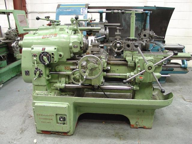

                            Capstan lathe has the sliding bit on the bed.
                            Turret lathe has the sliding bit on a separate self contained turret.
                            Edited By John Stevenson on 25/08/2016 00:01:41
                            #252142
                            Clive Foster
                              @clivefoster55965
                              Thats interesting. My copy of Lathework published by Newnes, revised edition 1943, says the opposite viz turret slides on the bed, capstan has short slides on a separate mount. Relavent section shows pictures of a Ward no 13 turret lathe clearly showing the turret unit slides directly on the bed and a Herbert 2S capstan lathe showing that the slides are on a separate carrier fixed to the bed. Seems to agree with other books I have but that was the easiest one to look things up in. Skinny at only 140 odd pages.
                              Personally I'd have called both machines in your pictures capstan lathes but I never had owt to do with production work so all academic to me.
                              Clive.
