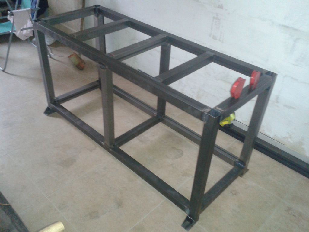

        Hopper
          @hopper
          Railway track? That might be overkill but if it's what you have and you have the time and machinery to do it, it certainly will make a solid bench!
          Mine is made from 1-1/2" steel "angle iron" legs and frame with ladder-style cross members on the top where the lathe feet bolt down, topped with a sheet of 1/4" steel plate all stitch welded together and bolted to the concrete floor. It's plenty solid enough.

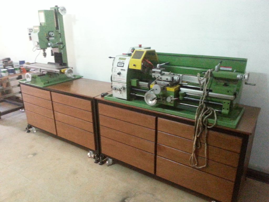

          ChrisB
            @chrisb35596
            I would go for a bench rather than a stand. If well constructed and the lathe is bolted to the frame itself it's plenty rigid. The added storage is a big bonus. I also put the bench on castors and added levelling pads so if I need to move the lathe it's super easy.

            Thor 🇳🇴
              @thor
              I used 50mm square section steel tube to make a stand for my 290 lathe. A friend with welding equipment welded the pieces together. I made it so the lathe could be adjusted to turn parallel, it has worked well for a decade.

                    #603350
                    ChrisB
                      @chrisb35596
                      Posted by Howard Lewis on 28/06/2022 09:19:42:
                      I am wary of mounting benches on castors, since what has the lathe without twist in one place may not do so in another, if the bench is not sufficiently rigid.
                      Howard
                      Posted by not done it yet on 28/06/2022 08:07:07:
                      Bench, to me, means a very much fixed location. Whereas a stand can usually be moved, if required. Entirely your choice, really. Nothing much wrong with either as long as whatever you decide on is (more than) adequate for the job.
                      Castors will solve the fixed location issue, and levelling jack feet will give you the required rigidity and ability to level the bench, it is possible to have both. The added benefit of a bench/cabinet, is storage gained for all the lathe tooling.
