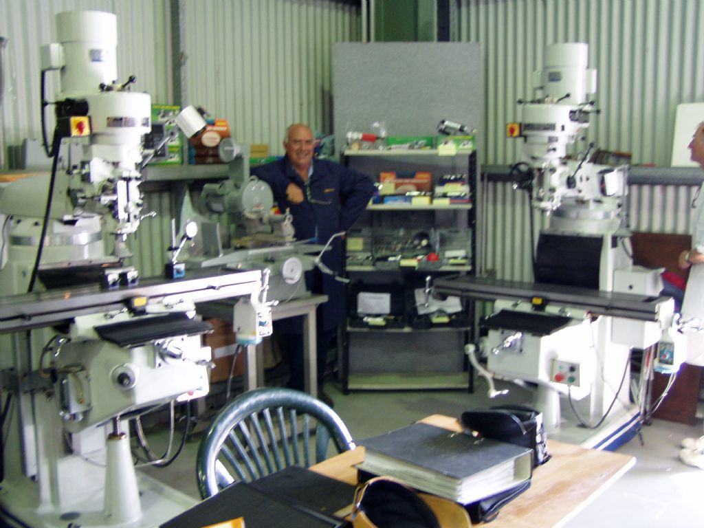

                    Later I will post some pictures.

                          I am not talking about your lathe which I have never seen so how about showing me, post a picture.
                          I have been to many model engineer clubs here in Australia and you have old men hanging on to their old machines because they have not kept up with the new equipment and are defending their lathes because they can not afford a new one and are resistant to change.
                          I have been a machinery importer for a while and some of the new equipment is very good.
                          Have a look at my Album.
