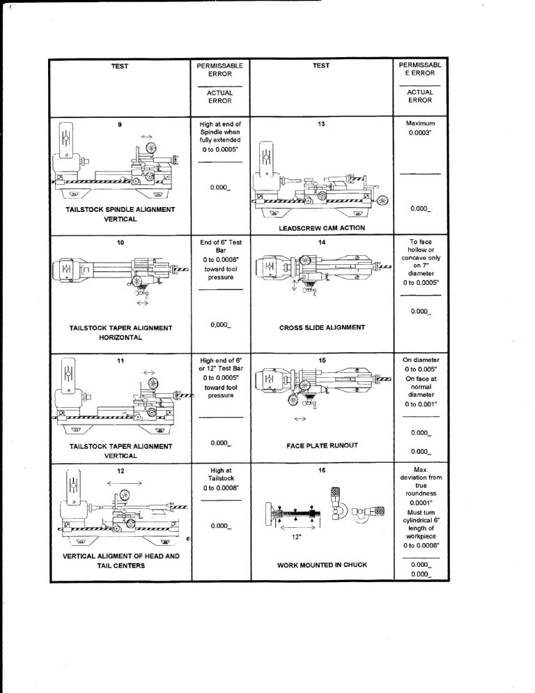

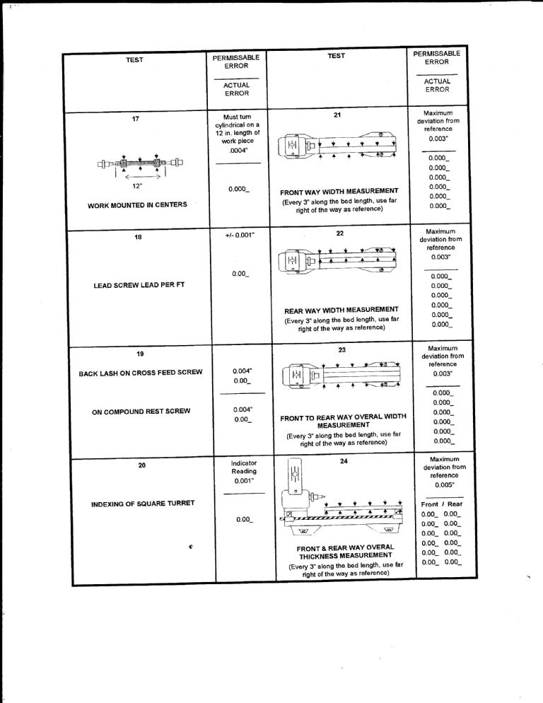

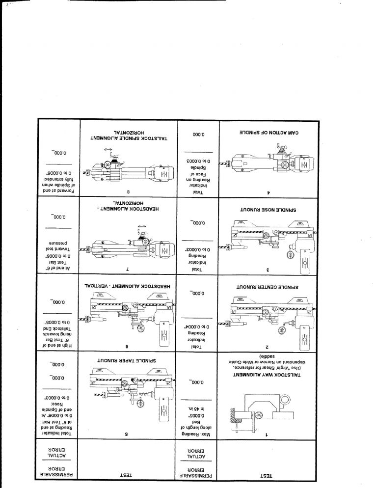

      #506308
      ianj
        @ians
        inspection sheet 2.jpgThis is a copy of the Myford Inspection sheet
        #506315
        Dr_GMJN
          @dr_gmjn
          Thanks for the Myford test sheets Ian. I might re-check mine over the 6” test rather than the 8” I did, just for a laugh.
          Interesting that my maximum deviations from nominal on the bed wear measurements were all well within the specified limits, yet the saddle still locked solid at the tailstock end.

                                                  ianj
                                                    @ians
                                                    Looking at the Myford Inspection sheets:
                                                    test 16, work held in chuck, permissible error .0000" to .0008"
                                                    test 17, between centres permissible error 0000" to .0004"
                                                    So I think you are doing well with your test results.

                                                    #507700
                                                    Dr_GMJN
                                                      @dr_gmjn
                                                      Posted by ian j on 15/11/2020 19:07:57:
                                                      Edited By ian j on 15/11/2020 19:09:00
                                                      Thanks Ian, completely missed those on the sheet, I thought it was just DTI limits.
                                                      The between centres test lols like it’s over 12”, my test piece is only 5”. So I suppose pro-rata, that limit should be 0.00017”? So I’m about twice that limit?
                                                      …or is it half? Hmmm.
                                                      The “held in chuck” seems OK.
