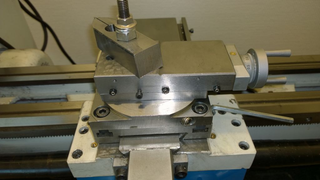

                                                Niels Abildgaard
                                                  @nielsabildgaard33719
                                                  Posted by JasonB on 07/03/2019 16:17:13:
                                                  Edited By JasonB on 07/03/2019 16:51:55
                                                  Thats an awfull nice picture of a very well engineered slide system.
                                                  Been there myself
                                                  Much better
                                                  Found this from Boxford
                                                  From Boxford Spares
                                                  It does not show the   Boxford locking screw/cone very well.Does someone have a picture of underside of compound slide base with integral cone please?
