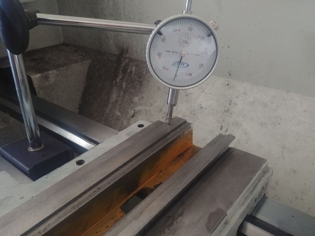

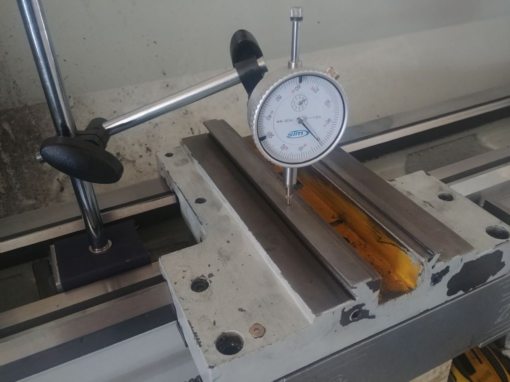

        Simple way to get rid of the 0.004" gap would be to mill that amount off the half of the plate that mates to the carriage but leave full thickness where it runs against the underside of the bed, the step will raise the running surface up 4thou.
        Do check that the bed is constant thickness along it's length, may need a bit of scraping on the underside.

                  Just make the strips (plural – there should also be one under the front shear) fit properly, no need to add fudges that will come back to bite you. When properly sorted, the only way the saddle should be able to move is longitudinally along the bed – no lift, no twisting.
                  As Jason suggested, the easiest way is to take the 4 thou of the part of strip surface that the bolts to the saddle.

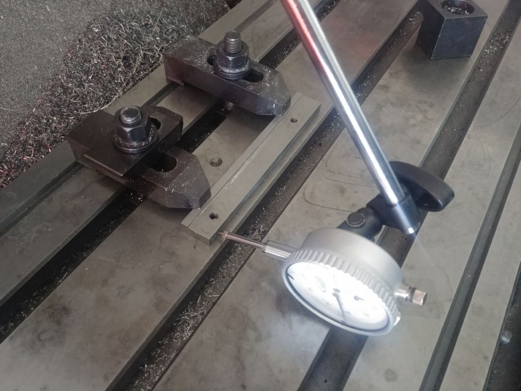

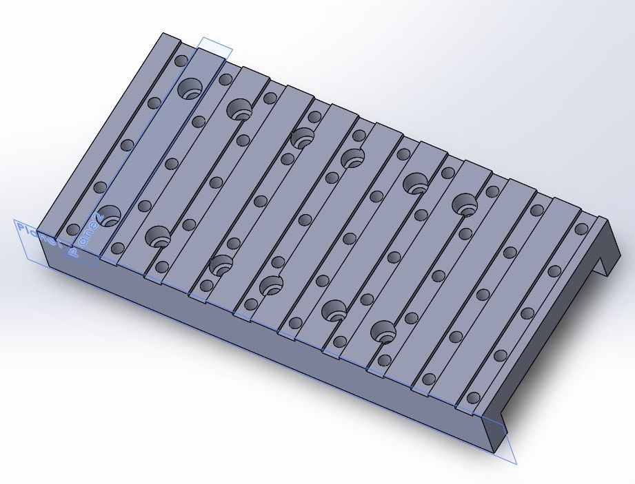

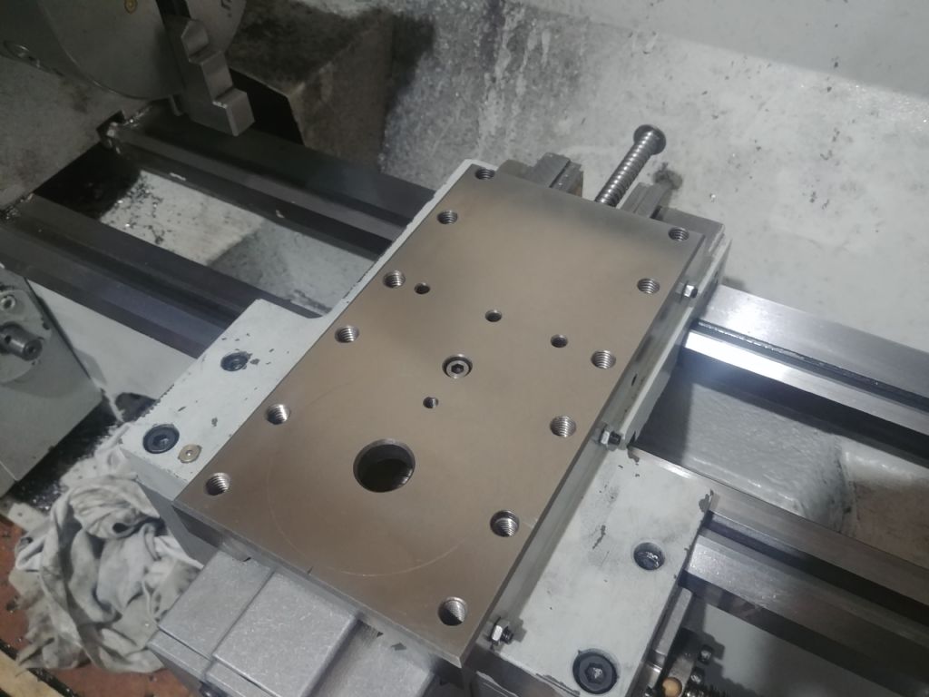

                        I should have a two updates today, the first being that I milled down the gib strips for underneath the bed. Thankfully I did not screw the scraping up as I removed 4 thou on one strip and 4.5 thou on the other. That resulted in a lift of 0.8 thou on the front and 0.2 thou on the back, slides nicely on the full length of the bed, this part is at least well ground.
                        I did some searching last night on standard taper bearings, so I might pick up some SKF ones or even possibly upgrade the spindle slightly as in Niels post to a beefier setup. I have a threaded mandrel which I originally used to hold the piston, then I changed jaws to hold on the outside to see if that improved it, it did not, I also used a live centre for all operations, a good quality one. I do agree my bench is a little underwhelming, but I can sort that after I've tuned the lathe. I was also joking about the welding , plus you need iron hot to weld it good.

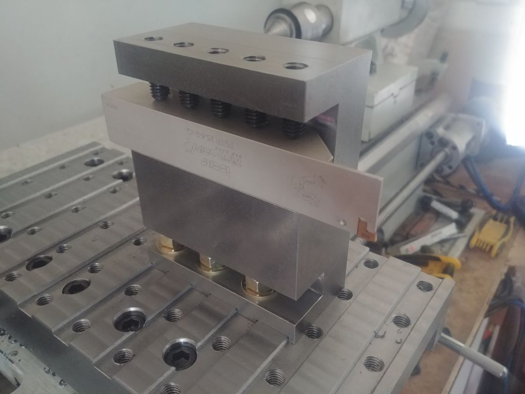

                        I have done some designing for a piece to bolt onto the top slide, made from 6 x 2 x 12.5 steel, a left over, quite a lot of milling to do so hopefully I will get some pictures tonight. I chose lots of slots and tapped holes for lots of arrangements as I intend to use gang tooling. The swing over slide is now 142mm, just enough to do some 140mm diameter tubes, which I have already done without issue.

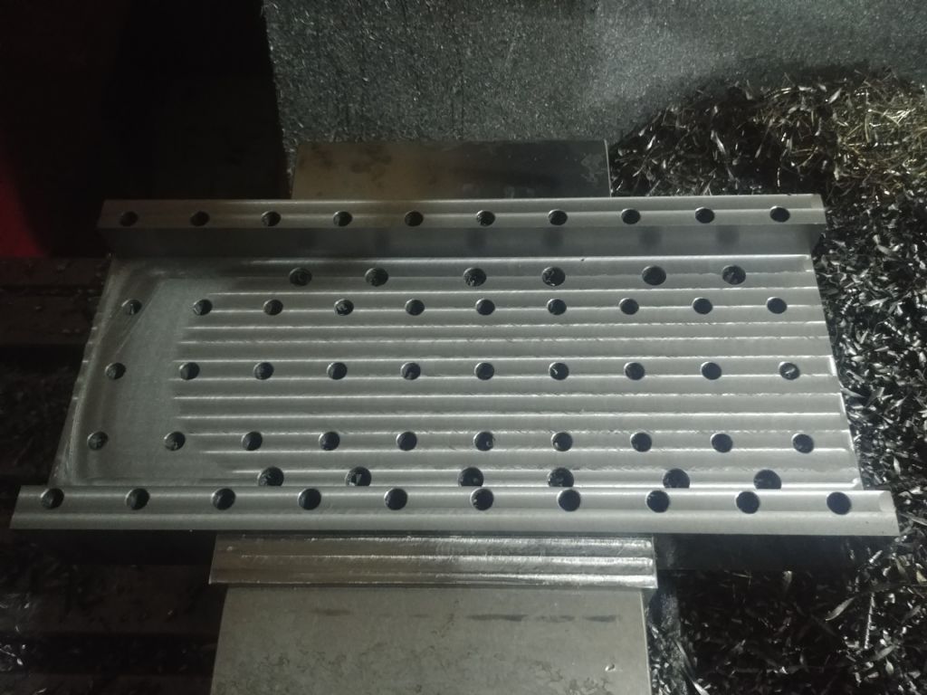

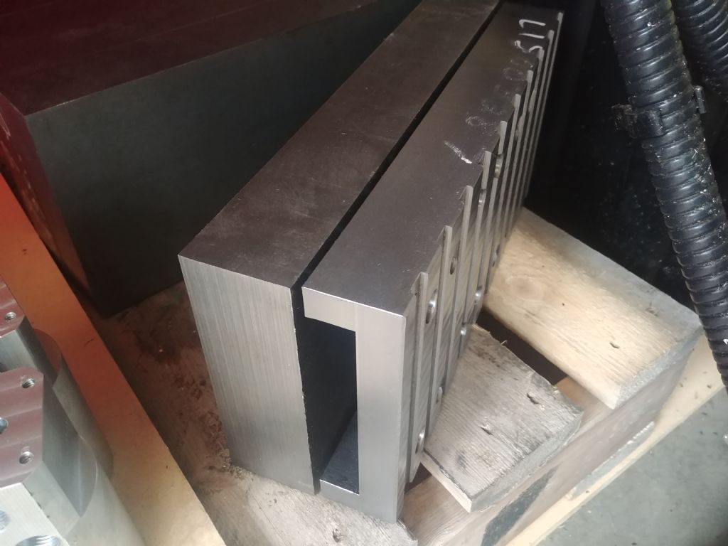

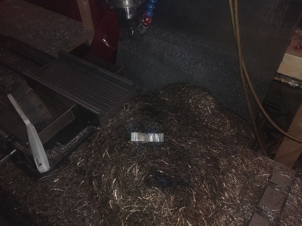

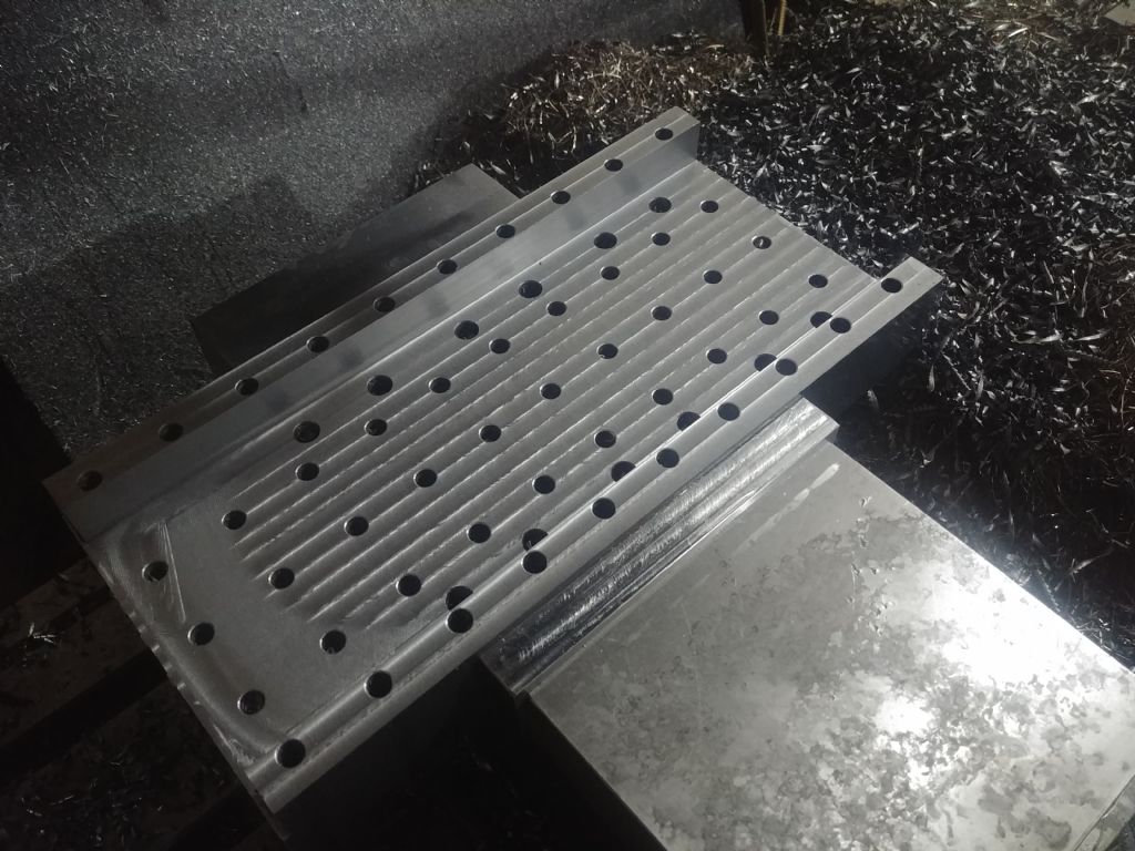

                          Little bit of milling and 62 holes later the bottom side is done.
                          #534979
                          Hopper
                            @hopper
                            Wow that's shifting some metal. What milling machine do you have.?

                              I'll have to take a picture of the mill, it's a Fulland Mill, 1985, Taiwan machine, not sure of the model number, about the same size as a Bridgeport. Maximum spindle speed is 3500rpm, so a little limited. I did a 23mm depth of cut, 0.6mm stepover, 80 IPM, 7/16 carbide end mill. Took about 45 minutes to do the milling, and then about 1hr to do the drilling. Running on Mach4 and using fusion 360. Fusion retracts out all the way for each pass whereas Mastercam micro lifts and back traces the previous cut, I think I could have got it down to 30 minute on that software with this machine, but that's the limit, plus I can't afford Mastercam.
                              I think you're right in regards to the spindle bearings. I have started designing my own machine so don't want to go too crazy with this one, in terms of money. I think the external carrier would add some rigidity, but ultimately the castings will let it down. I have also considered filling all of the castings with concrete, or maybe some kind of sand/resin mix, I think that would also dampen the whole thing, wouldn't be all that expensive either.

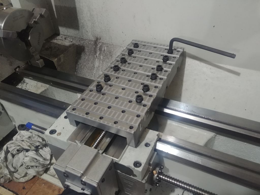

                                          20210320_154100.jpg20210320_155138.jpg20210320_183411.jpg20210320_184345.jpg20210320_184409.jpg

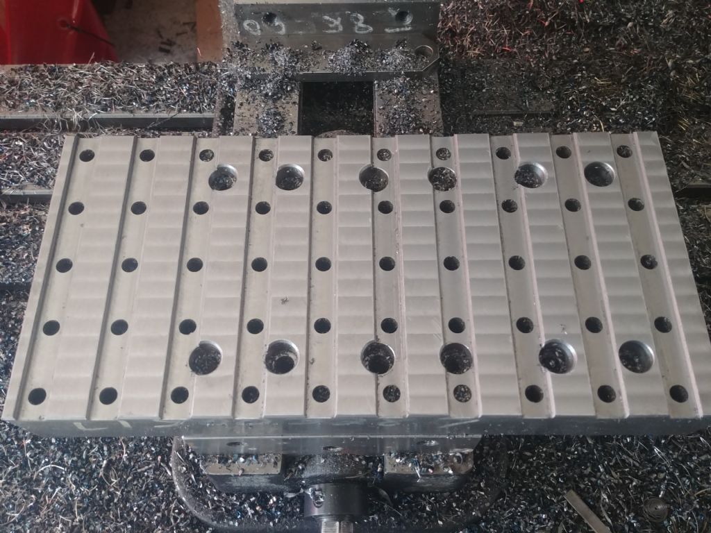

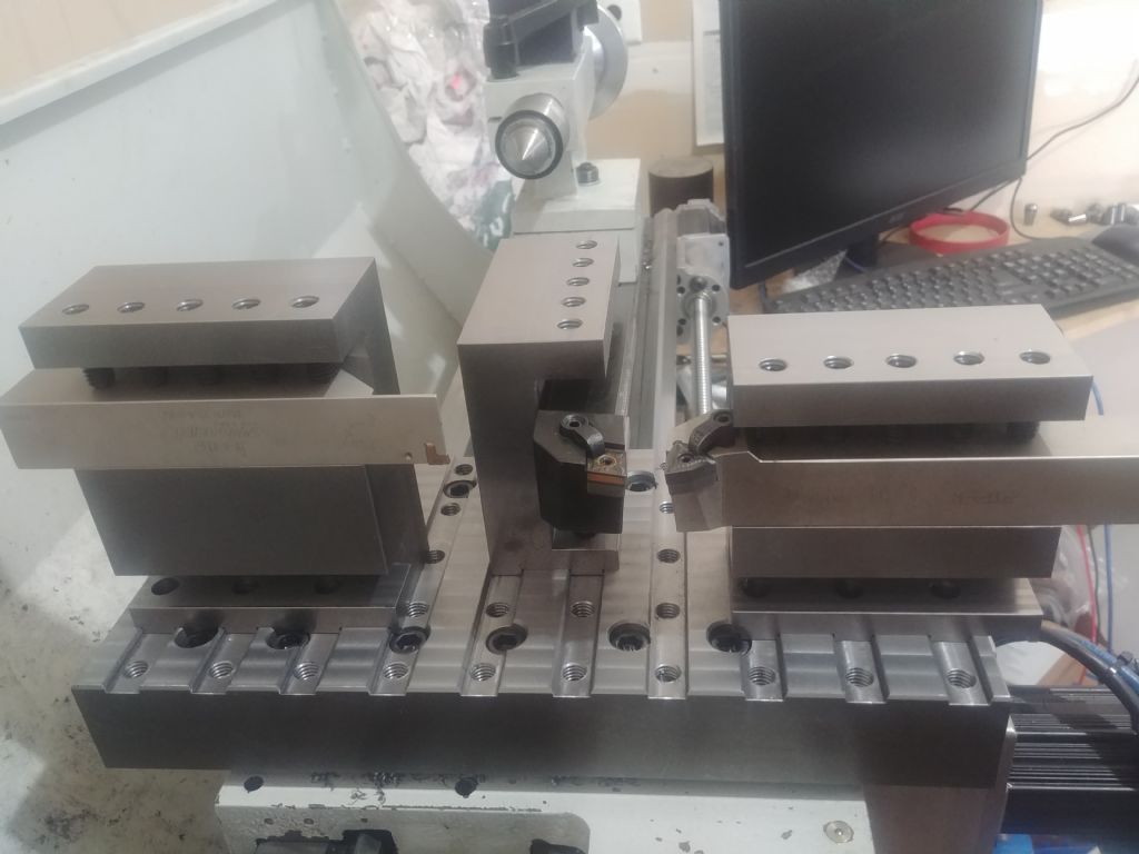

                                          Another update on the build, finally got the top slide done, although I need to cut the bolts down. Note that the holes on the slide are offset to one end because I milled through some original holes to make the bolt pattern symetrical. I used an old HSS chamfer tool which left huge burs on the slots, they were not fun to file. Overall it looks pretty good, I turned about half the original mass into chips. The lathe also has a huge amount of travel on the slide and plenty of space for front and rear tooling.
                                          To address a few questions and comments. Joes build on his CNC is absolutely amazing, can't wait to see it running, and really interested to see his tool changer design. Looks like he used the same supplier for his servo's as me, and that is the same spindle / servo I'm thinking about for the drive. Not worried about swarf on the screws, they have wipers, would be a little more concerned if I were doing iron or grinding. I might make a completely new head for the lathe as Hopper suggested and leave my own lathe build for another time. I'll make an adapter plate so I can swap this new head over to the other lathe in the future. I'm more concerned about spindle bore, which I need to pass 2 inch down. So my current design uses a 2.6" bore, 8 inch chuck and two 80 x 135mm taper roller bearings.

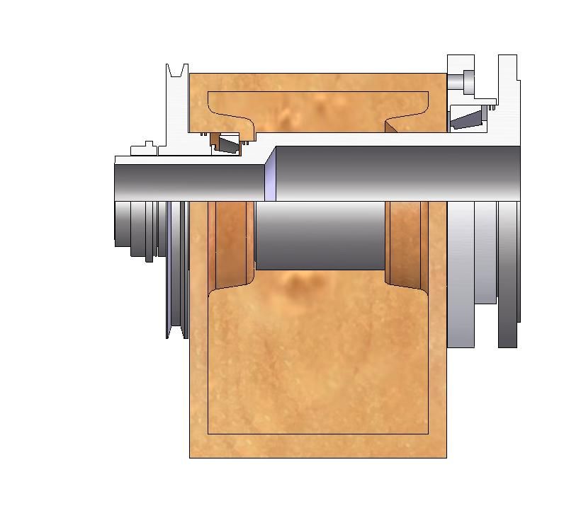

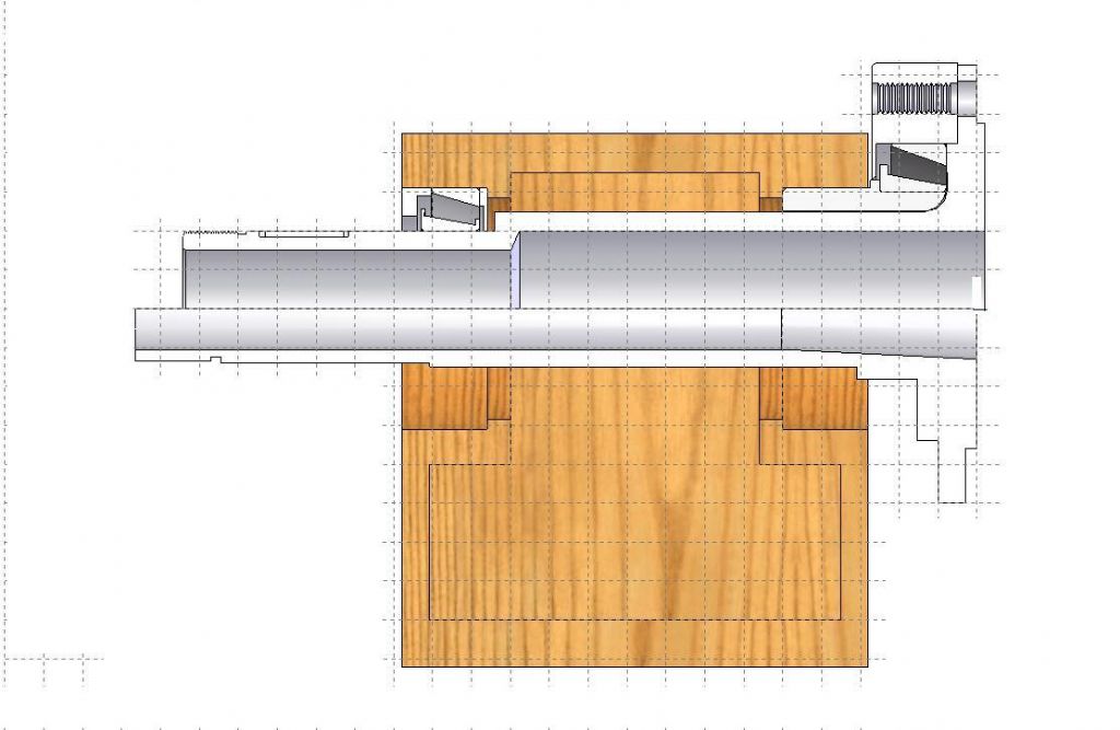

                                            I have been thinking very hard how to make my next 62mm bearing bore lathe more capable.Main problem is to make a system of mandrels holding front bearing holder while Chokfast,Non-shrinking loctite or epoxy sets without locking up tool as well.
                                            On the other hand it is only for the brave or rich as it will not be possible to go back.
                                            You can se on picture that the bearing bore stop on front bearing hole has to go.Not a precission job but non recovedokmega. 32915 32910 jpg.jpgrable.
                                            While I am at it it is no big deal to show how it can look on a 290 lathe with 75mm bores.

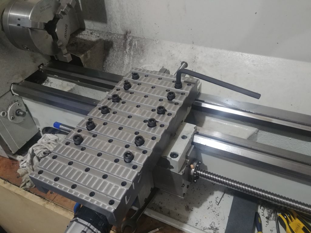

                                              20210327_145834.jpg20210328_123703.jpg20210328_143108.jpg20210328_144450.jpg20210328_145408.jpg

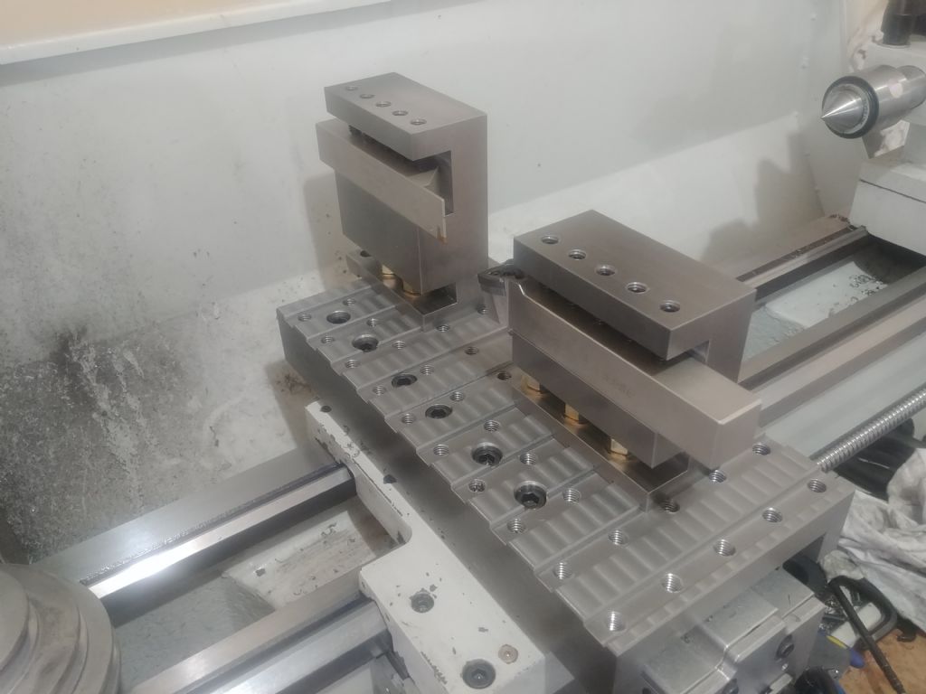

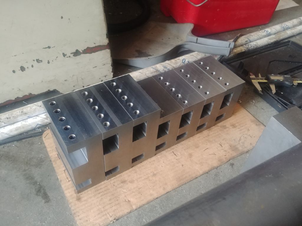

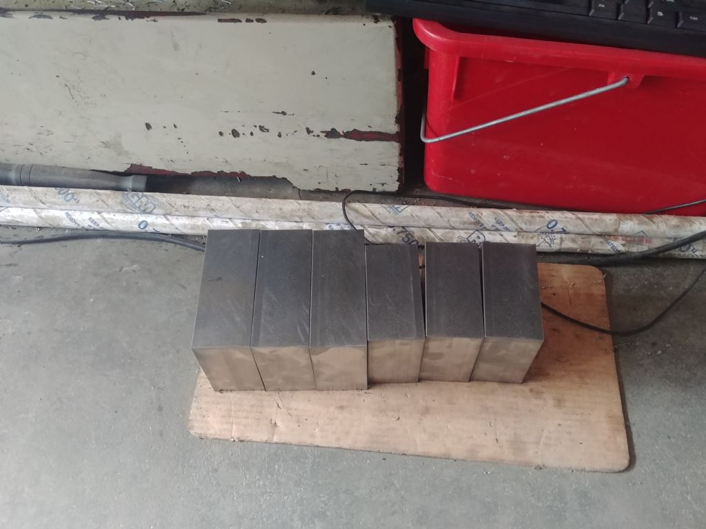

                                              Quick update, took me all week to find a bandsaw, so I could finally cut some blocks for the holders. Also waiting on some SKF spindle bearings, surprisingly the stock ones were NSK, but full of paint flecks. Might have gone a little over-kill on the holders, but will allow most tooling setups and a second spindle. Will be keeping the stock spindle and build a second spindle to bolt to the other end of the bed, for larger stuff. Waiting on my encode too, but hopefully in another week I'll be threading. I also really hate hand tapping holes now!
                                              #536828
                                                Interesting choice in mounting methods. I would have thought the slot for nut access reduced rigidity of the tool holders when the thread seems to be about increasing rigidity. Would through holes on the tailstock side of the holders for HT bolts or cap heads have been a better option?
                                                #536833
                                                Ady1
                                                  @ady1
                                                  Forgot about a Drummond mod which noticeably improved spindle stiffness
                                                  #536838
                                                  Tony Pratt 1
                                                    @tonypratt1
                                                    Posted by JasonB on 29/03/2021 07:32:55:
                                                    I hate to rain on Ed's parade but Jason is spot on.
                                                    Tony
                                                    #536847
                                                    Ed Page
                                                      @edpage45070
                                                      I did fear the slot being close to the bottom would reduce rigidity, counter intuitive to what this thread is about. I chose studs over bolts at the back of the holder to reduce wear, / cheaper to replace, but in reality I probably would never wear them out. The base of the holder is 0.5 inch thick by 4 inch long, that would take a huge amount of effort to flex it, especially on a hobby lathe. Also consider a QCTP holder has about the same thickness underneath.
                                                      Worst case if this is a mistake then I will modify for long bolts and fill in the grooves with lead to dampen the holders. Might even do one as a comparison for my own curiosity.
