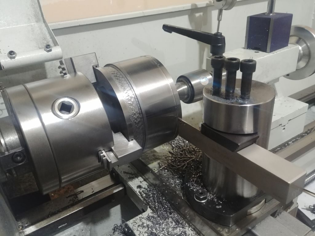

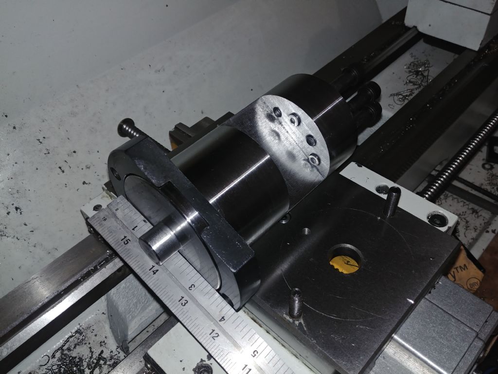

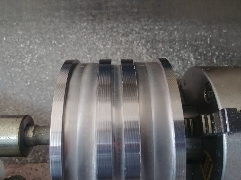

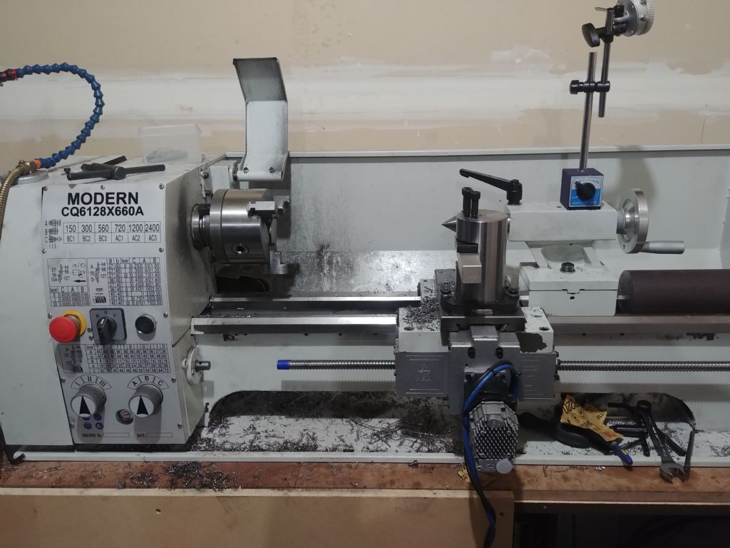

      Hi,
      I'm no stranger to the forum, although not logged in for such a long time it seems I needed a new account.
      I live in Canada which seems to have no market for used small lathes like the UK did, and I didn't have the room for a large lathe, so I had to purchase one new and convert it to CNC. I am a machinist by trade so the lathe is a little under-whelming. I also have a 4 axis CNC mill to make some bits on if I have to. I no longer have access to any other machining tools apart from this lathe and mill.
      This lathe is the Grizzly 0602 equivalent, a pretty generic lathe design with lots of different names to it. I first removed the compound and replaced it with a new holder, made from 4140 to hold 1 inch standard lathe tools, also to make it rigid as possible. I converted it to CNC, it is running some high torque servos, runs at up to 10m/m, so it's fast. However it is not very capable in terms of rigidity. I have been making some pistons out of 1018 steel which I managed to turn at 0.4mm/rev and 10 thou DOC, that was the limit of the motor, but also shallower cuts caused vibrations. I could only hit 3 thou before the CNC conversion, it now maintains half a thou. It finally got to cutting the grooves in the pistons to find all it would do is chatter, in the end I used my 4th axis on the mill to do the grooves, but that was quite time consuming. The piston is 5 inch in diameter.
      I have tightened the gib on the X-axis as tight as it should be, there is no adjustment on the saddle, the weight of the servo actually lifts it off the back ever so slightly. There is a small strip of steel bolted at the back underneath the saddle to keep it from lifting, without that the saddle would literally fall of the front. I know there are lots of solutions but I would like to know your guys opinions. Here are a few of my ideas in order of complexity.
      1. Bolt a 20lb slab of lead on top of the X slide, that should dampen resonance and the weight should take out any slack. However not sure that will take slack out of the X axis, and it may put a lot more wear on the bed.
      2. Mill the saddle flat, hopefully its not hardened. Bolt some linear rails on, make a new X- slide out of a chunky piece of steel. I never need to turn any more that 6 inches, and I do have a 2 x 6 x 12 piece of flat bar left over.
      3. Make a completely new saddle and x-slide. Line the saddle with either plastic or bronze against the bed surface, make it very heavy, 100lbs or more total.
      20210317_221417.jpg20210317_221429.jpg20210317_221455.jpg20210314_204233.jpg20210315_155223.jpg
          lol
          Its never going to be easy to do a huge lump like that on a hobby lathe
          No real stiffness so high speed and sharp carbide
          The real solution if you're doing a lot of work that size is a bigger lathe

            My first thought looking at the photos is that your grooving tool has a lot of stickout.
            If your saddle isn’t in contact with the bed properly I suspect there is a
            potential for “bounce” for want of a better description – the saddle dips as the cut comes on, then as the chip peels it lifts, changing the tool angle, which causes it to dip again….
            Can you add ball bearing gibs like on a 10ee to the back of the saddle?
            #534518
              You could also try a narrower tool. You say you could only manage 10thou DOC when turning so as you are now using a grooving tool that is maybe 100thou width of cut that is putting a lot more load on the light hobby machine. Something like a 1mm wide carbide insert of the "Minithin" style would be how I would do it on a manual machine at those diameters.
              Servo at the back may balance out the apron at the front.
              Some people also change the plate that held the topslide to a rectangular one with a fixing in each corner and say it helps with rigidity, looks like you have retained the original plate.
              Edited By JasonB on 18/03/2021 08:29:09

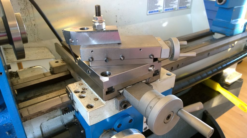

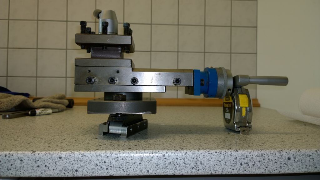

              Nick Wheeler
                @nickwheeler
                Posted by JasonB on 18/03/2021 08:26:43:
                I could see the original plate on WM250 bending when parting off or making heavy cuts. I replaced it with a 15mm thick plate, using all of the original topslide fittings and four M6 t-nuts. The original plate needed to be done up really tightly for any clamping effect. The new one just needs the four bolts to be nipped up with a 10mm spanner for much better clamping.
                The new plate was hacked out a larger chunk with an angle grinder, the cut edges filed smooth, and the mounting/clamping faces machined in the lathe. I keep promising myself I'll paint it, but that's unlikely to happen until I paint something yellow….
                I can't imagine using 1" tools on such a small machine, and definitely wouldn't want to pay for them. Most of mine are 8mm shanks, used in a Myford size Dickson QCTP, and they're not the limiting factor.

                Speedy Builder5
                  @speedybuilder5
                  A bit of a job now, but put the stepper motor on the rear of the saddle ??

                    Hopper
                      @hopper
                      If I was doing that job in my Myford — which looks to be a similar sized lathe — I would be using back gear to spin that 5" piston at less than 100rpm somewhere. Will your Chinese lathe run that slow without losing torque?
                      And I'd reduce the stick-out on that grooving tool to the absolute minimum, like the groove depth plus 1mm. The round toolpost has the disadvantage of curving back the wrong way right where you need max support on the cutting edge side of the tool unfortunately. A grooving tool with the cutting edge on the right-hand side of the tool would be better supported.
                      Fort the wider grooves in the final pic, I might use a regular left-hand and right-hand turning tools to make that. Cuts nicer than a grooving tool when moving it from left to right to widen the groove. Just have to use the two different turning tools to get the square shoulder at each end.
                      And I find that in rigidity-challenged situations such as grooving on these small lathes, a razor sharp HSS tool can chatter less than carbide.

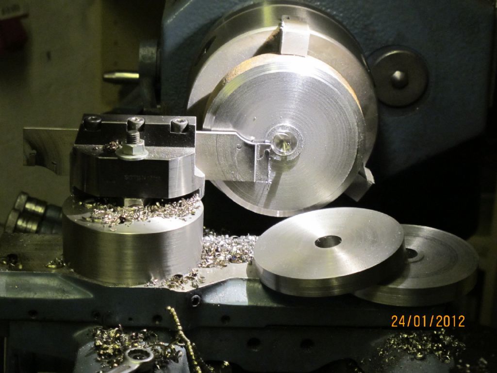

                        Niels Abildgaard
                          @nielsabildgaard33719

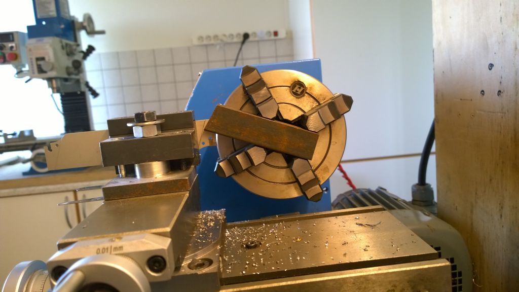

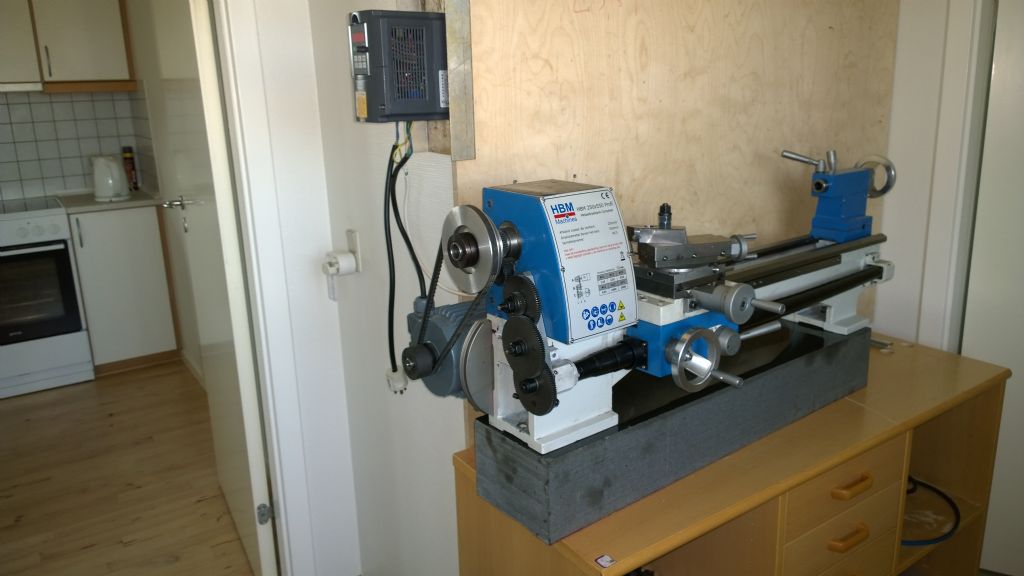

                          The lathe is a 26mm bore 250 size like the much loved one I had before my son liberated it.He will get a surprice when estate is parted.
                          First thing is that it shal have a solid foundation.
                          The old Emco toolholder system is idiotic and a momemade came onTool System
                          Standard EMCO copy

                          Niels Abildgaard
                            For parting on my Boxford I made a very stiff system and for my 250 with solid flange another.
                            The ME photo insert system is a disater waiting to happen for us unpaid writers

                                #534636
                                  This guy has a nice solid replacement for the top slide
                                  #534645

                                      Posted by JasonB on 18/03/2021 13:09:26:
                                      yes __ I would probably even be tempted to tap the LIKE Button if we had one !

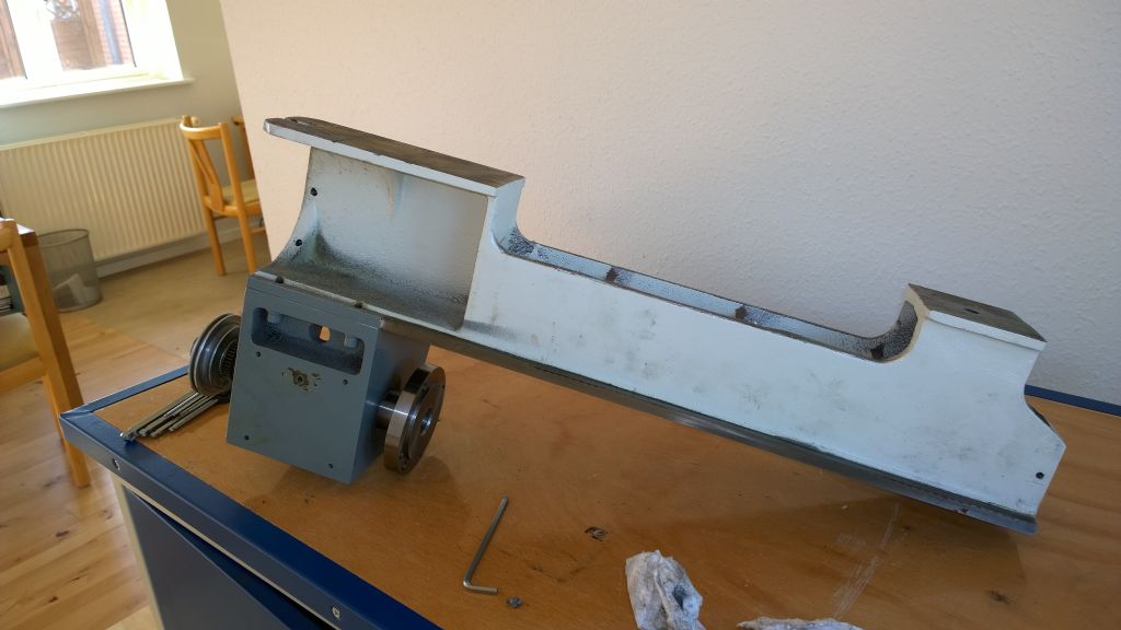

                                        #534686

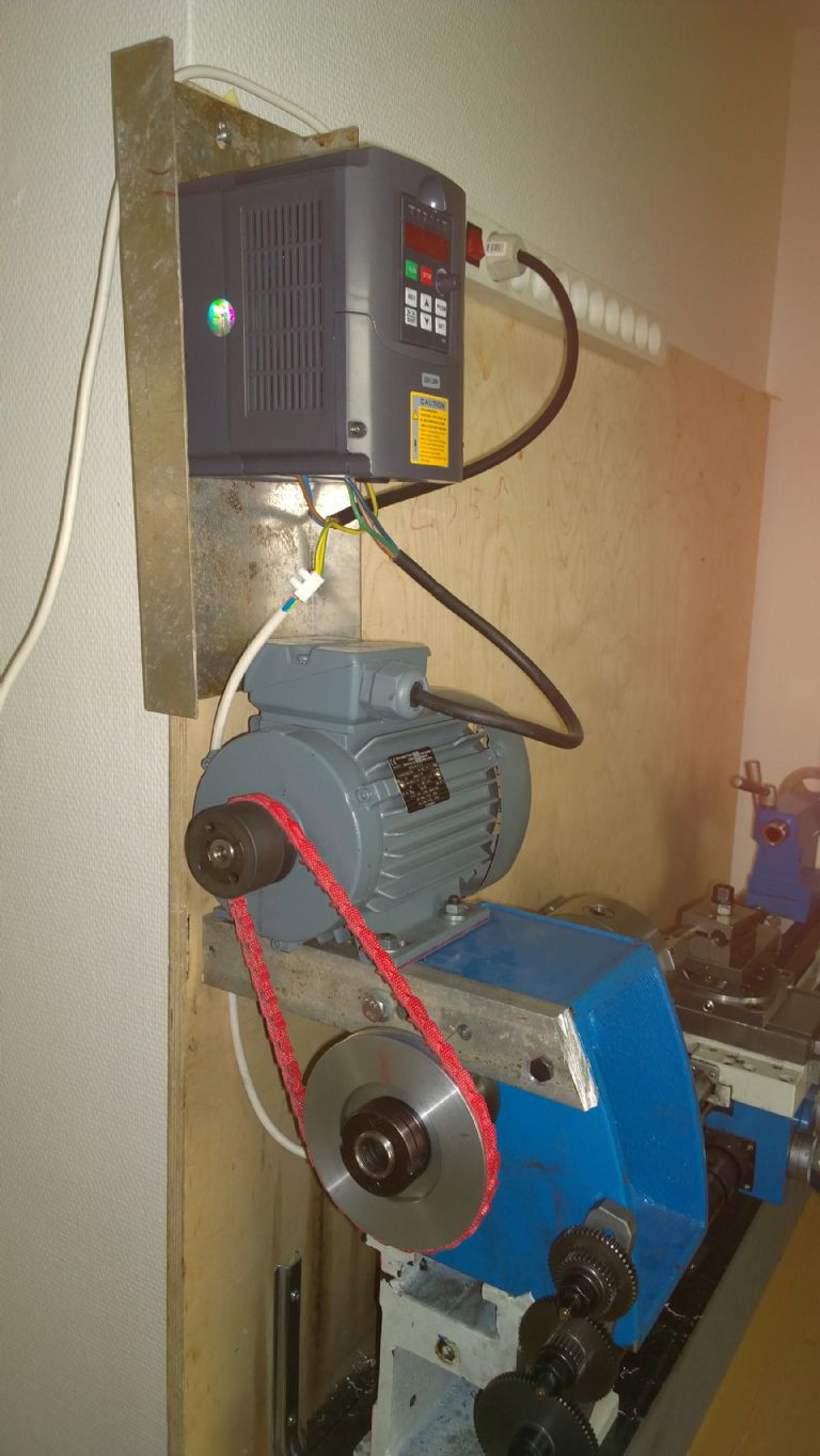

                                        Niels Abildgaard
                                          Posted by mgnbuk on 18/03/2021 13:45:29:
                                          The bed design on these doesn't seem too good if it is similar to the model Nils shows – in one of his other posts Nils showed one of these machines stripped down & I was struck by how poorly the headstock is supported due to the amount of metal removed underneath it to make space for the motor. Most Western lathes continue the bed at it's full form (or beef it up) under the headstock to properly support it.
                                          The bed of the 180/210 lathes is Lousy but the Canadian gentleman lathe is a 250 and frame is miles better than Myfords and on par with Southbend/Boxfords
                                          WM250 plus Huanyang
                                          Edited By Niels Abildgaard on 18/03/2021 15:44:35

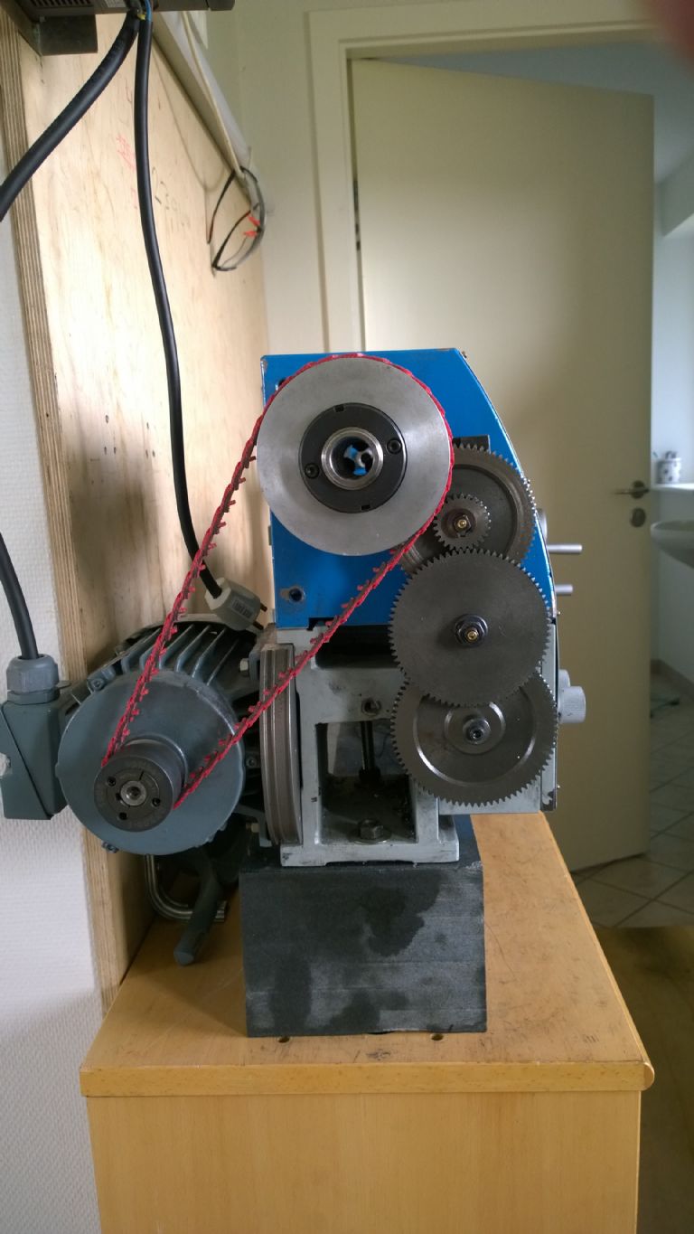

                                            Niels Abildgaard
                                              Posted by mgnbuk on 18/03/2021 15:48:10:
                                              Thanks for the clarification Nils.
                                              The lowest photo is the one I was thinking of – light use only there, I think !
                                              Nigel B.
                                              It depends on what You define as ligth
                                              Modified 180 Lathe
                                              it was done with a sewing machine motor
                                              Stiffened 180 lathe bed
                                              Edited By Niels Abildgaard on 18/03/2021 16:34:12

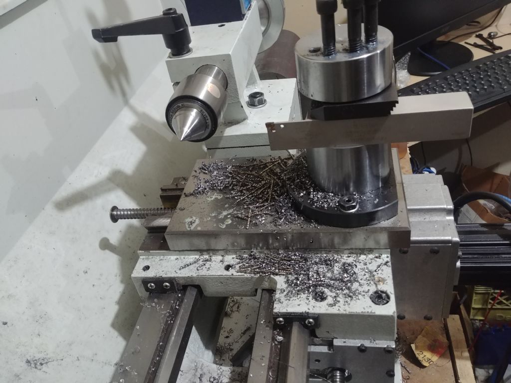

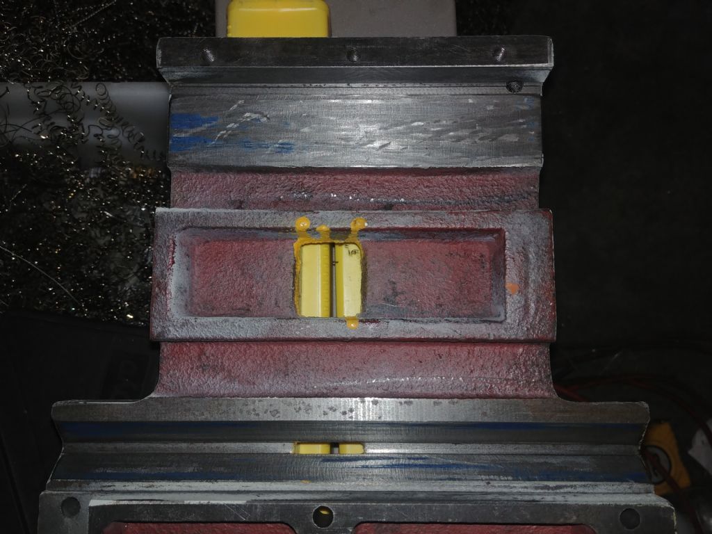

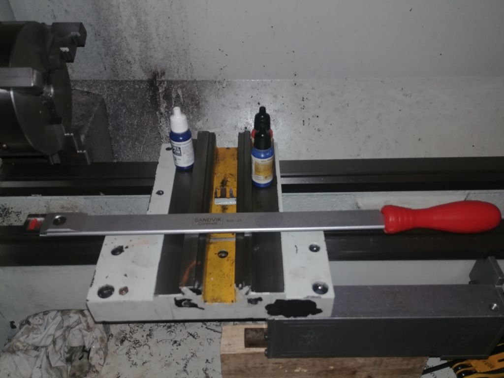

                                              Ed Page
                                                @edpage45070

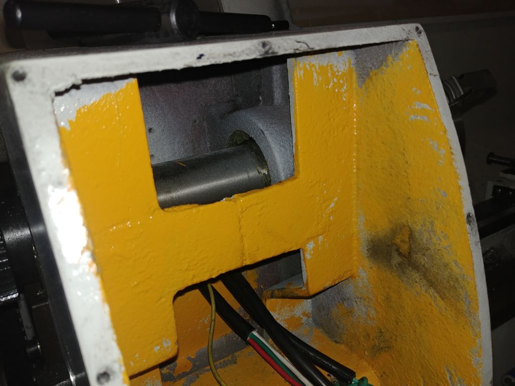

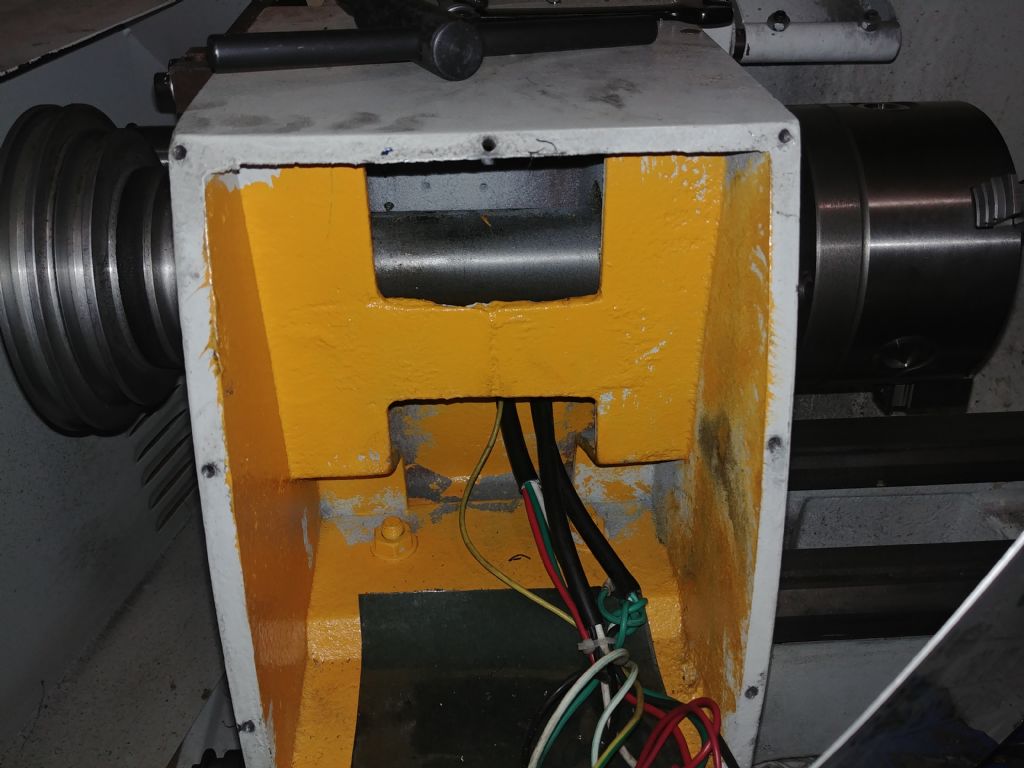

                                                20210318_180354.jpg20210318_180401.jpg20210318_180446.jpg20210318_182539.jpg20210318_183031.jpg
                                                Quite the response!
                                                I can't address everyone so I guess I will generalise the response, also, I'm originally from the UK. I've owned an old Pooles, Denford Viceroy and Harrison M250. Never had rigidity issues with any of those, but they were good old lathes. Some nice big lathes over here, like 4m long beds or more for cheap, but everything smaller is new Chinese. Going from model lathes to industrial and back to a model lathe is quite a step down. 25HP back to 1HP. Funny that I buy old HSS end mills over here for aluminum, Presto, my home town, take a guess.
                                                I know I'm pushing the lathe a little too much, the original idea was to make one from scratch and have some castings made, wish I had now, but that is a project for another time, but now I don't have access to an industrial machine. Thankfully I will get a decent amount back when it comes to part with this lathe due to the market, plus I have all the original manual parts for it as I'd keep the servos. A little bit of info, 10 inch chuck, 3 inch spindle bore, linear rails, 10 inch swing over slide, 20 inch between centres, gang tooling, 3 or 5HP direct drive, 1500 rpm max. Which brings me to the spindle bore on lathes. If you want a 3 inch bore then you need a 10 inch chuck, that comes with a very long bed, probably over 80 inches. Some CNC's are 36 inches, but the machine is still huge and requires big power. What are peoples thoughts on a hobby / small industrial lathe with a larger spindle bore and shorter bed? I personally hate end pieces, and working at the tail stock if its something long.
                                                So, 1 inch tools are cheap and better quality than the hobby stuff. Round tool holder because it's quicker to make it from round in a lathe rather than mill it, plus round stock is cheaper. Tool post is 3 inch round 120ksi steel. Grooving tool is set length, not adjustable. Insert is 2mm wide, feed 0.04 to 0.12mm/rev, they are intended for light turning. Slowest speed of lathe is 150rpm, but it's belt driven. I will mostly be turning between 1 to 3 inch round, the 5 inch piston was over doing it, but cheaper myself than outsourced, plus it worked out on the mill in the end. I want the lathe mostly for threading, but a 12TPI -1.5 inch thread I still think it's not rigid enough. I agree with the z axis ball screw coupler, I do have to limit the speed because of this. HSS definitely would have been an option, but at 5 inch the surface speed would have been about 200SFM, that's on low carbon steel, in my experience it would not have lasted long, 10 parts total, 2 thou tolerance. HSS is diabolical over here, all comes from China.
                                                I took the plates off the lathe to take a look at the castings, as in the pictures, thankfully it's reasonable unlike the one in Niels post, that is pretty sketchy, can't believe someone would design something like that. I might get a 3HP servo to directly drive the lathe with a timing belt since I will need an encoder for the threading, the motor will then be used on my later CNC project, maybe 5HP depending on the price. Would love to make chips instead of razor wire!

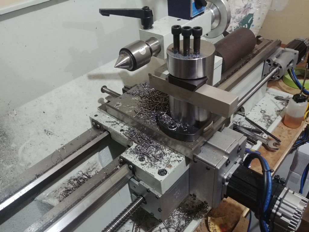

                                                  Anyway, only managed a few hours on the lathe, busy day. I took apart the saddle assembly to see if it sat on the bed correctly. Look at the pictures carefully, the vee has contact all the way down, the flat has one tiny contact patch in the corner, looks like this is a big issue. Overall not a lot of contact. I broke out the Sandvik scraper, something I've never done before. I probably took a thou off all surfaces and about 3 thou off the bad corner. Sorry no pictures, my cross-hatching technique didn't look pretty. That's all I managed, but now the slide sticks with oil suction to the bed, I also put force in every direction with a DTI to find nothing moved, I'm happy with that result.
                                                  There are two gibs underneath the bed, neither adjustable, but there is a 4 thou gap on both front and back now. I've seen a few recommendations from adjustable gibs to bearings. There isn't much room to play with but I am thinking of something spring loaded, maybe some spring steel strips with a bronze blade? Let me know your thoughts.
                                                  I really like the modifications made to the top slides, especially that milled tool post. I have a large piece of steel I'm going to work on in the next day, it will bolt directly to the top slide at its full length. I will then bolt some gang tooling to that, will update in the next 24 hours. It will reduce my swing over the slide to about 6 inches, but I can't imagine ever needing that.
                                                  So overall you get what you pay for, and this lathe is better than none at all.

                                                  Hopper
                                                    @hopper
                                                    Yes when you see inside the headstock, it does not look overly massive. The word Gibraltar certainly does not come to mind.
                                                    It's hard to tell from the pics, but it looks like yours has the common shortcoming of many Chinese lathes: The bed width is narrow in comparison to the spindle height. It looks like the bed width is quite a bit less than the spindle height. So the triangle between the bed shears and the spindle is a tall, narrow based one. That's inherently less stable than many better quality industrial lathes and toolroom lathes that have the bed considerably wider than the distance from bed to spindle, so they have a flattish, broad-based triangle to spread cutting forces over. So between the headstock bulk and the bed wiidth, you are never going to get the type of rigidity you are used to in industry.
                                                    But as you've seen, going through and "blueprinting" the machine should tighten it up considerably.
                                                    I wouild not go with springs under those saddle lift plates. Cutting forces will overcome those springs. Best to do like Myford and most others and machine either the lift plates or the area where they mount on the bottom of the saddle so strips of shim can be used to get the desired half a thou or so clearance there. Anyway, if yoiu are plunging straight in you should have the carriage locked, which ideally should lock on that rear bed way. Might be an addition to consider if it does not have one.
                                                    I know you like that 1" tool and the overhang would be fine on a big rigid industrial machine but is just begging for trouble on these smaller flimsier machines.
                                                    If you go through as you are and eliminate all these little things, the sum total should put you ahead of where you were. But you are not going to make a Monarch 10EE out it due to the core design and build factors.

                                                    Ed Page
                                                      @edpage45070
                                                      Hi Hopper,
                                                      Yes the spindle is definitely higher than the width of the bed, plus due to the diameter of the piece I was turning the tool holder was to the front of the bed. I knew it was dodgy, but sometimes you got to do what you got to do. I really wish I had gone for the part-off blades that are adjustable, I should have known better, but now it is too late.
                                                      I totally forgot about the bed lock, and I definitely used it on all of my previous lathes. The big issue now is that it is CNC and I'll be mostly using it for threading, so while I could lock it for grooving, I definitely cannot for threading. I have about 100 threads to cut, 0.75 – 16, that will be its next challenge when I sort out the encoder. I then have some 1.5 – 12 threads to do after than. All in 4140, which is 120KSI or thereabouts.
                                                      I will see what the others say about the gibs first before I make my final decision, but I do think you might be right in that the springs will just give, shimming would also be fairly easy to do, I just hope the bed is the same thickness all the way down.
                                                      I'm probably going to remove the head in the next day or two to see how that's attached, maybe replace the bolts with some studs. Worst case I'll get some nickel rods and weld it together, disgust I might also put a tiny bit more pre-load on the headstock bearings, although haven't checked those to see if they're too tight or too loose yet, but there definitely is no play in it by hand.
