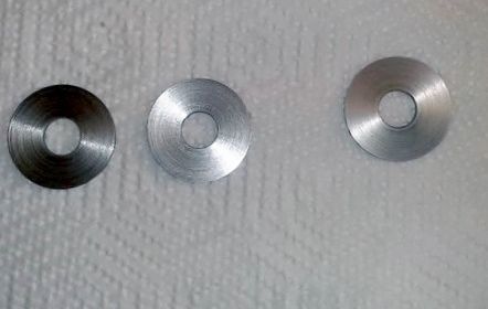

            I built one from a Hemmingway kit; the original angled side allowed too much overhang at centre height so I turned it round & used a bought holder upside down… a much improved set up … & much better rigidity. There are more pics of the machining in my album… Rear tool post.
            Establishing centre height…
            First cut after machining & assembly …
            1"dia MS washers…
            George.
            Edited By mechman48 on 20/10/2016 16:14:53

            MW
              @mw27036
              I'm not sure if it's right or not to hold it like that, the fact the strip is angled a bit looks a bit weird but so long as it's held firmly in it's seat it should be ok?
              I maybe have a bit more courage or a bit madder or maybe my lathe is able to take it but i have used small part-off blades in the past and found that they are ok for small diameters and i use a front mounted tool.
              I found they tended to bend inevitably as you extend them further and push them to part bigger diameters. I found my only option beyond that was to grind custom length parting tool from HSS and the tool width was more like 4.5mm to have the needed rigidity for 2" diameters. And this tool would do stainless okay.
              PS. those washers look very nice, mechman!
              Michael W
              Edited By Michael Walters on 20/10/2016 16:25:00
              #262068
              mechman48
                @mechman48
                … PS. those washers look very nice, mechman!
                Thanks MW … iirc & fwiw they were machined off under power feed, approx' 400 rpm with the minimum feed rate as set on the machine… & plenty of neat cutting oil.
                George.
