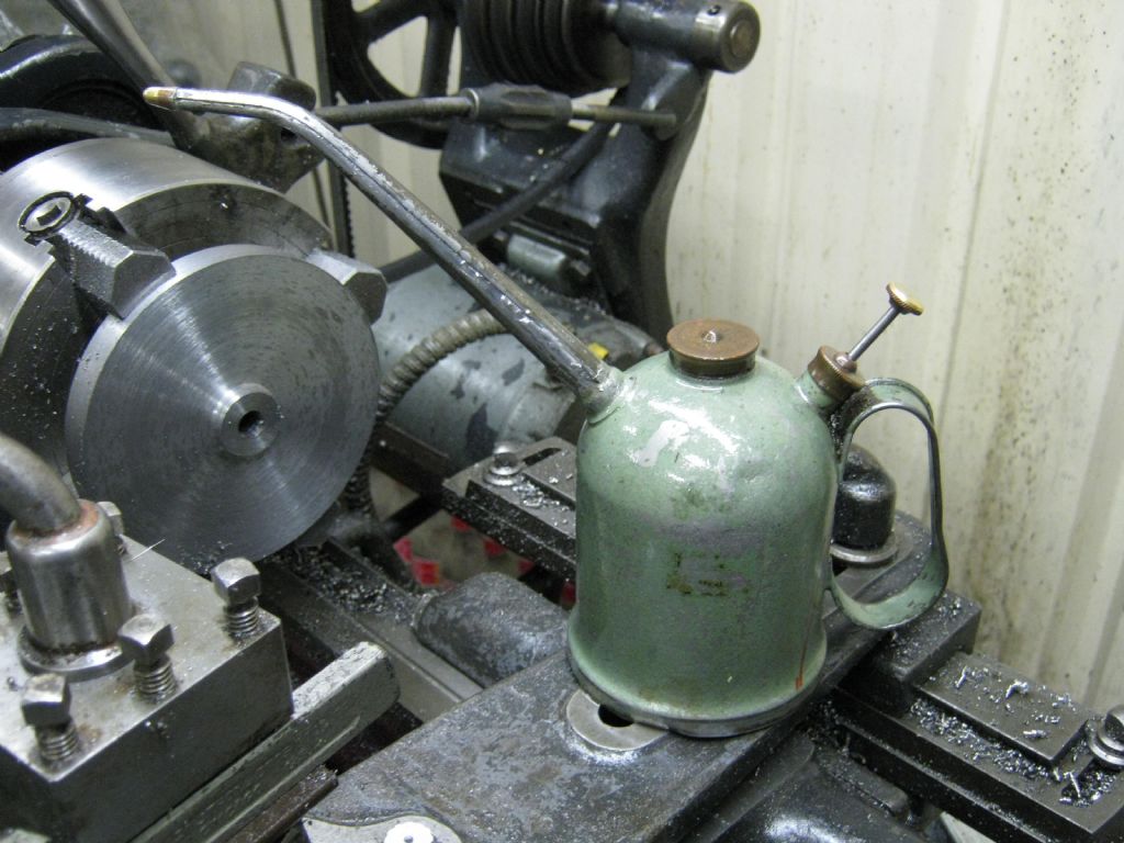

      Hi, is there a trick to getting lubricating oil into oiling points (i.e. those with spring loaded balls) on machine tools?  I have a pump action oil gun (from Reeves) but when I press the nozzle up to the oil point and give the handle a good squeeze, the oil just seems to splurge out.  Do I need a special nozzle, or am I missing something?

          you may just have too big a nozzle.
          I use an old rega pressure oil can with shell tellus 46 as the oil. there is a slight weep as the oil is squirted in but it works ok
          thats what it looks like

            on the oil can I have used
            the nylon end of the nozzel is conical and the tip fits into the oil point
            and if pressure is applied this  makes a good seal so the oil is forced in

                I have an oil can which looks very like the Reeves type, but I bought it about 45 yrs. ago, made in Poland I think, This has a tapered brass end, which fits the oilers very well and can force oil under pressure. I did have to de-burr the hole edges on a couple of the oilers tho’.
                #56440
                  Sometimes helps to put a couple of nicks into the hole in the spout so the ball does not seal the spout when you push it down.

                    Put a piece of kitchen towel over the nipple, press the oil gun and it should stop the leak.
                    I use this on my Myford lathe and oilgun all the time.
