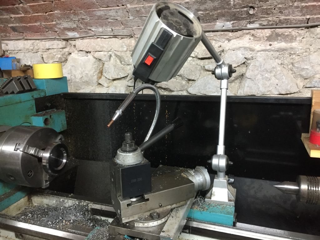

      This is the light on my lathe, as supplied:
      It has a 24V halogen capsule bulb wired from the internal lathe electrics – I'm not sure if AC or DC, but I suspect the former.
      It's convenient that it moves with the saddle, but sometimes it gets in the way. For example in the setup above I had to take a handle off the compound wheel to avoid hitting the knuckle on the light.
      I have some ideas about how this arrangement might be improved, either by relocating the existing light or replacing it entirely, but I'd be interested know how others would approach the problem. Someone will come up with something I haven't thought of for sure!.
      Robin.

          I see no good reason to have it moving with the carriage, and several reasons not to. I'd re-locate it to the splash guard so it can be swung out of the way at times.

            Thanks Pete – that's one of the things I hadn't thought of. Can you elaborate on your reasons for thinking that it's not a good idea to have the light moving with the carriage? I've found it helpful, when it doesn't bump into anything… but I'm a tyro.

              If you were doing jobs six foot long it might be nice to have it on the carriage. Otherwise I'd mount it on the splashguard a little to the right of the chuck. Works for me and just about every lathe user since Noah.

                OK, thanks, I'm convinced (I think). Because I'm self-taught with this lathery business I have a tendency to assume that if there's an area where I disagree with the machine it's likely that the machine (or her designer) is right and I'm wrong. That colours my perceptions. I should be more bold.

                        The GH600 lamp moves along with the saddle. I found that it was just too close to the chuck and got in the way.
                        I exended the bracket to move it further away. Little improvement ,it still got in the way. Put brain cell in gear and
                        moved it to the lower right hand side of the splashback. It is now out of the way but the flexible "neck" means that it
                        can be directed forward onto the chuck with no trouble

                                  Well, light isn't like coolant it doesn't have to follow the work. If you fix the lamp somewhere where it lights the whole area around the chuck you'll get better spread and less glare. If the lamp is moving you might have it so low that you feed it into the work, the chuck or it might get caught by any stringy swarf and whipped into the job (or the operator). It's also in an inconvenient place for the compound controls as you've discovered.

                                              Thanks for further replies. I'll get rid the light and fix something to the splash guard. I've got a couple or three IKEA Janso flexible neck lights, but the clip on versions are pretty much useless for this type of thing – they don't stay put, and I read in another place that current offerings have a shorter neck than the old ones. I'll look around.
