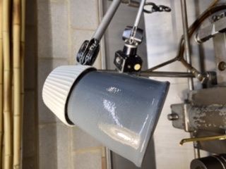

      I am restoring a DSG lathe. I thought the light had long since been disconnected. After blowing very fuse in the machine ( pump wiring contacting chip tray .. 415v) I had to replace them all and found that the light had 36 volts so I have painted it.
      I now need a 36 volt bayonet ( Standard B22 I think) bulb, preferably bright and led. Failing that converting to led within the shade. I want o keep the original light as I am hoping to keep the lathe as original as poss. Any recommendations where I can get a bulb?

          There is presumably an ‘acceptable’ UK supplier of these, Nick … ‘though I have yet to find them
          **LINK**
          15W 24V-36V DC LED Light Bulb BC B22 E27 Lamp Marine Lighting
          From the spec, they look ideal.

            Do you have 3ph and neutral ? if so rewire to use 1ph and neutral and then use an ordinary 240v led unit. plan B use a control circuit transformer – 415 to what ever you want 12v, 24v , 240v Etc Depending on your bulb being ac or dc in the latter case a small rectifier and smoothing condenser.

              Hi Capnahab in my service job (now retired) I kept a stock of machine lamp bulbs which were 25 volt and 50 volt. They were available from a local electrical suplier and I think I would just fit a 50 volt bulb as you should not fit a 240 volt lamp to a lathe with metal and fluids flying about. You could change the bulb type and the supply with a new transformer to LED but make sure it is low volt 50 volt or less. Have a look at the supply transformer that us fitted now as some have a multiple tapped transformer which you can change the voltage output.

                Good tips thanks. Points taken about 240 volt conversion and safety issues. The bulb fitting is bayonet (which I could easily change) so I have with this , looks like it will be a while coming from the east.

                  If the present system is delivering 36V AC single phase to that lamp, that would provide 50V DC, if rectified? But you don’t indicate whether your present supply is single or three phase…

                      if you care to look at the aftermarket truck/lorry (an old word now) they have LED bulbs at 24v -36v plus which will suit you….just need a bulb holder but the are very cheap…..
                      prob a headlamp bulb will suit the job…..

                        Not heard of a machine lamp of 36v before. Is it possible that under load the volts drop to 24?
                        It might prove cheaper in the long run to ditch the transformer and start over with a 12v LED arrangement after all they only used 24v to get the wattage with lighter wiring than if they used 12v and to avoid using car bulbs that would have been nicked for operator's cars.

                          When fitting LEDs to my machine lights I've used 12V DC ones to remove any strobe effects that the AC ones have.

                              If you check in the transformer box for the light , you may find there are different voltage tappings on the transformer, so you may be able to change the voltage to one which you can get an LED bulb for. , search for xx volt BC led lamp. This came up before on one of the forums I frequent, and I found some LED BC lamps which were for canal boats, so they can be bought! You could make one out of an old BC bulb cap with an led lamp soldered into it, or also you can get adapters for BC-SBC and BC to ES or SES
