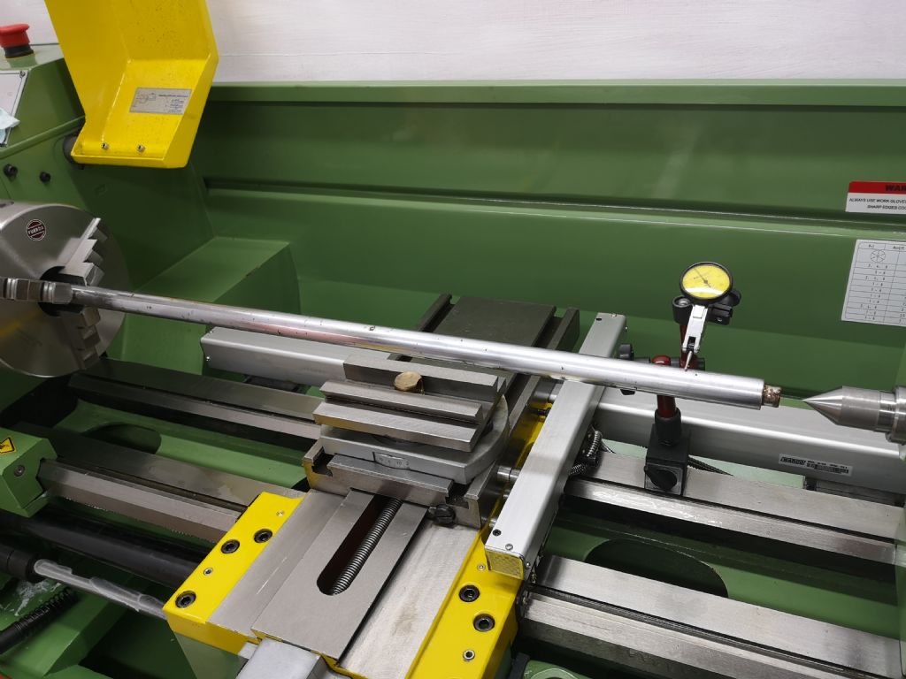

                                  This is what I used when I got my 290V. This is a very straight 20mm tool steel bar almost 30-odd inches long from a scrapped rolling machine. Trueness (is that a word?) looked pretty good to me as it was, using the dial gauge as shown. Pre-delivery had I dug two holes under the floor of my shed 18" square and 18" deep into clay then filled them with concrete, levelling as best I could with a 4' spirit level between them. After running the check above I removed the 3MT dead centre and brought the tailstock left until the bar just entered the taper, then ran the lathe. I could see no discernable runout at all between the end of the bar and the taper – a completely consistent gap while spinning, so more than satisfied, but maybe I just got lucky. The lathe itself need not be level as others have said, so you can ignore the horizon, but its constituent parts should be true to each other.

                                      Not sure what you are measuring there. If you are rotating the chuck to get your reading, all it's telling you is either chuck jaw run out or bend in that long, thin bar. If you are racking the carriage from left to right all its telling you is the vertical alignment of the bar relative to the lathe bed, if the chuck is holding perfectly perfectly true and if the bar is not sagging, which it will by by a certain amount. Doesn't really tell you if the lathe bed is set correctly.
                                      If you want to check the lathe set up, try the turning test outlined in the first post but shortened to 100mm as discussed above in previous post. And read through the linked Harold Hall and Myford user manual pages on setting up a lathe.
