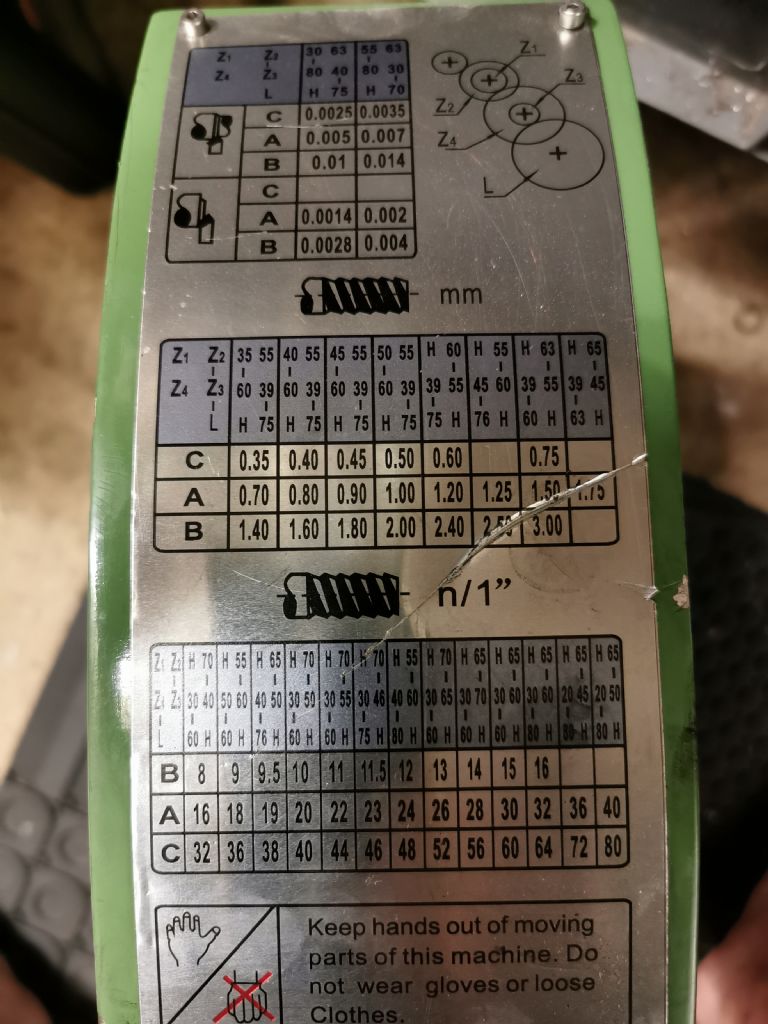

              Bevel
                @bevel
                Back again
                This is the illustration I have on my lathe, in charts quoted by your kind selves there are only 4 gears quoted when mine contains 5?
                My understanding is z1 + z3 are drivers as they are transferring rotation onto other gears but where does this leave L as it transfers rotation to leadscrew?
                Also never fully understood this one either, does it mean I can literally select any point on threading dial to cut these thread ranges? What does Mn relate to and is z =32T referring to the gear on end of leadscrew?
                #553212
                  Posted by Bevel on 08/07/2021 08:56:24:
                  Back again
                  Confusing isn't it!
                  It's to do with how Bevel's particular Imperial lathe is set up to cut metric threads. In imperial mode the lower TPI table shows the expected 4 gears, plus two 'H' spacers. And the same is true of the metric threads on the right of Bevel's table. However, to get some metric pitches, his particular lathe adds a 5th gear.
                  It's a matter of mechanical convenience. Lathe designers have many gear combinations that could be used to generate a particular ratio, and they choose them to comfortably fit in the space available, whilst keeping cost down by minimising the number of gears needed to cover the lathe's design range. Usually, combinations involving very big or very small gears are avoided to reduce wear and tear.
                  My metric WM280 always uses 4 gears to get metric and imperial, and does so without 63 or 127 toothed gears. The designer achieves this magic by suggesting gear combinations that are close approximations rather than spot on. The imperfections don't matter unless very long threads are cut (longer than the lathe can manage!), or are worse than the lead-screw error. (Which is bad enough for precision screws to be ground rather than turned. Lathe cut threads are 'good enough' rather than highly accurate. )
                  Calculating the gear combination needed to produce a particular thread is challenging. (Well, I think so.) The easiest way to do it is to write (or find) a computer program that generates all the possible ratios that can be produced from the available gears and ignore all the unwanted answers. Or sort the list by TPI/pitch and use it to look up the gears needed. The table on a lathe is a much shortened version of the full list. Although the maths is simple (see the various programs mentioned recently), the sums have to be repeated thousands of times. It's too much work for a human unless started by finding a near combination and moving in by trial and error. The second way of doing it, which is more practical for paper and pencil methods provided the maths is understood, involves Continued Fractions. Still tedious, and best done with a computer.
                  Note that although all lathes are similar, the actual implementation varies. Without checking carefully, I couldn't be sure a program written for an Imperial Super 7 was right for my Chinese metric lathe. For the same reason, the tables printed in books, on the web, or on various headstocks are as likely to confuse as clarify. Necessary to swot up I fear to grip the sums. lathes.co.uk is worth a look and various books have already been mentioned.

                      From your picture of the chart on your machine it looks as if to cut a 2 mm pitch thread, the gear train is set up
                      A 55T is compounded with a 50T, driving a 60T compounded with a 39T, which drives a 75T on the Leadcsrew.
                      So the solution was there all the time!
                      Once you have absorbed the content of Martin Cleeve's book, things will be so much clearer and straightforward.

                      Bevel
                        @bevel
                        Afraid not Howard mate if it was that simple we wouldn't be discussing it lol.
                        That is what this is all about in first place I only have a limited number of gears and unfortunately 39T isn't one of them.

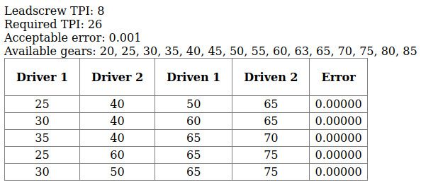

                                      Well, I have done some code-bashing with the equivalent of a gas torch and a large hammer, and the results of my labours may be seen here:
                                      https://u38cg.github.io/geartrains.html
                                      I have run it against Duncan's results and I get the same (note though the results may come in a different order), and I have calculated a couple by hand and agree with them, but of course I can't guarantee it against all the many wonderful ways computer programs can manage to fail.
                                      I would welcome comments and suggestions for improvements – for my own benefit, I intend to add options for a screwcutting gearbox, and perhaps options to enter information in metric form. Would anything else be useful?

                                            Posted by Calum Galleitch on 08/07/2021 22:48:31:
                                            … the results of my labours may be seen here:
                                            I have run it against Duncan's results and I get the same (note though the results may come in a different order)…
                                            I think Calum's offering is the best program so far because it's web-enabled and everyone can try it. Javascript and HTML run in a browser so the user doesn't need to worry about how the magic is done.
                                            I suspect the order of results difference is caused by the incantation that assembles the HTML table. It starts:
                                            document.getElementById('results' .insertAdjacentHTML('beforeend'
                                            Try 'afterend' rather than 'beforeend', or maybe one of the other insert position controls.
