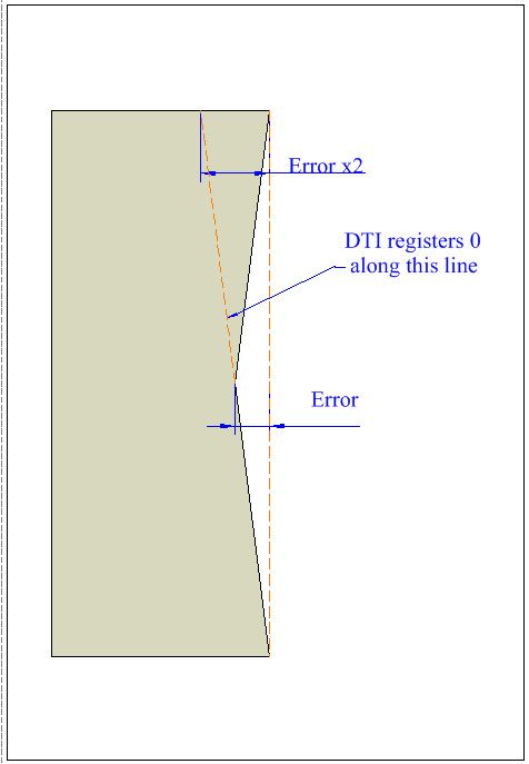

                  #147921
                  Gary Wooding
                    @garywooding25363
                    Posted by Nobby on 24/03/2014 10:18:53:
                    HI Niko & Guys
                    If you faced a large Diameter using cross slide . and it faced a slight angle . running a dti across the face using
                    the same cross slide. surly it would follow the same path ie zero . ?
                    Nobby
                    Quite so, if you only went to the centre; but if you went right across the face, the DTI would register twice the error when you reached the other side.
                    Gary

                          #147967
                          speelwerk
                            @speelwerk
                            If the lathe faces convex you get twice the error plus, halve minus if it faces concave. Another problem is to get a good quality steel rule, I use them for checking straithnes of musical box combs. When I bought several of them of different length and asked the question what the accuracy was, they where not able to tell me. Niko
                            #147977
                            speelwerk
                              @speelwerk
                              You can clearly read that I have never checked it myself, it should be of course plus twice for convex and minus twice for concave. Niko.
                              #147983
                              John McNamara
                                @johnmcnamara74883
                                Hi All
                                Twice the error?
                                Not really…..You are stopping in the middle of the piece if you are cutting a test disk. The error is simply the error along the radius.
                                Regards

                                  #147985
                                  Clive Hartland
                                    @clivehartland94829
                                    What I want to know is how all this will affect the 2mm step on the shaft that I am making? After all most of us only have a model making lathe of approx. 3.5" swing and seldom cut big diameters. I can see that as a test it can prove something so that remedial action can be taken. 2 x the error, its concave or convex and measurable as an error surely.
                                    Clive
                                    #147986
                                    Gary Wooding
                                      @garywooding25363
                                      This explains it.
                                      Gary
