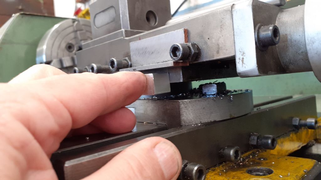

          I would not use the tee slot in the cross slide to fix the read head, what happens when you want to angle the compound to turn a short taper or when you want to move the cross slide further in along the cross slide?
          Better to fix to the lower half of the cross slide, either into the edge or more likely the underside.
          Also don't forget being able to get to the compound lock screw if the 290 has one.
            Good point which will will apply to any situation where you may want to fix a scale. Perhaps I stick to using the magnets for the scale and sensor mounts, then I can lift it off? Although on T bolts it can still be slid. I underestimated how big a 100mm scale actually is. The sensor head is around 60mm long enclosing the reader electronics, far too big when the electronics could be much smaller and they could have got them in a smaller box. As it is and they are all the same, overall length required to measure 100mm is nearly twice when you include the scale end mountings cheeks.
            Thanks, I'll remove the guard fixing and have a look to see if my scale will fit the nearside. Is my lathe with the 'fine' handwheel control different to others because of the compound slide? My saddle traverse isn't just more coarse, but has more backlash compared to the compound traverse.
            One thing I noticed was my toolholder can take up to 16mm sq. tools. However, with a 12mm tool In the holder I can only just get below the chuck centre line and a 16mm tool cutting tip would sit above centre (!). When the tool height is set at its lowest for a 12mm tool, it can't go any lower, unless some parts of the compound are altered.

                      A mini magnetic scale and head only need 14mm x 14mm

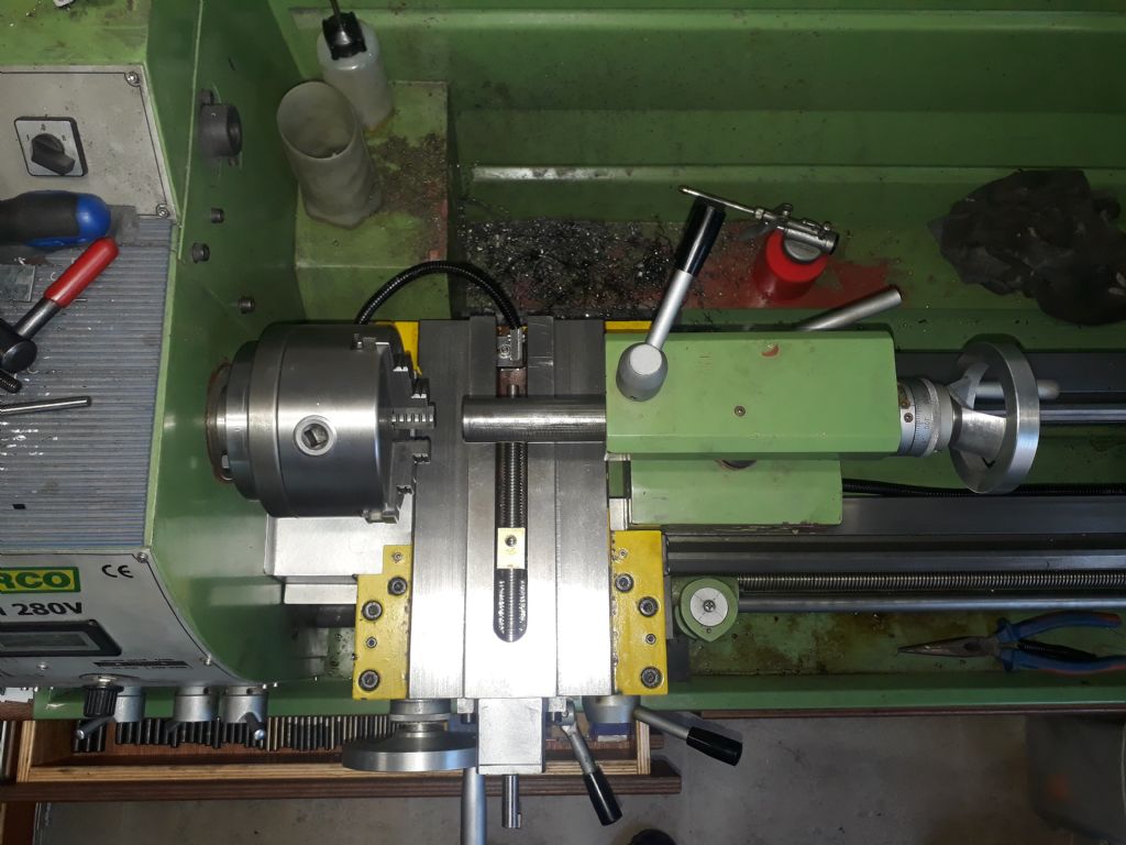

                                      My DRO shows X for saddle and Z for cross slide, but to change or set Z I have to press the Y buttons. I think they were as confused as me.
                                      When I first had it I mixed up the X and Y plugs causing weird readings because the Z is a 5 micron scale while the X is a 1 micron scale. Nothing about that in the manual. I rang up and asked how to get into the settings and change it but they didn't seem to know or didn't want to tell me. The answer was to hold down the ENTER key while turning it on at the plug.
                                      Where the cross slide DRO is fitted it removes 30mm travel from the tailstock which is fast running out of travel on the graduated part, whatever that calls itself. The nose? It cannot stay there, I am working on moving it.

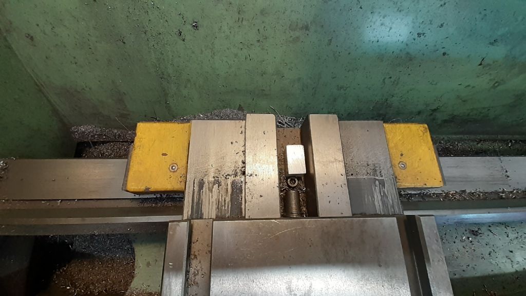

                                        The reason for the 1micron scale on the cross slide is that as it measures radius your diameter could be double any error so 10micron if on the 5um scale was used.
                                        I think magnetic strip and a mini head from M-DRO under the cross slide like ChrisB is the way to go.
                                        As for how a scale could be mounted to the topslide, I would fit a piece of angle to the moving part, this could be fixed with a couple of M3 CSK screws and drilled to clear gib screws or you could make use of the locking nuts on the gib adjusters to hold it on. Stick tape to underside of angle. The head can be screwed to the side of the base or to a plate screwed to the underside. Whole thing sticks out no more than the gib screws and you are free to rotate and slide the topslide to where you want without having to alter mountings.
                                        Quick mock up, head is actually a bit flatter.
                                        Also room for the 10mm x 12mm head at end of leadscrew (its longer than my block) and a cover/extension at the back again like ChrisB and JS did

                                          Had a look at the compound slide this morning and I can confirm what Jason says, that's the best place to install the read head. As to do the installation internally in the compound, it is impossible with off the shelf read heads.
                                          Posted by Robin on 19/04/2021 23:36:19:
                                          That's why it's better to have the DRO installed under the crosslide if possible, but that depends on what type of read out you have, my guess is it will only work out with magnetic type due to their small size.

                                            My toolpost is much too wide. See how the top slide is angled back, but the tailstock still only has 1 cm extension left to go. 'tis a puzzlement.

                                              Same as my 290V, the cross slide is fairly wide any way & a DRO either side causes 'issues'. Just looked at a Emco Maximat lathe which the Warco lathes are I think clones of and the tail stock front has loads more over hang where the barrel is so you can get nearer the chuck with drills, centres etc.

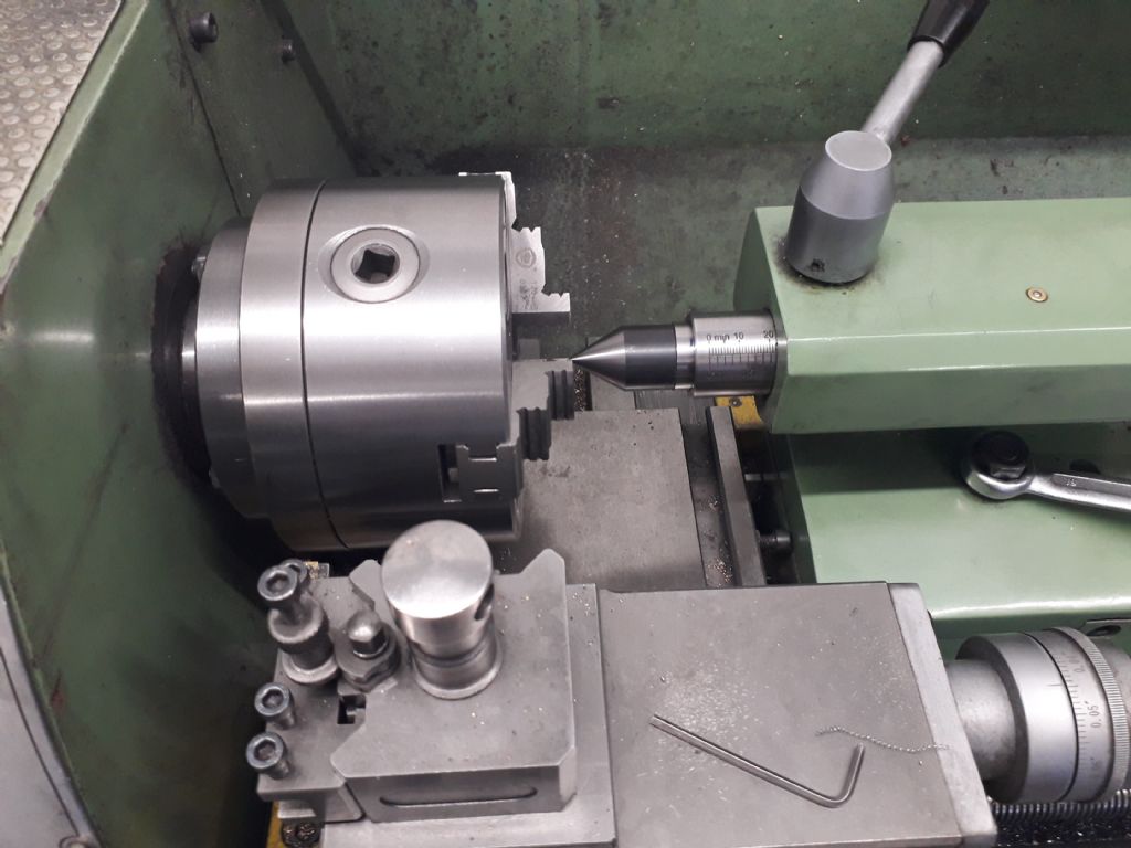

                                                This the closest the tailstock will ever come to the chuck on a WM280 lathe. Adding a dro to the right of the cross slide will only make it worse. You could mount the dro to the left, but that will expose the scales to oil, swarf and possibly impact damage.
                                                Mounting under the cross slide as Jason suggested will avoid all those issues and tailstock reach will be unchanged.
                                                #540752
                                                  Posted by ChrisB on 20/04/2021 19:17:10:
                                                  Unless it's an early model like mine where the carriage can move further to the right and touch the headstock smiley
                                                  Not sure if a lack of stick out is classed as willy waving or notsmile o

                                                    How come Jason! Mine won't go any further as the saddle will contact the feed shaft clutch.
                                                    #540767
                                                      Shear pin on mine. Also no Leadscrew spring cover or boxing sticking out the back where the motor goes.
