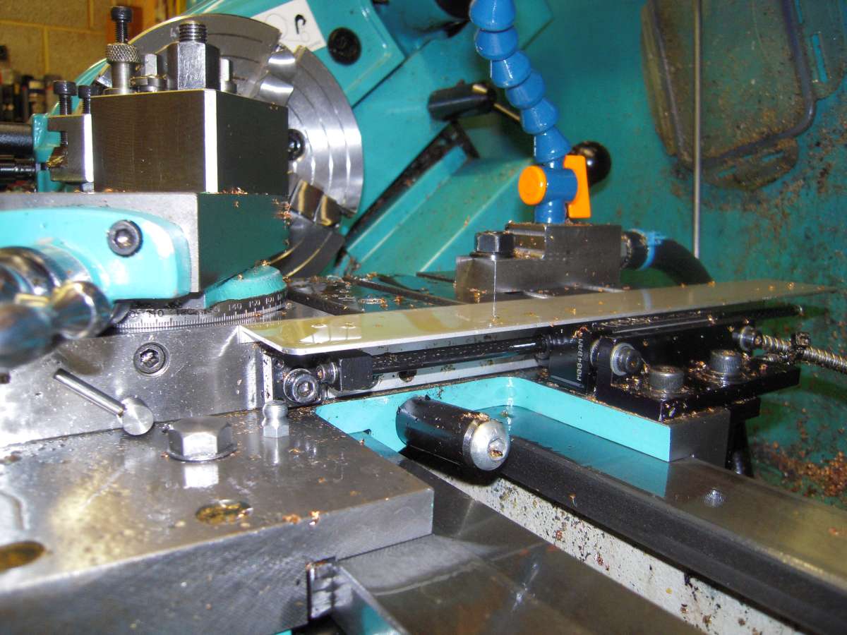

            I bought a new Myford lathe from the old company about 12 years ago fitted with their DRO arrangement. The actual DRO is industrial quality, Newall, and the whole system has been very reliable. However the installation is a bit of a bodge. As mentioned the longitudinal scale uses the fixing holes for the taper turning attachment which is a nominal inconvenience since I have not had to use mine since getting the lathe (and if I had to I would probably use a friend’s lathe). The cross slide scale is bolted to the slide and has a simple swarf guard. A bump stop is fixed to the carrage to prevent the tailstock from smashing everything.

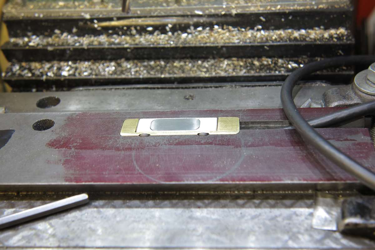

                I fitted the inside version as its neat and allows all your other tooling that you made in the past to be continued to useIMG_5337IMG_5341

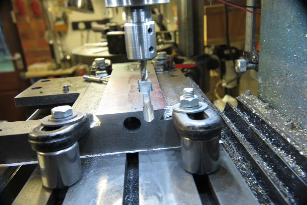

                  Another vote for the M-DRO magnetic scales with one strip embedded in the crosslide. Straightforward to mill the groove for it, I think I lost some crosslide travel because the read head obstructs the leadscrew when the crosslide is wound in, but not really a problem.

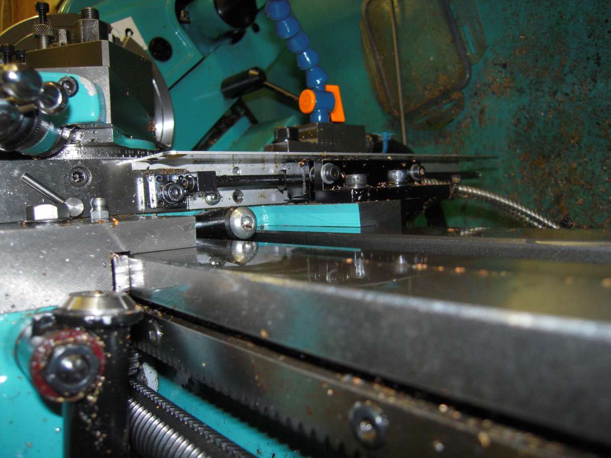

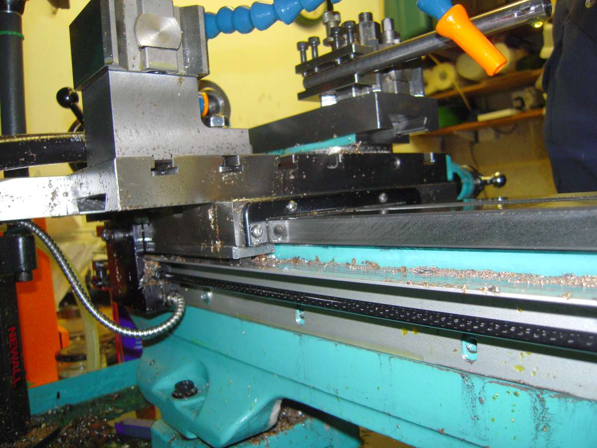

                  #700991
                  JA
                    @ja
                    As promised.
                    DSCN0008
                    Bump stop to protect cross slide sensor
                    DSCN0005
                    Cross slide sensor
                    DSCN5462
                    Saddle sensor

                        I went for milled. My first milling project… I messed up!
