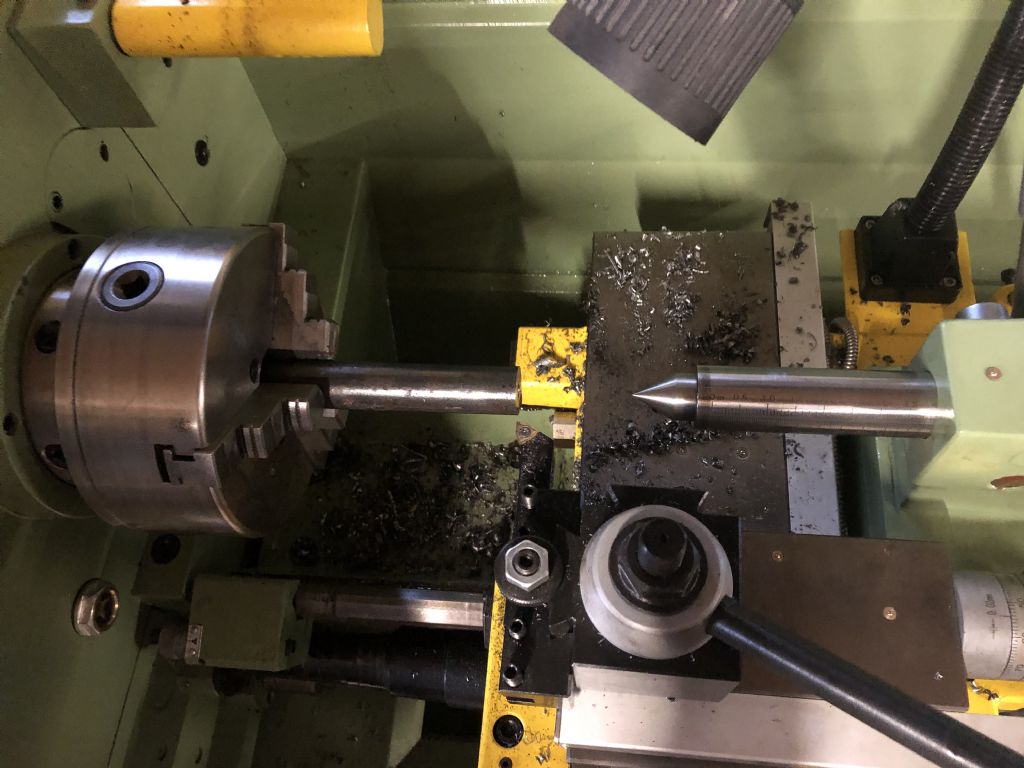

      Hi all,
      i have what is probably a very stupid question. I have a Warco GH1236 lathe and I can’t get the dead centre close enough to engage with the workpiece. Even with the tail stock fully extended it is about 60mm too far away. I can’t slide it any further forward as it is prevent from moving further forward by the saddle. It does not help that the DRO reader is on the side of the saddle and restricts how close the tail stock can get but even without this it would fall short. If I move the saddle forward I am unable to machine to the end of the workpiece.
      i have attached a picture to show the gap. Here the tool is positioned so as to be able to machine from the end of the workpiece allmost right to the Chuck. While the photo seems to some a bit of a gap between the tail stock and the saddle this is as close as it gets.
      Any help would be greatly appreciated. Is it possible to get a longer dead centre or an extension?
      Thanks
      Sacha

          That's an easy one to solve if you have spare length in the workpiece. Turn your toolpost through 180 degrees and mount the holder on the right side and have the tool poking out the other end. A revolving ctr will also help as they are longer than dead ctrs.
          You may also need to angle the topslide so the handle end does not foul the tailstock

            Hi you can get an extended revolving center which will help and if you wind the compound slide to the rear which will get you a bit closer and if you either rotate the toolpost to put the tool in the right hand side you should get to the end of the job. Try some of these or all.

              Can the QCTP be moved across the top slide? Turning the top slide by 90 degrees may be necessary.
              Your tool geometry appears less than optimal – the cutter would be far more rigid if it were over the centre line of the cross slide. Every bit of cutter overhang causes extra flexing under load.
              JB has several options. Turning between centres might be another option to gain space at the headstock end
              Extending the tail stock centre, while a possibility, is not particularly recommended – any extra extension cannot be seen as aiding accuracy – but needs must…
              The most obvious move would be to start with a longer workpiece and not machine right to the chuck? Same with turning between centres.
              Another alternative is to make/buy and fit a ‘lantern type’ single-tool holder in place of the QCTP. QCTPs are good, but not perfect in all scenarios.

                I had the same issue when using my warco gh600 for the first time. I found that setting the compound to 45 degrees (which means rotating the toolpost the opposite 45 degrees to compensate) has the effect of moving the cutter forward and to the right. This gave me just enough room to engage the dead-centre without running into the carriage with the tailstock.
                Obviously this isn't helpful if you're trying to use the compound for cutting tapers or the like.

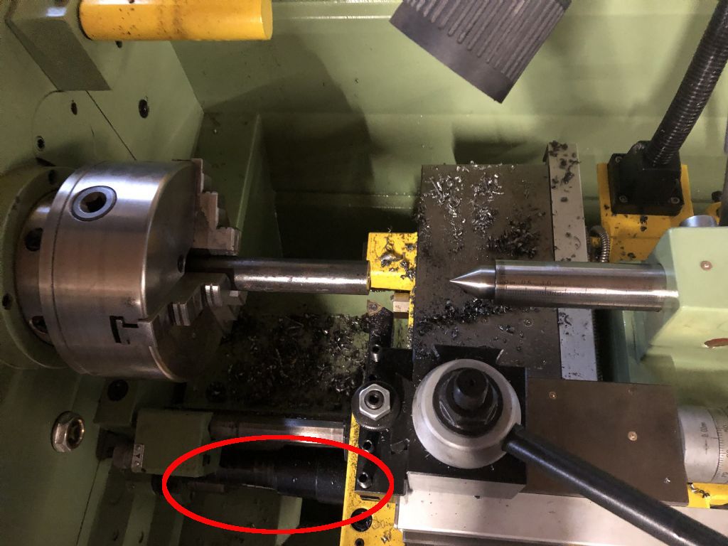

                  Removing the telescopic swarf guard from the leadscrew is another possibility. Even fully compressed they take up a fair amount of space, and stop the saddle getting as close to the headstock as it might.
                  Whether the guard's worth removing or not depends on how often the obstruction is a problem in practice, I've never had the need myself, either the work is long enough, or Jason's method  does the job.  (Easier for me because I have an ordinary 4-position tool post rather than a QTCP.)

                    I have the same problem, with the digital readout cover effectively making the cross slide quite a bit wider. It has been a constant frustration, but the acquisition of a second lathe largely solved the problem. There has never been a situation where switching the tool to the RHS of the toolpost has solved the problem, but angling the topslide away helps some.
                    #423230
                      I suppose you could always unscrew the scale for the odd occasion when you need that bit of extra length, I done that on the mill when pushing it to the limit of it's capacity.

                        I had the same problem with my Warco 285; I moved the DRO to the chuck side of the saddle, a bit of work but definitely worth it.

                          I had the same problem on my Warco 1224 and to over come it I simply turned the top slide to 45 degree and re aligned the QCTP to be square to the work – this allows the saddle closer to the chuck and get the tail stock closer to the work
                          I also had to grind a 45 degree chamfer on the tail stock casting to get the top slide to travel where I needed it to be

                              Morse taper extension sleeves can be got for around £15. For practical purposes one would move the centre along by the nominal length of the morse taper. Almost worth considering as a normal fit if you aren't seriously restricted by bed length as it would let you work with the tailstock barrel well retracted for much more of the time. When well extended tailstock barrels on smaller machines are less rigid than one might ideally desire.
                              +1 for the suggestions to alter the coss-slide angle. Mine lives at 25° as its suits the zero 2 zero thread cutting method. Other folk swear by 30° as the infeed is half the slide travel making tiny cuts easier. Needs a razor sharp tool tho'.
                              With a DRO system there is little need to have the cross slide parallel to the bed for controlled longitudinal cuts as the DRO tells you where the saddle is. Although the saddle hand wheel is less precise to handle than the cross slide feed screw a bed stop makes it easy to hit the same point each time. A bed stop doesn't need to be fancy. A simple block nipped up so it slides stiffly on the bed can be pushed into position by the saddle (with the tool well clear of the work) and locked up when in the correct place. A micrometer plunger makes life easier but half the time I don't bother with the micrometer on my single stop. Just use it as a dumb block.
                              A short screw driven fine adjuster plunger does make a stop block usefully easier to use as you can quickly get it close, move the saddle to just so and screw the plunger up against the saddle. A calibrated scale isn't important with a DRO around so any decently hefty fine thread will do. I often use 1/8" BSP for such "shift it a bit" setting screws.

                                Two ideas:
                                Wind the compound slide back to the left.
                                Consider using a rotating centre.

                                  As already said, rotate the Toolpost, remove / reposition any guards / DRO.
                                  Keep everything as short as possible, to maximise rigidity.
                                  Use plenty of grease on the dead centre.
                                  Having had a bad experience with a rotating centre with brinelled bearings, I minimise use of the new one, unless absolutely necessary. But that is just me being over cautious!

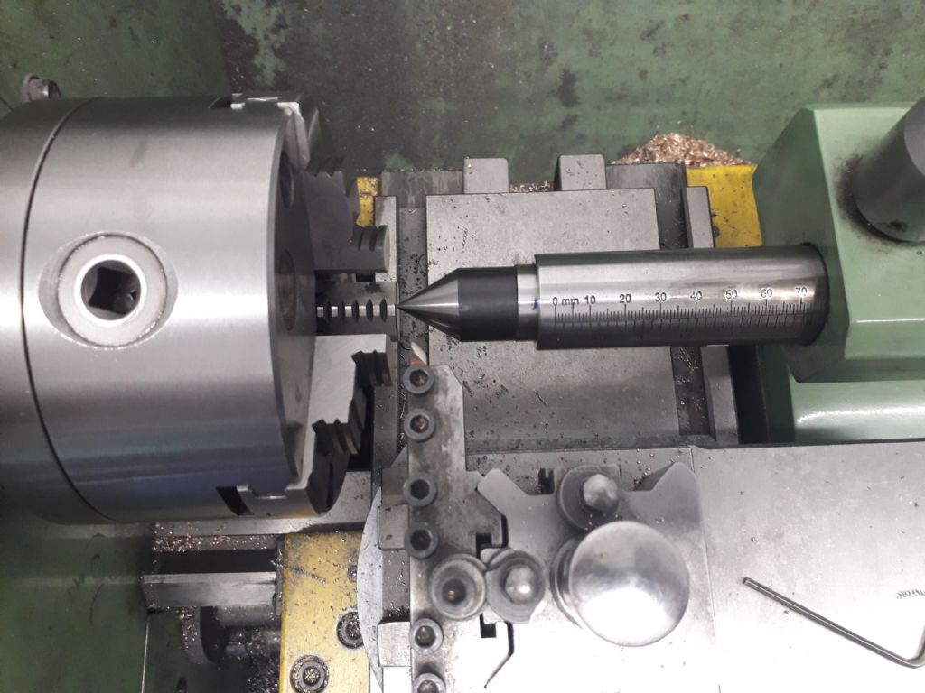

                                                Just tries an experiment with my GH600
                                                With the top slide fully to the left as Neil suggested and the tailstock extended to 80mm a fixed entre is within 50mm of the chuck jaws.

                                                    Put Brain Cell in gear ( does not happen very often !) and repeated my earlier experiment. With the top slide wound fully to the right the centre can touch the chuck with no problem
