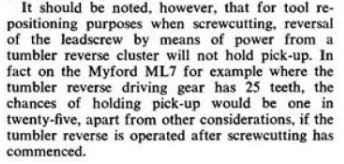

                          Just read some of the Cleeve article and it does stay engaged but hardly "nothing elaborate" as Ian suggested as you would also need to make a leadscrew handwheel to return the carrage.

                              It's a single-tooth dog-clutch' so it doesn't matter how you return the carriage.
                              Cutting and modifying the leadscrew is, of course, 'non-trivial'

                                #388613
                                  Cleeve article seemed to suggest that if you used the tumbler reverse to return the carrage you had a 1 in 25 chance of picking up the thread in the same place.
                                  Although Chris' machine does not have a tumbler reverse, use of the head gearbox reverse would have the same effect as above as the gears could remesh in any position.
                                  Edited By JasonB on 01/01/2019 07:12:03
