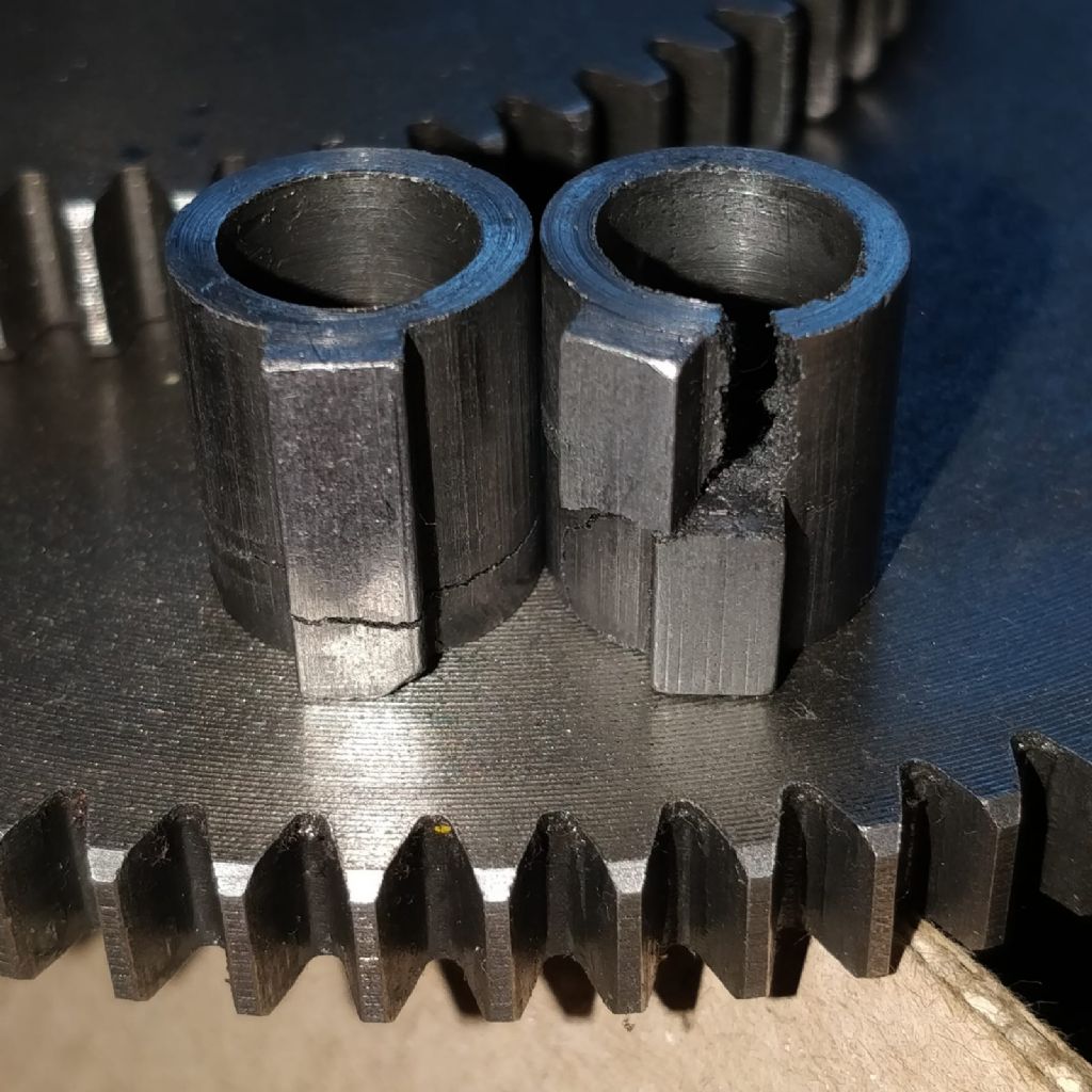

      As you say they are too close a fit to fail by expanding but if sintered as some are saying I suppose the material could compress.
      I think you will find they are 1.5MOD gears.
      #387876
        Posted by ChrisB on 27/12/2018 20:06:37:
        I get where Michael's coming from, it got me puzzled as well, the bush fits tight on both shaft and gear…but…when I put the bush on the gear and the shaft on the bush, there seems to be a piece missing …
        My guess [and that's all it can be] is that "the bush fits tight on both shaft and gear" now … but it was originally loose in the gear.
        It would probably be useful to measure the diameter of the hole in that gear.

            I see what you mean about the shearing action JB. The obvious comparison to make is with a new/surviving one to see what the original dimensions should be.
            #387895
              Chris has already said that they are a tight for to the point of having to knock them in, which is similar to mine which are all a firm push fit and if you pick the pair up by one gear the other stays put. You could not do that with a hole that is 0.3mm oversize plus the gears would be rattling about all over the place and the key would soon fret and wear.
              Michael how did you get your 2% oversize? I would have said the gap is about the same as the wall thickness of the bush at 2mm so the circumference of the bush would need room to increase by that amount so nearer 4% oversize or a 14.6mm hole for a 14mm bush.
              Edited By JasonB on 28/12/2018 07:24:52

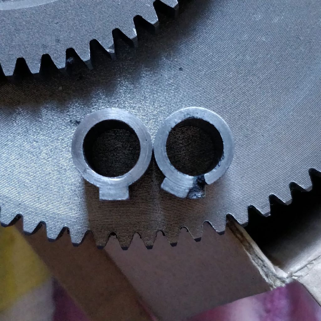

                    Hole in the 80T gear is 14mm, same as on the 63T gear. No detectable difference using a manual vernier caliper ( it's too cold this morning to go to the workshop and fetch the micrometers!)
                    The one remaining serviceable bush is a hard push fit on both gears, so I'm ruling out the gears being that much different from each other, if there are difference it will be in the order of a thou.

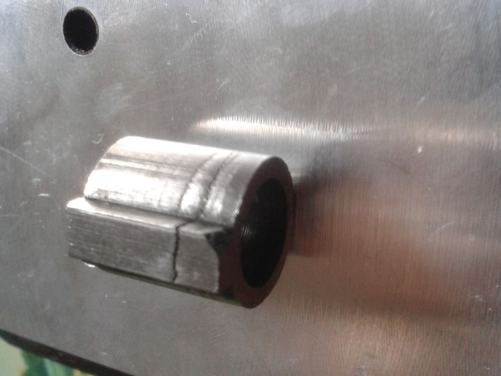

                    The thing I' cant figure out is this ; the cracked bush has a gap approx 2mm wide (see photos above), but the internal bore (10mm) and external dia (14mm) is exactly the same as the undamaged one.
                    So we have either broken Einstein's law for conservation of energy surprise or somehow the material compacted itself, sort of collapsed – which might make sense if the bush is made from some sort of powdered bearing material which would have voids for holding oil.
                    Edit: Michael, yes on some it is a slide fit, but with no play, so it would be more appropriate for me to say a push fit as the bush will not drop into the gear without me helping it. Sorry for the confusion!

                        #387904
                        ChrisB
                          @chrisb35596
                          It's not a case of right or wrong Michael, I can understand your difficulty trying to understand someone who's 2000miles away showing a couple of photos and some misleading text! smile p
                          If I manage to get behind what's going on be sure I'll share it…but I honestly don't know.
                          Moving on I'm going for fixed pressed in bushes on all gears and dowel pins on the faces of the gears. Should I have a repeat of the mash up I had last week, the dowel pins should shear, which will be much easier to fix.

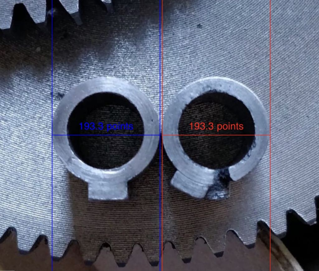

                            Posted by ChrisB on 27/12/2018 18:01:21:
                            For my education, Chris …
                            could you please post a photo of the good bush, for comparison with that one ^^^
                            … perhaps I misunderstood the design !?!
                            Thanks

                              Posted by ChrisB on 23/12/2018 09:19:10:
                              dont know … I've obviously missed something
                              #387910
                              ChrisB
                                @chrisb35596
                                There you go, they are both damaged, one is just cracked at the bottom end but otherwise the shape is same as the original. The other is twisted through roughly 30deg
                                #387914
                                  Thanks for that, Chris yes
                                  … I was beginning to think I was losing my marbles.
                                  After a quick measure of the image …
                                  Yes, I'm convinced that the material must have been compacted surprise
                                  Edited By Michael Gilligan on 28/12/2018 09:24:03

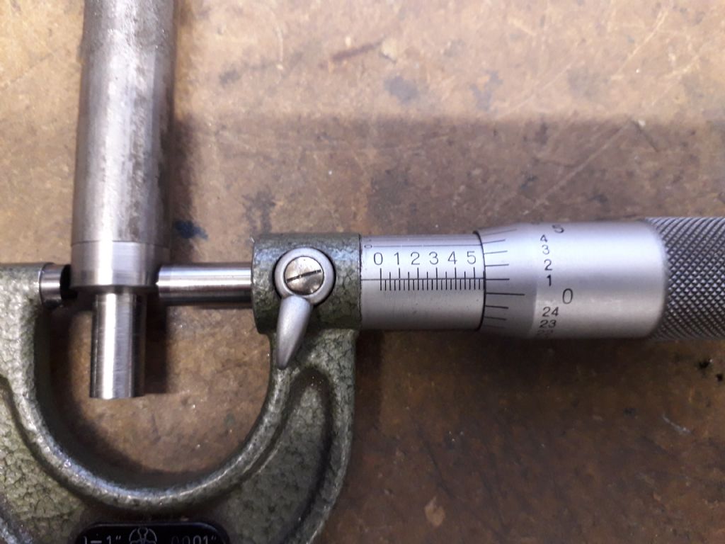

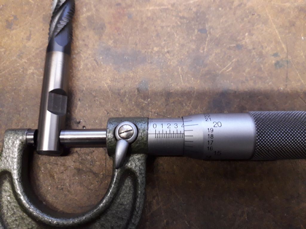

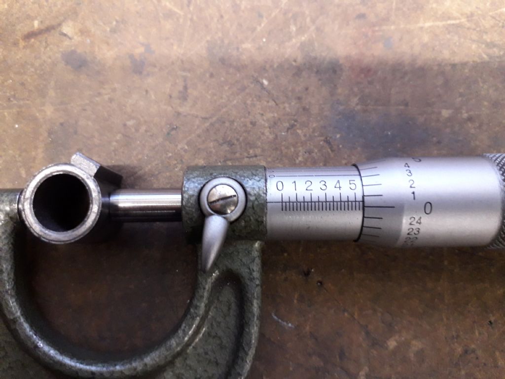

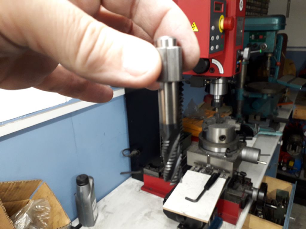

                                      Well I braved the workshop and even though it is not up to controlled lab temperatures took a few measurements anyway
                                      Bush OD, tried in several places and got readings between 0.5503" and 0.5506" ( 13.978mm to13.985mm) suggesting slightly oval.
                                      ID of bush I did by slipping it onto a 10mm cutter shank which needed a push and it did not drop off.
                                      Shank of tool measured 0.4935" (9,9949mm)
                                      To get an idea of the internal diameter of the gears I turned the end of a bit of bar down to a firm push fit
                                      Turned end of bar measured 0.5512" ( 14.0005mm). There was a fractional taper to the bore as I could slide it on part way before it tightened but if entering from the other side it was tight, bright area is where it has rubbed the surface.
                                      So average clearance of 0.019mm which puts it mid way between the upper and lower tolerance limits I posted earlier

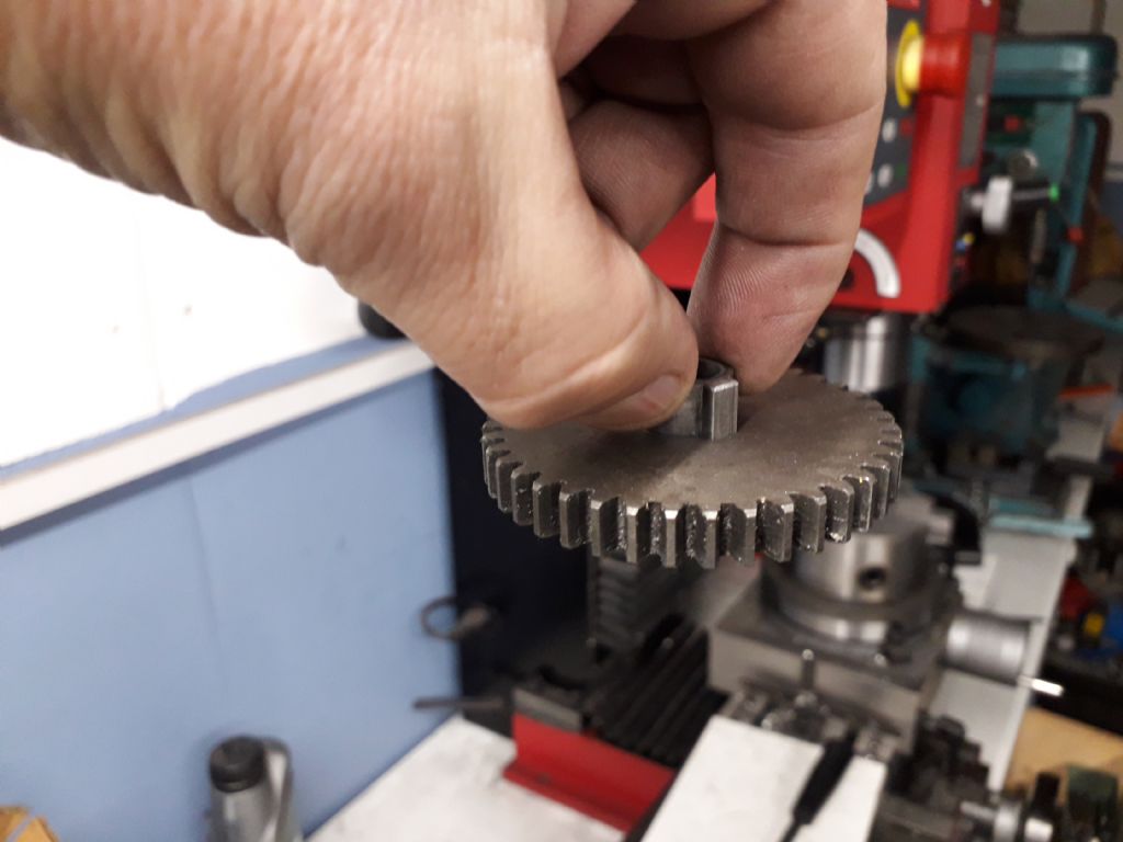

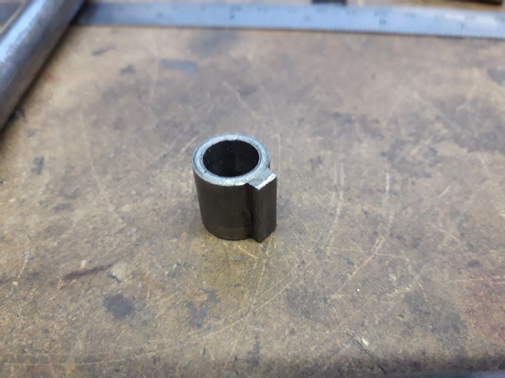

                                      Pic of an unmolested bush. The small chamfer you can see at the end of the "key" was filed by me so they are not hard and do seem to have a granular look to them
                                      Typical fit of bush in gear which were pushed together by hand with little effort
                                      20181228_084115[1].jpg.

                                          I would also hazard a guess that those bushes are made from sintered (powder metal) steel.
                                          One of the characters of sintered steels (and there are many) is that they have a degree of self lubrication, like Oilite, so would be ideal in this application; and another is that they have a degree of porosity, and that would allow the apparent compaction in torsion shown in the photos.

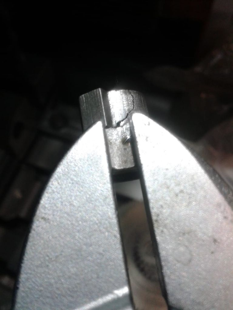

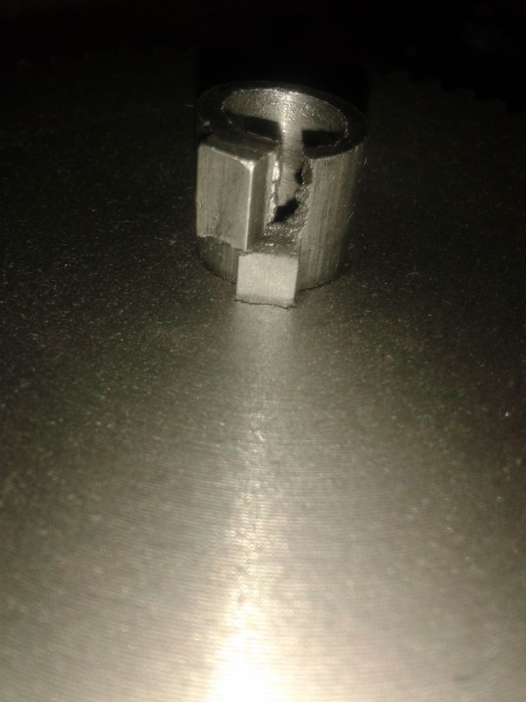

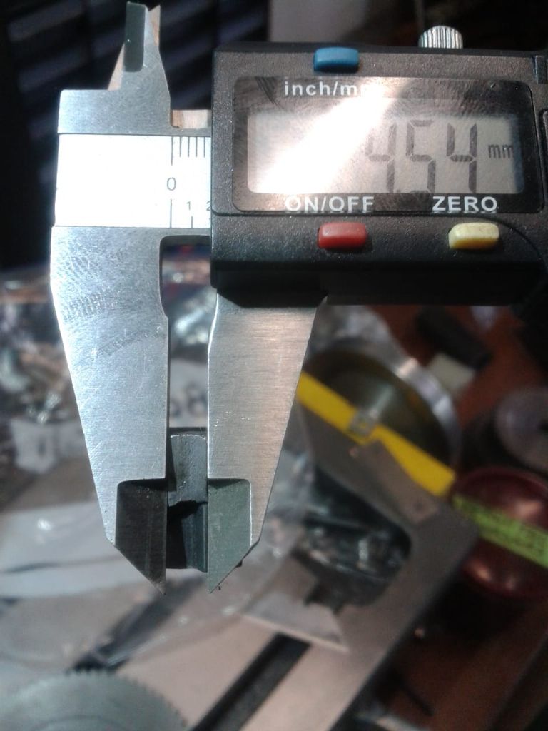

                                            You're right David, they are indeed sintered steel. Gave it a try on the grinding wheel and it emits yellow sparks. Then tried to squeeze the key with a plier and to my surprise it did give way – some oil oozed out from the surface.
                                            A quick dimensional check showed the width reduced 5mm to 4.5mm – so that's the mystery solved I think.
                                            Now that I ordered the new bushes I still think I have not resolved the problem as most probably the same will happen. Maybe I'm being too aggressive with my depth of cut when turning? What do you guys consider the max for the WM280? 123.jpg

                                              I doubt it happened when cutting, more the result of your jam up. I have cut 0.25" (1/2" off diameter) in steel so they can take a decent cut though generally don't go that deep say 2.5mm roughing.
