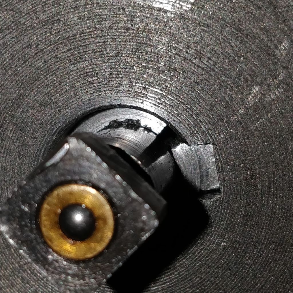

                    This morning continued the thread cutting project I was on before the lathe crashed, finished turning a left and right hand M16x1.5mm thread and started preparing the change gears for cutting two M16x2.0mm threads. On taking the gears off I find this face 5 :
                    Another broken bush!
                    So now I'm left with only one serviceable bush… I 'm not sure if it's me who's doing something wrong or if the material is either too weak or I had a defective batch. I have two spare bushes on order – something tells me I should have ordered more!

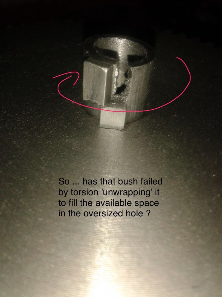

                          Posted by ChrisB on 27/12/2018 13:34:38:
                          Jason … At first sight ^^^ it looks like ChrisB's bush was loose rather than tight, in that 80 tooth gear.

                            Aren't these supposed to be a close sliding fit rather than needing "pressing"? I'm struggling to understand what forces in a jam up would cause this level of destruction in a bush. I imagine teeth would fly from the periphery of the gears before this item disintegrates.

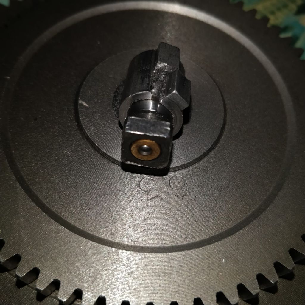

                              I suppose you have one of the pair of gears being driven and the other is stopped from rotating by the carrage against the headstock there will be a very high twisting force as one gear wants to turn and the other does not. If the teeth are stronger than the bush the bush will fail.

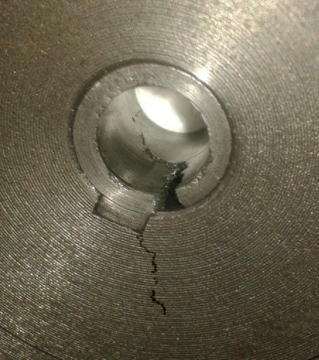

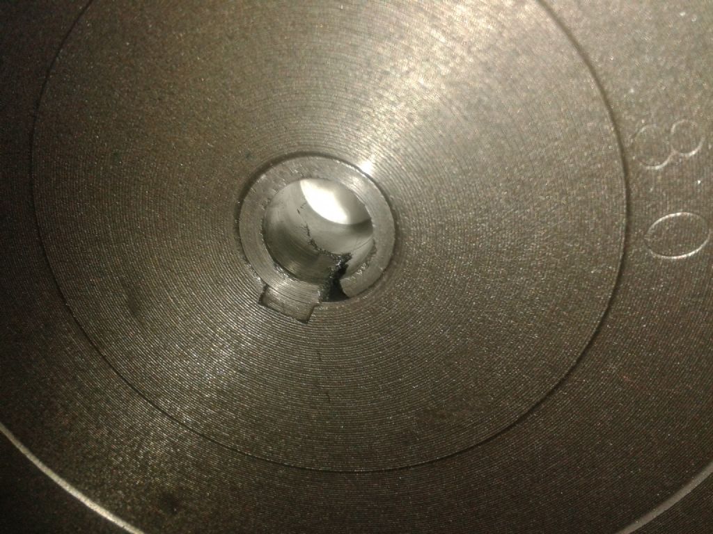

                                I hope I'm imagining it but has the gear cracked too? Enhanced by me and could be wrong:
                                Original:
                                I half remember a trick using petrol or other light oil for highlighting genuine cracks. Soak the suspected area in petrol, wipe dry immediately, then watch to see if anything emerges from the crack. Have I got that right or is there a better method?
                                Having crashed a WM280 lathe myself I can confirm that the forces involved can be considerable. First time was nothing to write home about. Second time was far worse. So violent I replaced my steel shear pin with a brass one to break faster and am neurotic about not doing it again …

                                  Nah, the gear is fine, the damaged parts I found so far are two bushes on the change gears and the shear pin on the lead screw. Although the shear pin failed I find it strange the bushes failed as well…I have now replaced the brass pin with an aluminium one.
                                  The bushes fit tight on some gears and slide fit on others, so it's a bit of a mash up honestly. I'm of the opinion that the material for the bushes could be better, but then again, it's a low cost hobby lathe so I cannot expect much better.

                                              No, I would say it has failed because one gear was turning as indicated by the red arrow while the other was stuck solid due to the carrage being jammed up against something solid. Think of twisting an Oreo in half

                                                So … how does the gap appear ?
                                                #387867

                                                  I get where Michael's coming from, it got me puzzled as well, the bush fits tight on both shaft and gear…but…when I put the bush on the gear and the shaft on the bush, there seems to be a piece missing – almost as if the material has shrunk or collapsed into itself ! There are no missing fragments and the split ends match perfectly together. Have a look at the photos below and try to decipher what happened because I cant!

                                                    Looks to me that S O D is right, and the gear is cracked, from the corner of the keyway.
                                                    Either you are in the market for a 80T gear, or a Rotary Table, a set of Division Plates and a No 2 Gear Cutter to suit the gears on your lathe, (either DP or Module).

                                                      I'm 99.9% sure it's not cracked. For peace of mind I'll do a penetrant test when I'm back at work next week as described by Andrew above – I'm sure it will be negative.
                                                      That said, rotary table and plates are on the way, as well as a set of mod 1.5 gear cutters wink 2
                                                      Edit 1: what you're seeing at the key slot corner is a scratch on the surface – in the photo it may lead you to believe its a crack.
