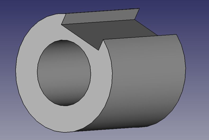

          I've wondered about replacing these, not because I've ever broken one, but because I often drop stuff on the floor and it disappears for 10 years.
          If not available as a spare, NDIY may have meant silver solder as a way of making one from scratch:
          1. Turn and bore the round part of the bush to size (easy)
          2. Broach an outer groove. (bit fiddly, but can be done in a lathe)
          Then make the rectangular key. Easy on a milling machine, a craftsman could file one by hand, and it could also be made by facing on the lathe. The main problem on the lathe is holding a small part.
          Finish by silver soldering the key into the round part. (This might not be mechanically necessary but I would lose a loose key in seconds.)  Loctite might do.
          Edited By SillyOldDuffer on 23/12/2018 10:37:34

            Yep, he said making or purchasing, not repairing.smiley silver soldered because the slot might not be deep enough, but, as you say, loctite might do.
            #387278
              No real problem to machine from solid if you have a rotary table.
              No problem holding it to cut a groove if you cut teh groove while it is on the end of a big lump of bar, just start the parting cut to give the tool some runout space, plane the groove and then part off
              What can't be seen in the photo is that there is not going to be much metal left when the slot is cut so in the event of a jam the solder may fail and you will split the round part from one of the internal corners down to the bore.
              Should be an extra one in the toolbox anyway, there was with minesmiley

                        The other problem you may find with soldering will be when you come to harden the fabricated part. Don't think I would want to leave them soft as they are spinning all the time at quite high speeds.

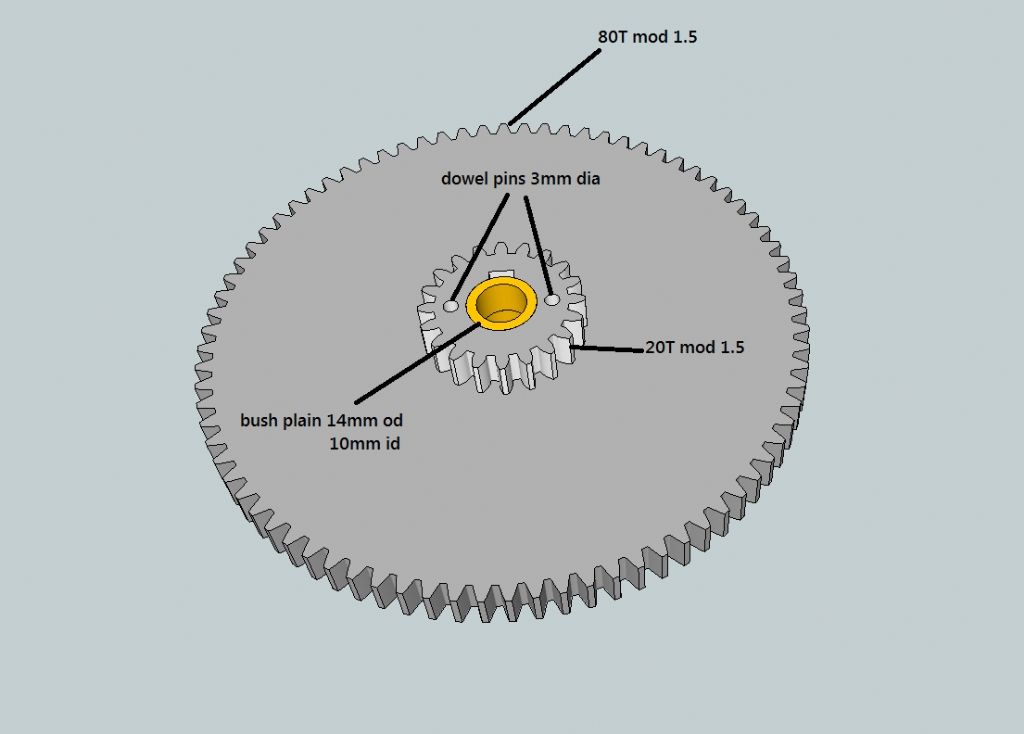

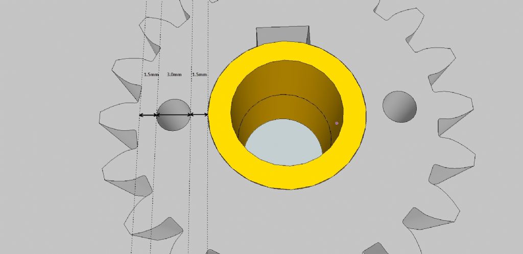

                          Let's see if this might work. If I had to eliminate the keyed bush completely and instead put a bronze bush on each gear. Then to stick a pair together I would use two dowel pins (push fit) I reasoned that two 3mm pins will have the same shear surface area as a 2x5mm key (that's what the keyed bush has) so they should in theory hold.
                          I tried some sketching – the largest and smallest gears I have is 80T and 20T

                            My 14DP 20 tooth gear was driven, or drove, by one pin of about that size. All the drive train gears were fitted with one pin – either 3/32nd or 1/8th. Little more space, but could be 3/16th, possibly – but there was not a lot of space between hole and root of teeth.

                              Or file the underside of the key to fit the circumference before silver soldering to avoid making those stress concentrating internal corners.

                                  There's not much space to machine a slot for a key on the bush, Neil. The bush is 14mm od and 10mm id so with 2mm wall thickness to play with there's not much one can do…I think.
                                  Will, it's silverish grey in colour so I'd think is something ferrous, will touch it with a grinder and see what spark (if any) it will give off, should give an indication.
                                  I'm tempted by the pin approach, – just in case I come to need them, any one knows where I can get mod 1.5 gears at reasonable prices? Warco does not list them on their web shop but I'll ask.

                                      The shear pins sound a better bet.

                                                  You could silver solder the key in place, then bore it out.
                                                  #387385
                                                    Chris, how would you subsequently harden the soldered part?
                                                    Suppose it could be wire sparked, I'll did one of mine out later and have a look and tickle it with a file.
