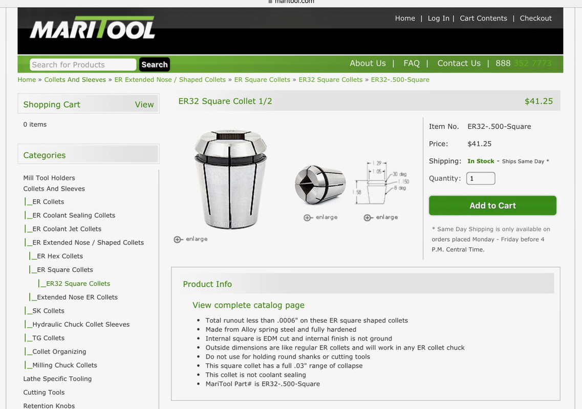

                                Tony Pratt 1
                                  @tonypratt1
                                  Looks like you can get some hexagon and square ER collets in the USA from 'Maritool'.
                                  Tony

                                        Posted by Tony Pratt 1 on 02/05/2023 09:35:42:
                                        Tony
                                        Oh yes! Bit speedy though. Come on Ketan, get some made up and on the website! 😆

                                          #643702
                                            They don't hold square stock. Most of the gripping area is round and just the back end square so that there is no risk of a tap slipping when doing rigid tapping in a CNC machine
