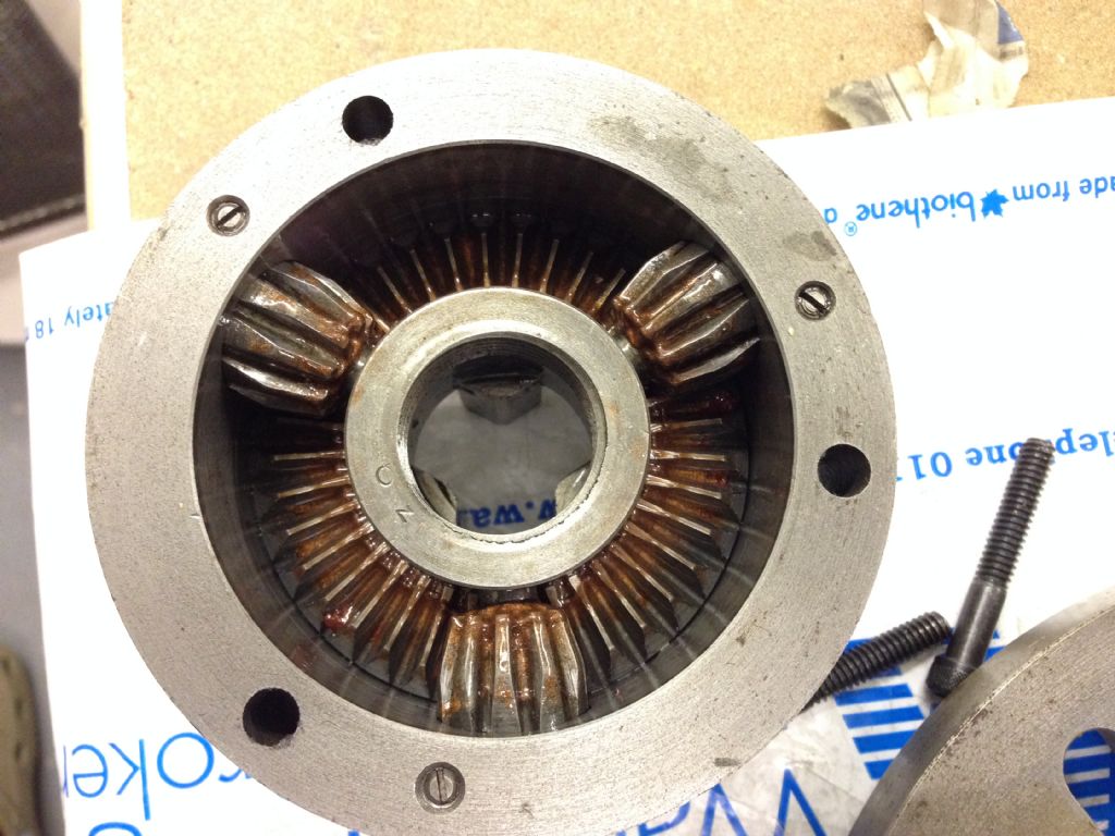

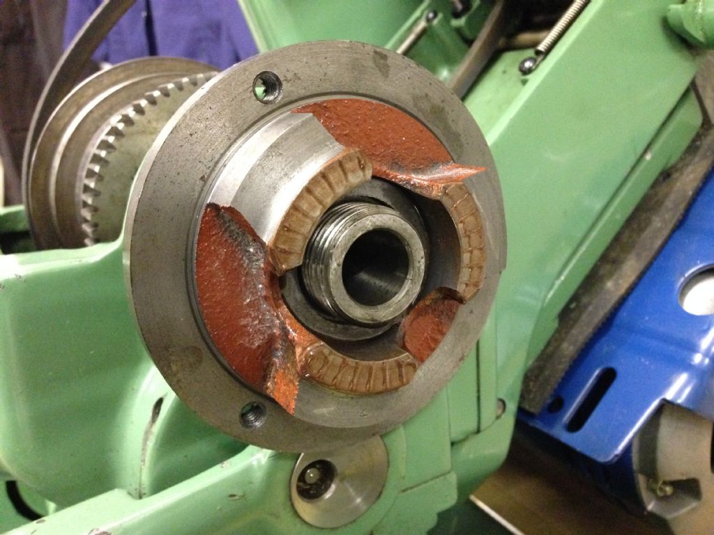

          Two halves of myford integral chuck shown in photos below, with the offending back part placed on lathe spindle in top photo – the threaded part is in the business end of the chuck in bottom photo.
          There is about 20 thou clearance between the spigot on the back part of chuck and the rotating scroll, so should be ok to skim 3 thou of the bolting flange (might also have to check the spigot clearance from the front of the chuck also)!
          If I can get to 3 thou run-out I will be delighted! (better than current 9 thou TIR).
          Journeyman, thanks for brilliant suggestion to use some stout tube and threaded rod through the spindle – that would make for a very quick job.

            Now I understand. I think Journeyman has the right approach, a good thick walled tube should pull that down tight enough for a light facing cut.
            Castings do move, generally they are left to age after rough machining for that sort of movement to take place and then finish machined, but perhaps in your case that wasn't enough
            Good luck, I'm sure it will be greatly improved after this work

              Odd way to make a chuck I can only think they did it like that to make the chuck as short as possible and get it nearer to the spindle. Looks easy enough to take a really fine cut off the face just make sure everything is really clean before bolting up.
