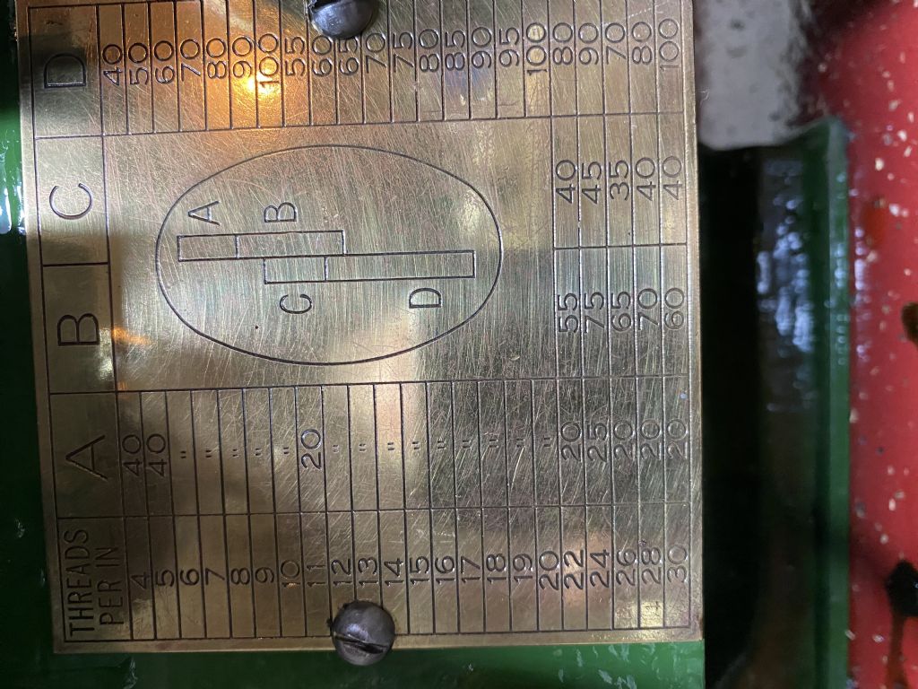

      I would like to buy some change wheels for the Mellor lathe that I am attempting to restore. As the Mellor lathe seems to be fairly rare, they are not immediately available, so, as a last resort I could make them but I wondered if anyone knew if there is another lathe with the same tooth form of 16D.P.

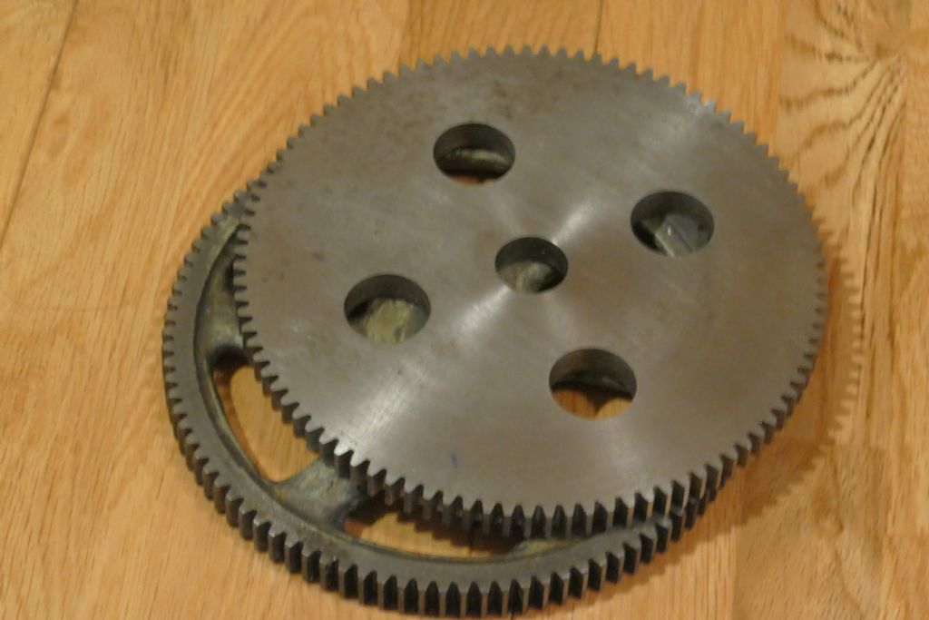

                  Smart and Brown also use 16DP gears. Here is an original with one I made, 95 teeth.

                        Which gears do you already have? For an 8tpi leadscrew the 'best' set is 11 wheels in steps of 5 teeth from 30 to 65 plus 2×20 and 38 (to do 19tpi BSP only) plus a couple more to get you metric. However some lathes used steps of 3 and all sorts of odd ones which are not so elegant.
                        You could look at which threads you are actually likely to cut and just get the ones for that. Also they don't need to be particularly strong or precise (unless you are cutting a new leadscrew) so you can get away with plastic, thin aluminium and even hand file the teeth.
                        Perhaps not big enough to span the gap but it might be easier to get a mini-lathe set as they are the most common.

                          As you can see there seems to be quite a number needed as I only have 4 or 5.
                          maybe my best option is to buy a sheet of 8mm aluminium and make them.

                                Ah, looks looks you have a 4tpi leadscrew. I suggest you see whether you can modify the banjo or add an outrigger to enable 6 wheel trains. Then use a 2:1 starter pair eg 20 & 40 to make everything more 'standard' so you don't need the high count wheels.
