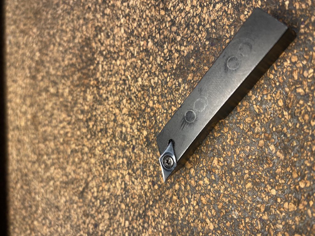

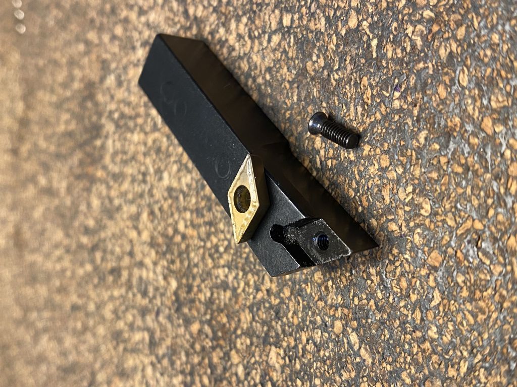

                              Sorry, took a while to go through and digest all that information. What I’ve gathered this far is as folllows:
                              1. Corner radius is important and should be 0.2mm ideally as opposed to the insert I have which is 0.4mm.
                              2. It should be a ground insert not a moulded one and that means it’s a lot sharper.
                              3. The type of the insert should be one that is capable of cutting titanium!
                              4. HSS do the job too, but are going to get worn down quicker.
                              I always have the fire extinguisher handy anyway and I didn’t realise titanium reacts to heat like steel with the colours!
                              So I’m going to try with a DCGT 070202 insert, If I needed to get another holder would it be specific to this type of insert?
                              Couple pictures of the holder below, can’t see any numbers on it anywhere. The holder is just over 9.5mm high too.
                              #613425
                                If you do need a new holder then it will take any DC** 07 02## insert so it could also tale 0.4mm and 0.8mm tip radius inserts of the same overalls size and shape with the 7degree ( code C ) clearance angle. It will take the DCMT 0702## inserts too but I think you will find the DCGT will work a lot better on all materials on the smaller machine.
                                You could also go down to a 6 or 8mm square holder but not upto a 10mm which I think wlll put the cutting edge too high on the Sherline
