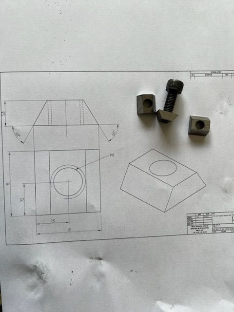

          Ian Parkin
            @ianparkin39383
            If you send me a diagram/drawing of what you need jelly ill knock you some out in the morning for you to collect..
            Ian …nether edge
            #637569
            Jelly
              @jelly
              Ian, You're a very kind bloke (who now has a private message with some drawings)!

                  Ian Parkin
                    @ianparkin39383

                        A big thankyou to Ian who has made this much easier than anticipated.

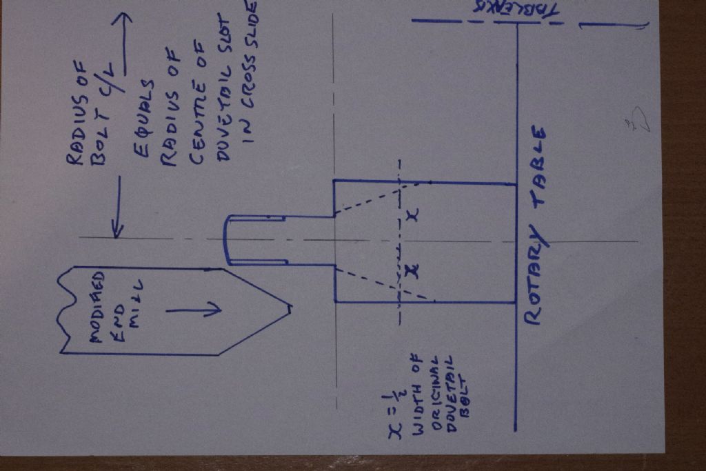

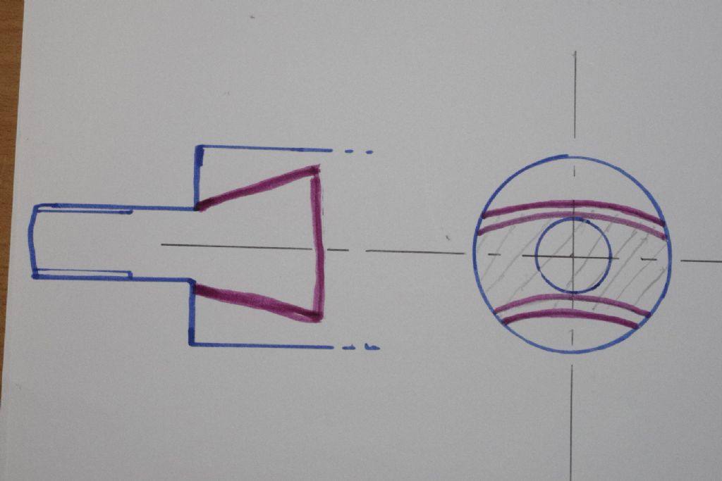

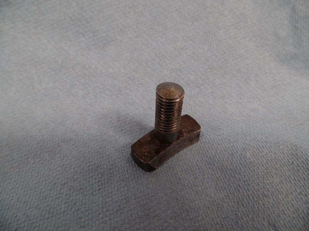

                          _igp2528.jpg_igp2524.jpgsam_0801.jpgI made four for the museum's Smart & Brown model A, to replace the original two. This was because the cross slide was cracked and doubling up the dovetail bolts allowed them to work without tightening so much.
                          The problem with these bolts is they would not be strong enough if made from nuts, they have to be one piece. Also, the dovetail is curved, so the inside radius is smaller than the outside. This is how I made them, the picture is of one of the originals.
