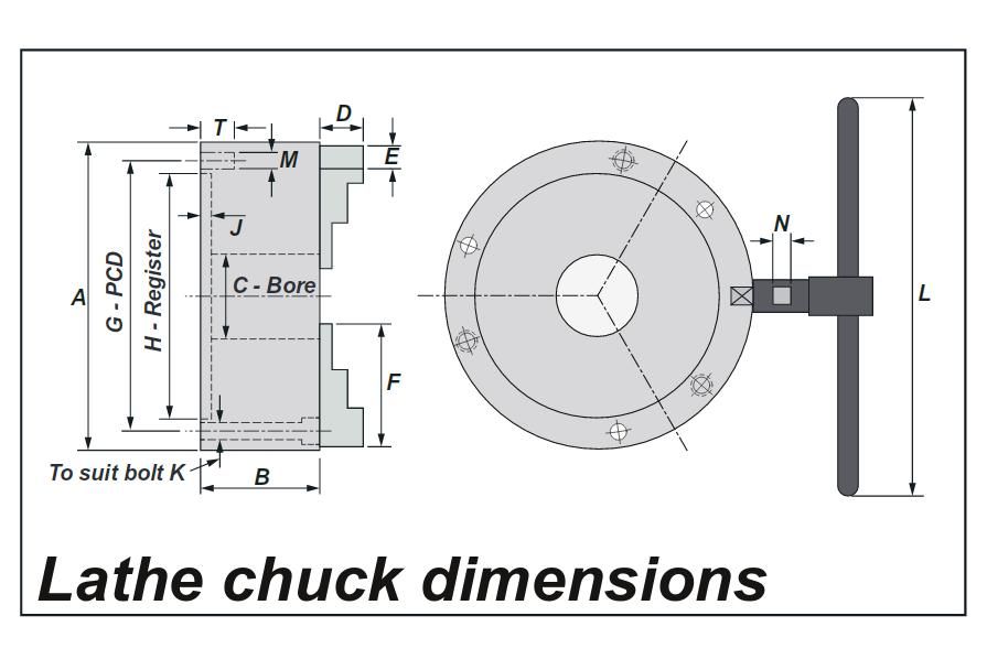

              Where A to N come from this diagram:
              What you need is a chuck-backplate match between both G (distance from centre of the bolt holes), and H the diameter of the register indent). If H is correct, the chuck will centre automatically: if G is correct the bolts will line up with the holes.
              Neil's backplate may be the answer In the event you can't find a match.

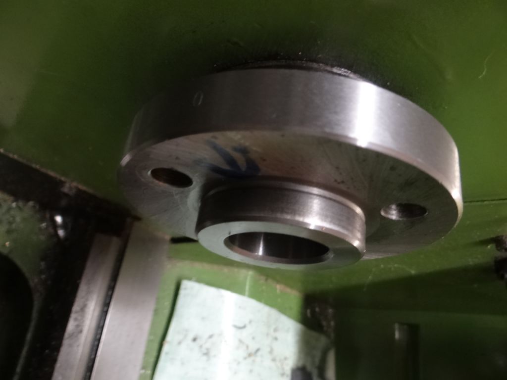

                        Hi Christine,
                        8 tpi is a pitch of 3.175mm (ie the gap between complete turn of the thread.
                        Your figure of 12.07mm over 4 turns gives 3.02mm per complete turn. This might be 8tpi, but you should take several measurements and average them to confirm it. (I'd have been much happier to see 12.7 on your caliper!) If you got the first measurement right, it could be a metric thread, but not the one in the manual. Arghh!
                        Are you able to post a picture of the front of your backplate, ie the side normally hidden by the chuck? Some measurements of that will enable you to have a sensible conversation with Arc just as Naughtyboy suggests.
                        If we can get the backplate dimensions right and find a matching chuck, it won't be necessary to do any machining, or to suss out the thread.

                                  Hi Christine,
                                  Had to go out and collect daughters car from MOT – it passed!
                                  Looks like we may be homing in thanks to naughtyboy. The step he refers to is the register, where the male part on the backplate plugs into the socket on the chuck
                                  On my lathe there's a backplate between the lathe and the spindle. On my old mini-lathe the chuck mounted straight on to the spindle. The socket on the back of the lathe can be quite wide and shallow, like this example:
                                  On your 3 jaw chuck what's the measurement equivalent to the 95mm diameter above? Fingers crossed it's 72mm in which case 040-040-00600 is the one!

                                  Christine Walker
                                    @christinewalker32747
                                    Hi Dave
                                    Glad the car passed the MOT! The measurement you speak of was 72mm yes. I had to remove the chuck from the backplate and measure this exact part for Arc to decide which chuck was required
