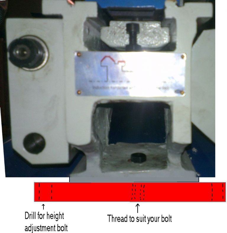

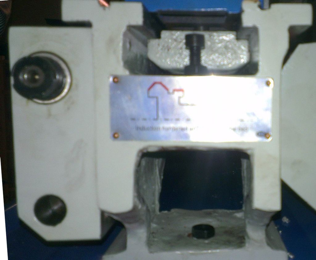

                            Geir
                              @geir
                              Jason:
                              Your advice helped fix the lead-screw play – the nut was completely loose.yes
                              Harold:
                              Thanks for the helping clear this up – 0.002mm is probably good advice when making cylidrical squares. I was thinking of attempting to make some, but I can see that this may have to wait a little. The lathe is mounted on a wooden bench and inducing a twist will, as you mention in your article, require something substantial to push against. The squares will have to wait for a new bench/frame.
                              Is twisting the bed always a good fix for minor alignment errors? The chinese lathe I have is fixed to the bench using three screws that run centrally to the bed. One at the tail (as depicted), and two at the head-stock. Inducing a twist will involve shimming on either left or right side of the screw. The "box" structure of the bed frame will probably be quite resilient to twisting without applying considerable force, and I wonder how effective shimming will be? It may be that actually re-aligning the head-stock, as per Andys comments, is the most viable option?
                              Regards,
                              Geir
                              #112401
                              Thor 🇳🇴
                                @thor
                                Hi Geir,
                                I have taken the liberty of using your photo and edit it a bit, hope that is OK.
                                Underneath the lathe you bolt pieces of flat steel – say 12 to 15mm thick (red in pic.) and drill holes at front and rear end for height adjustment bolts. Harold Hall has description of how this is done on Myford lathes. As you say a sturdy bench is required. The adjustment of the bed (twisting) you need to make will probably be very small.
                                Regards
                                Thor
