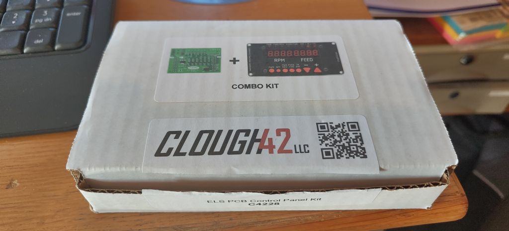

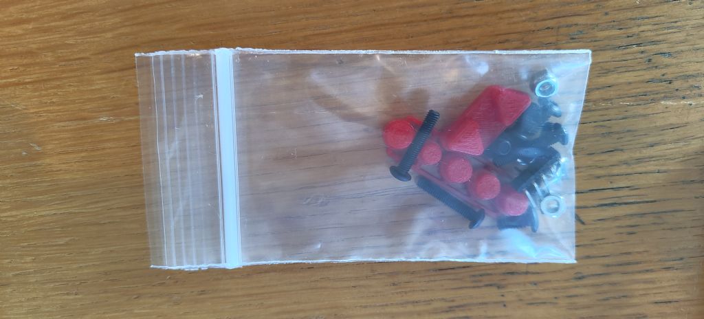

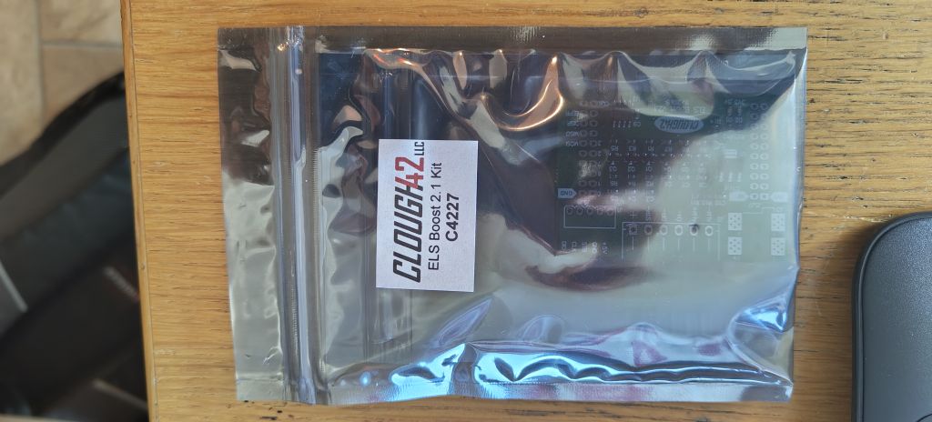

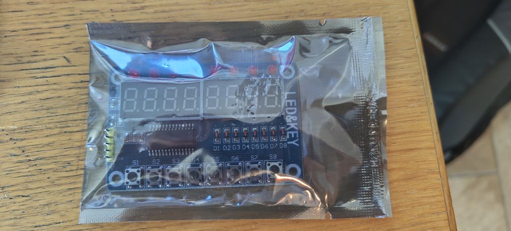

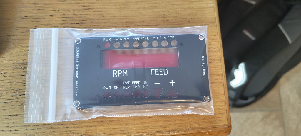

      I bought one of the Clough42 "C4228 ELS PCB Control Panel Combo Kit"s in a fit of enthusiasm having seen his videos, but it is increasingly clear that I won't ever get around to building anything with the bits. The display and the interface board are both in their original unopened antistatic bags. Seems a bit of a waste for them to gather dust, so if anyone fancies having a go, an electronic £25 note secures – contact me via the forum's messaging system.
      The kit consists of:
      Box it came in
      Display/keyboard unit
      Cutouts for the display
      Buttons & hardware
      C4227 board

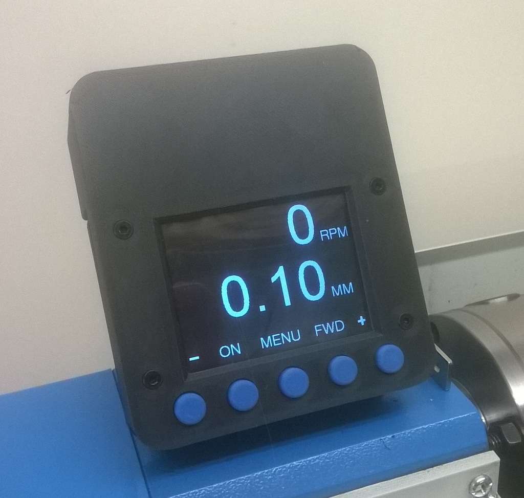

                                                  Having had a look at the electronicleadscrew.eu website mentioned by John H I was impressed by the product. It seems well thought out and easy to use. I’ve just ordered a single axis unit with encoder for €136 (£115).
                                                  It’s a built, cased unit not a kit.  It’s not a “plug-n-play” solution, you have to add a stepper motor, driver and mountings / gears to suit your lathe. However the user interface and coode looks pretty good.
                                                  As SoD says this can be a sensible approach. I could design and build my own from scratch or even use a AC servo drive and motor I have “in-stock” This has built-in functionality to “follow” an encoder with a user defined “gear” ratio but you still have to do the math or write a user interface.
                                                  I have too many projecs already without starting another one that needs software written.
                                                  Having semi-automatic thread cutting, including metric on my 1940’s ML7 (imperial obviously) will be a big boost.
                                                  Need to select a stepper motor and driver. I have two or three Vexta 5 phase steppers and drivers in stock that look like they will do the job.
                                                  I’ll post updates….

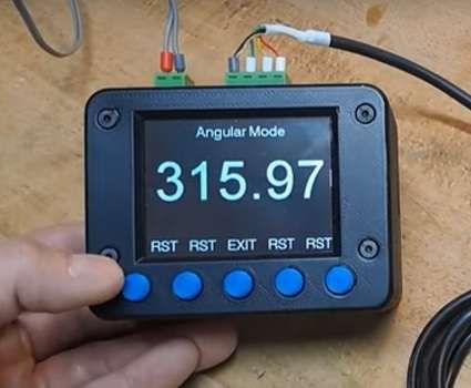

                                                    John Hinkley
                                                      @johnhinkley26699
                                                      Robert,
                                                      The single-axis unit, as supplied, has the connectors issuing from the top of the display, which in my opinion spoils the aesthetics. This is what it looks like unmodified:
                                                      display as supplied  As supplied
                                                      To improve matters, I redesigned the front cover so that the wires are, at least partially, hidden.
                                                      Revised front panel  Modified front
                                                      The STP file for 3D printing is available on Thingiverse, along with the other files for the installation of encoder and stepper motor etc, suitable for a 7 x 14 mini lathe, here:  Link to Thingiverse files
                                                      I should add that when I removed the original front, one of the brass threaded inserts wasn’t gripped by the plastic.
                                                      I have corresponded with the vendor, and he has approved the design and although not endorsed it has said that it is OK to publish it on Thingiverse.
