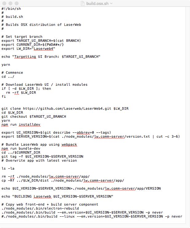

      The download includes this [presumably helpful] text file:
      … Could some kind soul please walk me through this ^^^
      … Presumably it is a script for me to enter in Terminal

          What you have there is a "shell" script which is run from the command line in a terminal window. The "shell" is a program that processes the commands, two of the more popular shells are bash and zsh. It looks as if this particular script is used to build the application so unless you intend rebuilding it, is probably not really useful to you.
          If you were a DOS user you may remember BAT files which ran a series of commands at the command line, a shell script is similar but vastly more powerful.
          Comments in a shell script start with # so all text in your script that follows a # is ignored by the shell it is only there for the user's edification, all that is except for the first line:
          #!/bin/sh which by convention indicate which application is used to execute the script, in this case /bin/sh (which is probably a link to the actual program),
          The first thing your script does is set a few environment variables:
          export SOMETHING=SOMETHING_ELSE
          The content of an environment variable is retrieved by means of the $ symbol. So: for example using the "echo" command that displays text in the terminal e.g:
          export XYZ=Hello
          echo "The XYZ variable contains $XYZ"
          would display
          The XYZ variable contains Hello
          That only just really touched the surface, if you are interested in learning more about shell scripts Google turned up some promising links when I searched for: introduction to shell script programming

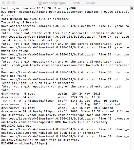

                      Then … I had to download the 'Command Line Developer Tools'
                      And finally … It failed crying 2
                      Looks like I will be sticking with -130 until the author provides a dmg
                      … But at least I have learned something; so thanks again

                        Hi Michael,
                        I took a quick look at the errors above and if you still want to have a go at building this then try the following:
                        1 – I think you are launching the script from the wrong place. The script expects to be run from the directory where it is located.
                        cd Downloads/LaserWeb4-Binaries-4.0.996-134
                        ./build.osx.sh
                        2 – The script can't find the yarn command – you probably need to download it from somewhere
                        3 – The same with npm.
                        Keith

                            yarn and npm are both package managers – used to download, install, and remove software.
                            yarn is available from here. But try typing 'brew install yarn' at the command line. (brew is another package manager)
                            npm is the Javascript package manager, and comes with node: Try typing 'brew install node'
                            If they install, re-run build.sh Good spot from Keith about it expecting to run in the directory in which it's located.

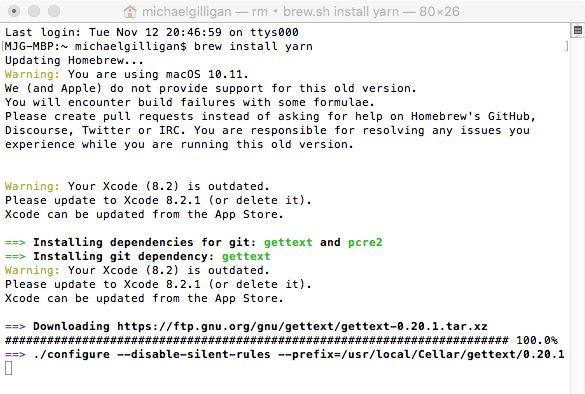

                            #437042
                              Many thanks for the help, Clive, Keith & Dave
                              I started along the brew / yarn / nam trail … but chickened-out when I got this far:
                              It's finally time to accept that we are obsolete sad
