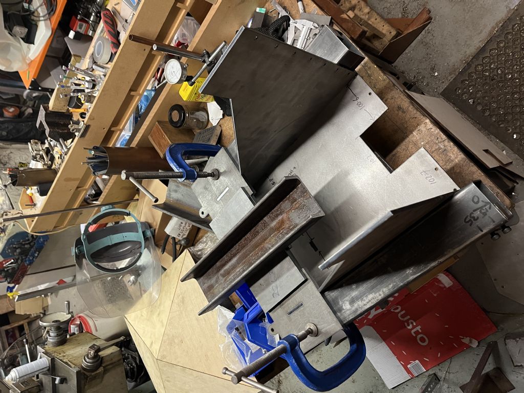

      I’m making progress on my CNC build, and I now need to find someone to cut some 5 or 6 mm steel plates for various bits of the structure.
      Any recommendations?

                                #637821
                                Dave S
                                  @daves59043
                                  Just to update this. I used microkerf after getting a few quotes.
                                  Ordered back end of last week and the parts turned up today.
                                  very happy, they all fit as designed.
