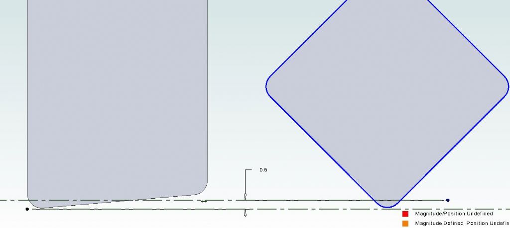

                    If you look at this sketch comparing a square insert set at 45deg and a APKT type insert you can see that when taking a 0.5-0.75mm DOC (20-30thou) the radius on the APKT is not a lot different to the angle being cut by the square insert. You would really only notice the difference if you were able to take say a 3mm DOC where for the same feed rate the square insert at 45deg takes a longer but actually thinner cut than if it were vertical.
                    As Andrew says the ability to cut up to or form a vertical edge is a big advantage
