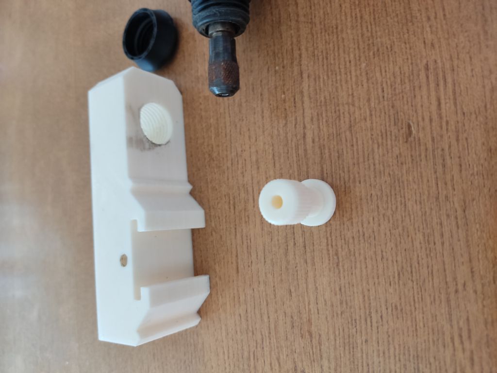

        My "solution" for a Dremel mount is a work-in-progress & it won't be as "high tech" as Hopper's :
        A 3D printed adapter to suit a Dickson toolpost – the photo has come in sideways, but it doesn't really matter.
        The formation to mate with the toolpost fits very nicely & with 6 perimeters the print is solid enough to resist similar clamping lever forces to a steel holder. The printed M5 threads in the body & height adjuster required a tap running though them to remove a very small amount of plastic to get a screw to fit snugly. The thread for the Dremel needs work – the example above is M18x2, which is the nearest to the M19x2 or 1/2" x 12 thread usually quoted for the Dremel nose from the "standard" threads in FreeCad. I used this with the idea of opening up the thread with a tap (1/2" x 12 BSF, as M19 x 2 taps are pricey ! ), but will re-visit this aspect on the "Threads workbench" to try to define a custom thread that fits the tool without need for a tap.
        Unfortunately my PC was stuffed by a failed Windows update on Saturday (thanks Microsoft ! ) & the 3D model was one of the files that the repairer hasn't saved (the nature of the failed restart after the update required specialst help – a unfortunate first for me & I wasn't up to date with backing up ), so will have to start the project again from scratch. Should go easier this time (until I get to the custom threading bit anyway) but I do need the practice with FreeCad !
