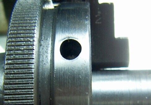

      The OEM 3-jaw chuck that came with my ca. 1980 Unimat 3 does not seem to be in good shape.
      Granted, it is 43 years old and it may have been subjected to some abuse, no way of knowing just how much.

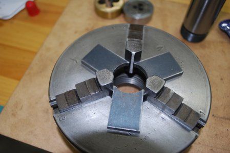

      While attempting to diagnose the source of chatter I could not find, I noticed this:
      A so-so photographer and a a so-so camera makes it look worse than it is but there is a good amount of axial play there, probably one of the sources of the chatter I often (too) get as well as deviations when drilling a small diameter length wise hole with a drill bit.

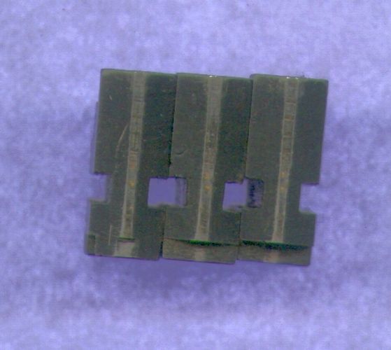

      I then disassembled it to see what I could find inside and put the pieces on my scanner's bed (!) to get accurate images of each one's critical surfaces.
      These are those images:

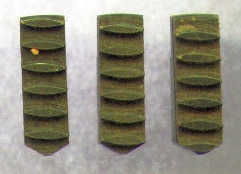

      1. Jaw surfaces do not look too good.
      I probably have some responsibility for part of this damage as once or twice a large-ish piece flew off the chuck, probably because the jaws were already in bad shape and did not hold it properly.

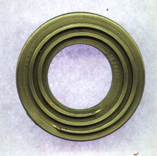

      2. Asides from the scanning software artifacts, the scroll teeth seem to be (?) in decent shape.
      3. The same could be said for the scroll itself.
      To my untrained/unexperienced eye, what looks bad are the jaw surfaces, the rest being in acceptable shape.
      ie: I cannot make out any issues with the scroll or the teeth running on the scroll but you chaps know better.
      As to how to fix this rather expensive problem, all the methods I have seen (on-line) are with the jaws in place and a rotating cylindrical element grinding each jaw as the chuck rotates, with grinding element mounted on a Dremel type tool attached to the tool post.
      ie: jaws ground one at the time and preloading then chuck. This requires some sort of jig to get them tight/with no slack while holding nothing to let the stone do its work.
      It seems that the success of this method is very much dependent on how well  the chuck is set up with whatever is used to preload it.

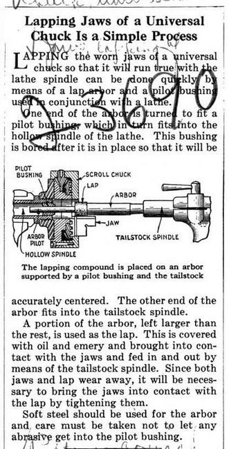

      I have only come across one other method in the January 1924 (p. 86) issue of Popular Science and mentioned in the unimat forum at io.groups:

            > … other method in the January 1924 (p. 86) issue of Popular Science and mentioned in the unimat@io.group:
            Image courtesy books.google.com
            It may be possible to avoid having to use the pilot bushing by fitting the arbor to the size of the Unimat's spindle bore but maybe this method is dependent on proper headstock/tailstock alignment.
            I think have the bed ie: headstock/tailstock reasonably well aligned.
            After a couple of surface passes on a steel rod mounted between centers, I get a 0.05mm deviation when I run a comparator dial from point 'A' to point 'B' 125mm away.
            Is it good enough?
            I'd appreciate comments on how to fix this chuck problem and which method would be most suitable.

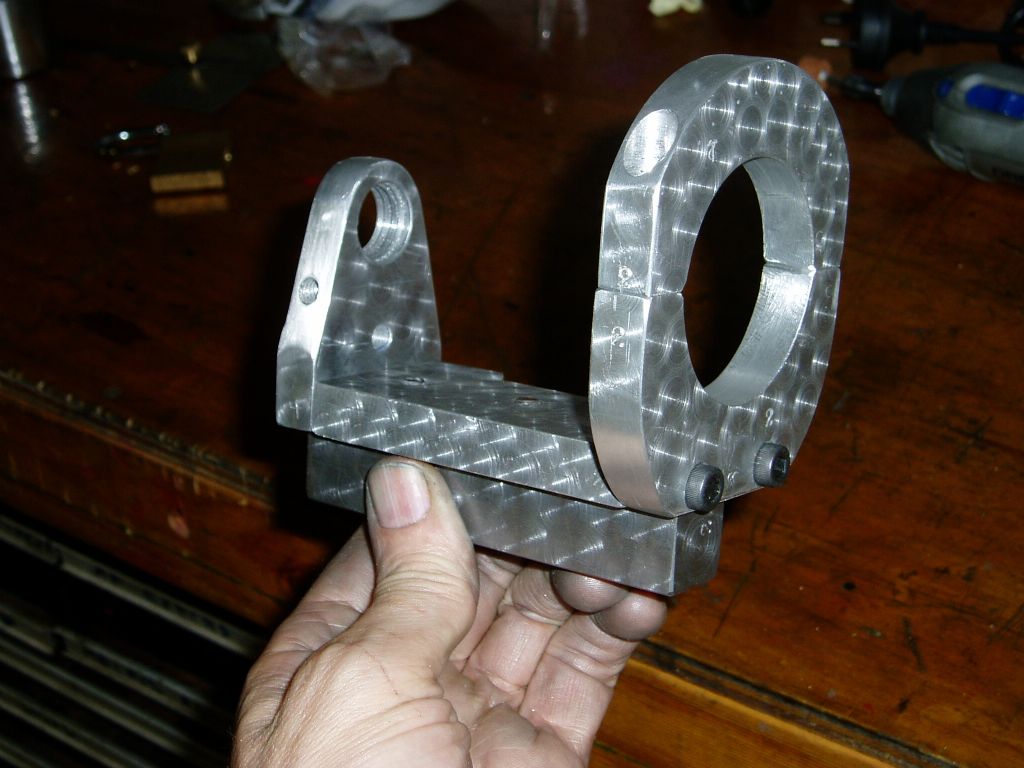

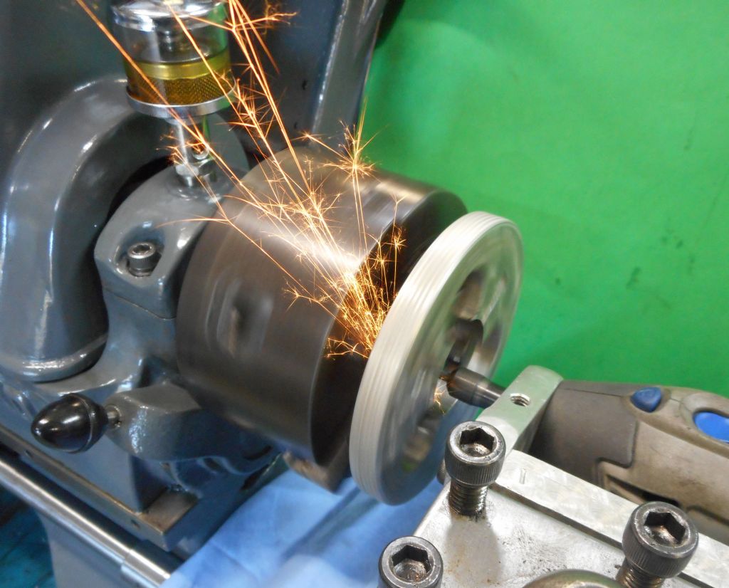

                That looks really bad. You won't fix that much wear by lapping. Lapping is only to remove tiny amouts of metal, like. .001". Even grinding it would be difficult. Can you stick a feeler gauge in there and measure how much wear there is? It may be the chuck body is distorted. In which case a new chuck is the best solution.
                Otherwise you could try grinding it with a Dremel tool mounted in the toolpost. With a suitable clover leaf plate to push the jaws outwards at the far end while grinding.

                        Efficient enough to totally eliminate your bellmouthing and get your chuck running true within .002", in my experience.
                        You can achieve the same effect as the cloverleaf plate by inserting three pieces of flat bar between the jaws. A hacksaw cut halfway down each piece gives it some spring.
                        Your bellmouthing will not be caused by the scroll plate or the teeth on the jaws. It will be jaw wear, jaw distortion or chuck body distortion.

                                    Putting a ring around the outside steps at the outer end of the jaws then tightening the jaws outwards against it has the effect of pushing the ends of the jaws inwards, meaning when you grind them, you end up grinding more metal off the end of the jaws where the bellmouthing is the worst — the exact opposite of what needs doing.
                                    The clover leaf ring — or the three strips of flat bar — restrains those outer jaw ends as you tighten the jaws inwards against it, duplicating the forces in play when gripping a job in the chuck. The bellmouthed outer ends of the jaws are pushed outwards, so the metal removed by grinding is in the smaller diameter area up inside the chuck body. You end up with nice parallel jaws that way.

                                            I am thinking of getting a nut to turn and insert on a laser cut piece to make the Dremel holder but am having difficulty getting the thread spec right.
                                            My Dremels are rather vintage, the best one is a 150W US made Moto Tool "Model 328 Series 1 07" and the other one is newer albeit much lesser quality 125W "Model 395" made/assembled in Mexico.
                                            FWIW, all the US made 395s I have come across seem to suffer from the same quality issues this one had. eg: rotor blowing out after eight months use, speed selector breaking down after a couple of month's use, plastics and rubber coverings deteriorated in a year's time, etc.
                                            I can put on an M20x2.5 nut on both of them (at least that's what the hardware chap said it was) but it seems a strange spec for a US made/designed tool.

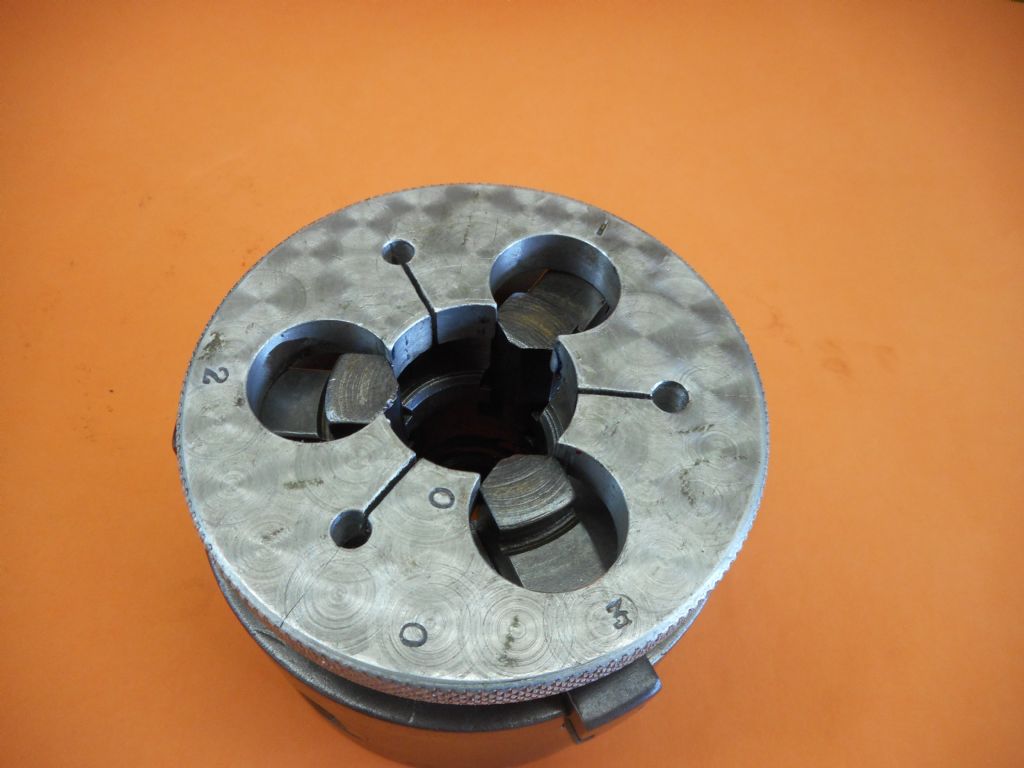

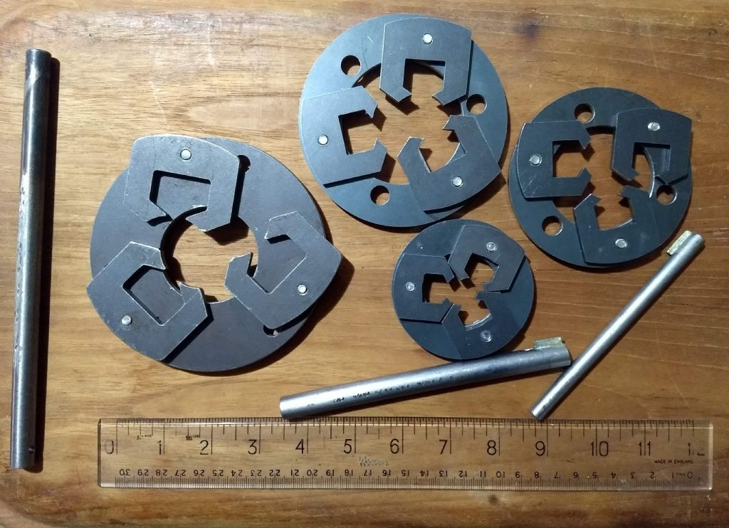

                                              I had this bell-mouth problem on my 6" chuck. A member of my model engineering club had donated a 'kit' he had made for truing 3", 4" and 5" chucks. When I borrowed it I found that, naturally, the 5" kit was too small for my 6" chuck. A swift phone call resulted in a package containing the missing 6" device, which he loaned to me.
                                              Each kit comprises two components: a device to allow the chuck jaws to be partially closed under tension with no backlash, and a diamond lap that is held in the tool post. The lap a small piece of diamond impregnated matrix silver soldered onto a bar rather like a boring bar.
                                              The chuck is closed as far as it will go against the tensioning device and the lap is fitted to the tool post. The lathe is then started and the lap positioned until it is just touching the 'lowest' part of the chuck jaws, when a faint chirping noise is heard. As the lap is slowly withdrawn the chirping is reduced, which is a clear indication the the chuck is bell-mouthed.The cross slide is adjusted and the lap moved left and right until the chirping is constant right along the chuck jaws. It took about 10 minutes to true my 6" chuck. No sign of bell-mouthing now.
                                              Here's a photo of the complete kit of four devices. I didn't notice that the diamond 'flag' wasn't visible in the large lap, but it's just like the two smaller ones, only bigger.

                                                JHM I recall that the thread on my Dremel when I made the holder for it was an odd thread that matched no standard. I ended up just measuring the diameter and the pitch and screwcutting a thread to match it in a piece of aluminium. But I think you could just make the the hole smooth with no thread and put a cut in it and a pinch bolt so you clamp it.

                                                  My toolpost Dremel holder. Bit of a tart's handbag with the jewelled finish but it was a an experiment to try different ways of doing it. I reckon you could just clamp rather than screw the front mount though.

                                                    Hello:
                                                    Posted by Hopper on 18/01/2023 12:48:39:
                                                    … recall that the thread on my Dremel …
                                                    Seems it is an odd thread, but a chap that makes holders says that (most) are either 3/4" x12tpi or 3/4" x16tpi (with some exceptions) so that sort of settles it as it matches what I have measured here with my Dremels.
                                                    But while I was going about all this, I wondered if I could not just chuck a decently made 8 or 10mm stone or diamond grinding bit on the tailstock. I have a brand new ca. 1990 Czeck 8mm chuck I recently (and successfully) bored to M14.
                                                    It would be working right up close to the tips of the jaws so I guess head/tailstock alignment would not (?) be an issue.
                                                    I would then very lightly adjust the jaws till their rear part touched the bit and turn the U3 on at a slow speed.
                                                    Done that, I would move the grinding bit very slowly/gently forward/back with the tailstock screw till I could hear no more grinding.
                                                    After inspection to check exactly what went on, I would again lightly adjust the jaws till their rear part touched the bit and repeat the procedure.
                                                    The job would be finished once the front end of the jaws touched the bit as it was being drawn out.
                                                    Does this make sense/sound feasible to you?
                                                    Thanks in advance.
                                                    Best,
                                                    JHM
                                                    #630021
                                                    Hopper
                                                      @hopper
                                                      You can't adjust the jaws if they are held in place by the clover leaf plate.
                                                      Tailstock has too much overhang and too much slack and is often not overly well aligned with the bed. i would not use that method.
                                                      To work properly a grinding stone needs to be spinning fast. It will not work well held stationary inthe tailstock.
                                                      I have seen other Dremel holders that just clamp around the body. Easy enough to make.
